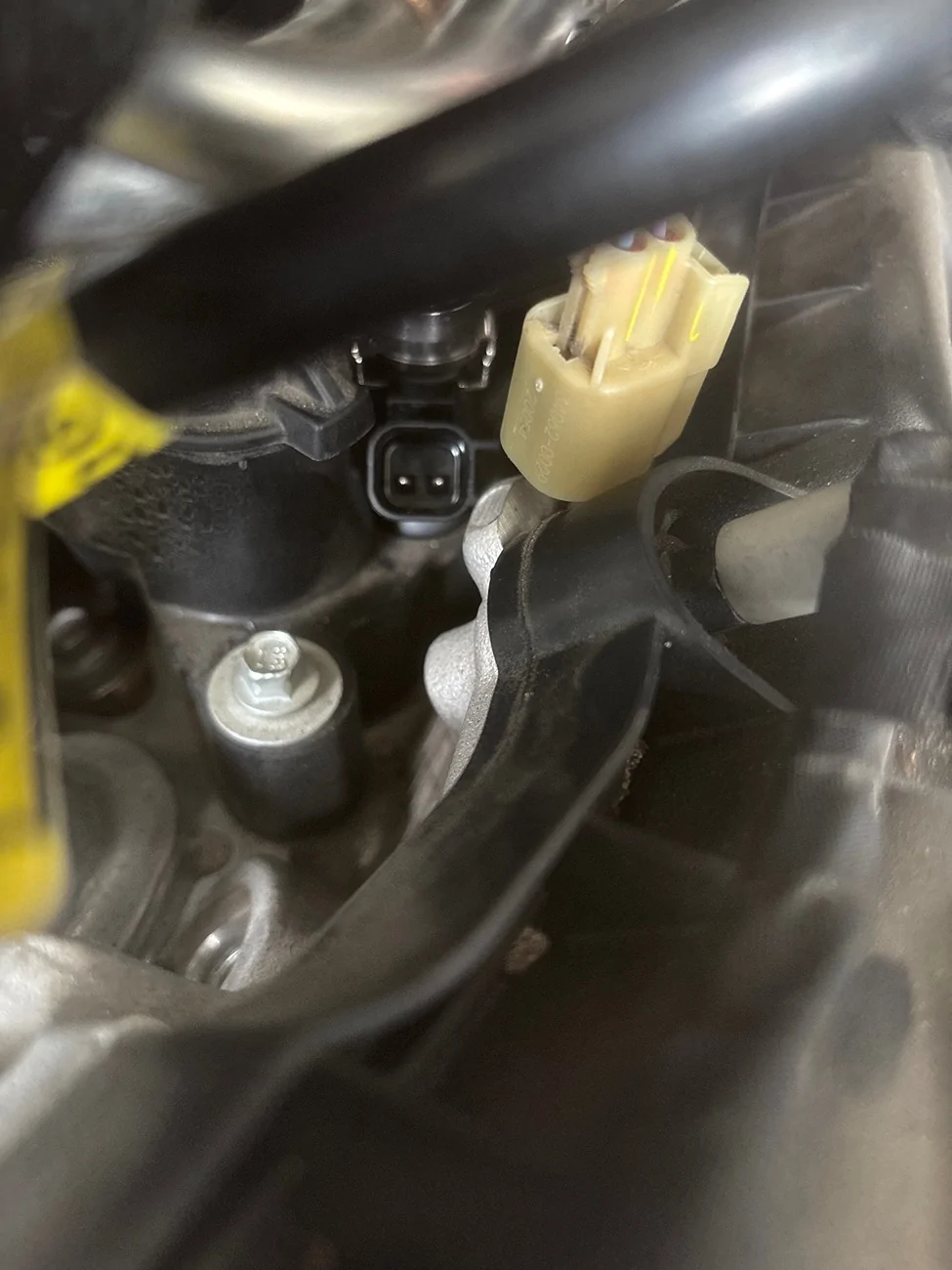

I have a 21 mustang and I’m currently changing the injectors out for ID 1050x. I’m having an issue with the front driver side and rear passenger plug on the injector not having enough room to plug in. Anybody have this issue or know if I have done somthing wrong? All other injectors plugged right in.

I fixed this issue. If anyone else runs into this problem all you have to do is take the rail back off and turn the two conflicting injectors around the other way. I did have to cut the protective tape back little bit on those 2 connectors so it would reach the plug.
