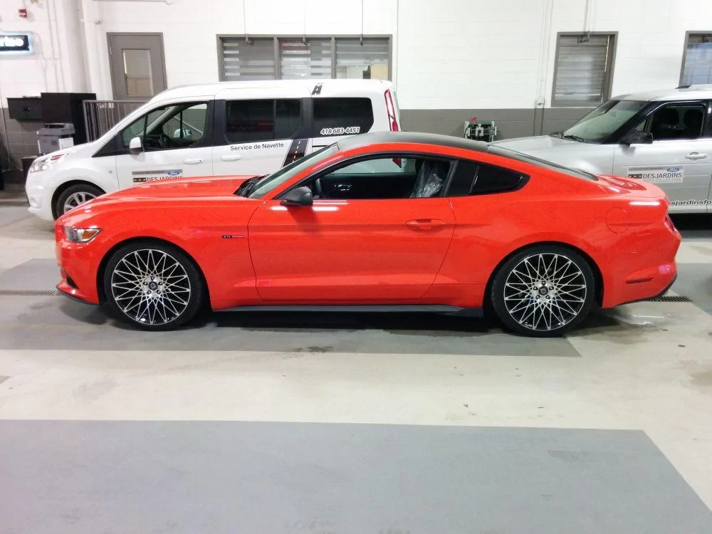

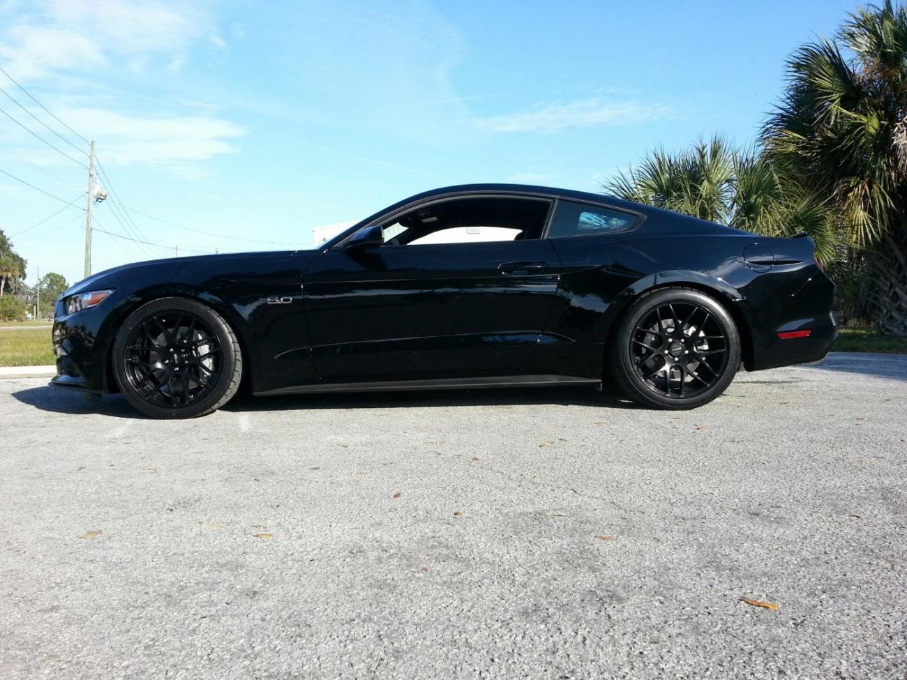

I'm sure you have all noticed how this car sits stock. The rear looks lower then the front. It has a reverse rake. I would rather the opposite, front lower then the back. I installed eibach prokit springs, hoping to fix this. The specs say 1.2 inch drop in the front and 1 inch drop in the rear. Perfect I thought. Nope. The car is lower for sure but still sits the same, front in the air. I went to check out the specs for eibach sportlines. 1.6 inch drop in the front with 1.25 inch in the back. Perfect. But wait... In small print it says 1 inch drop in front and 1.25 inch drop in rear on Ecoboost models. That's not good... All 6g mustangs use the same lowering spring part numbers but don't drop the same... Do our V6s drop like an Ecoboost with only 1 inch drop in the front, even with sportlines? I'm wondering if my prokits are doing the same as the sportlines on ecoboosts. Dropping less in the front. I emailed CJPP about this and they told me they had no measured drops for any springs on V6. So it's a guess whether your car will drop like a GT, like an Ecoboost, or somewhere in between. I was thinking about buying the sportlines and putting on just the springs in the front with my prokits in the back just to be sure of the front dropping more but I see 1 inch front drop specs on the sportlines on ecoboost makes me not sure... I don't want to have to put back oem springs in rear only, leaving my prokits in the front to get the right rake. You need lowering on all four corners to get rid of the fender gap...
