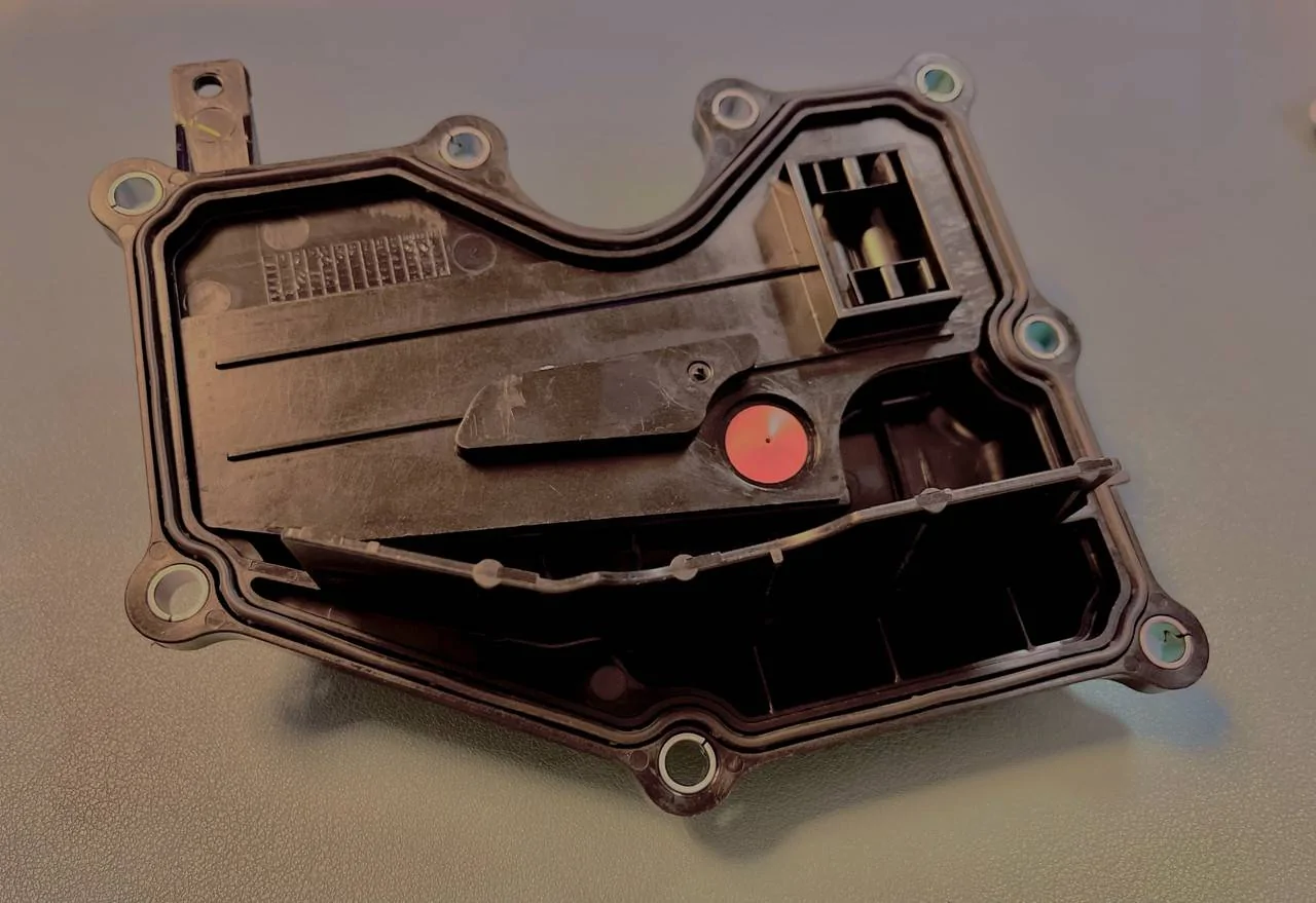

On the PCV baffle what is this orange plate and what does it do???

Not sure, but to me it looks like it may be a check valve of sorts?

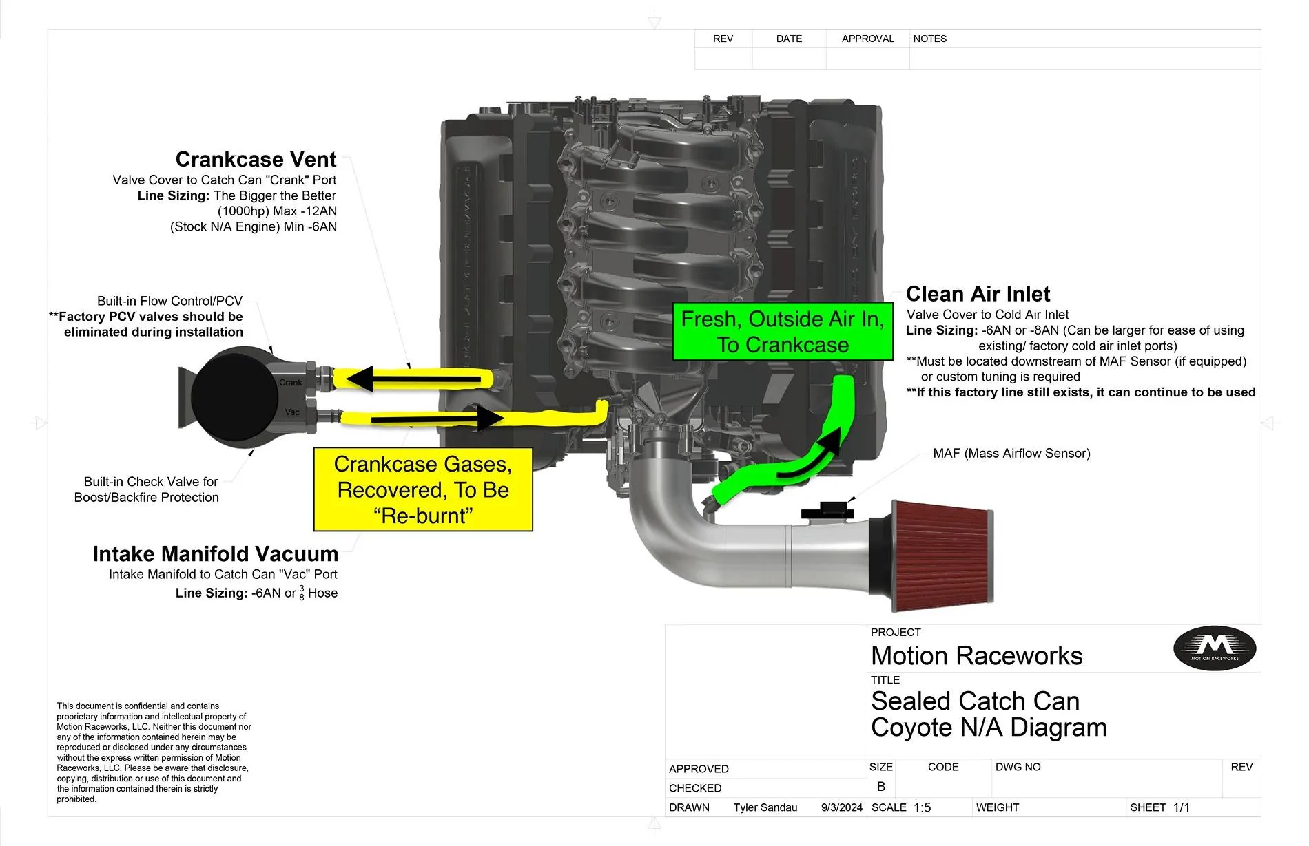

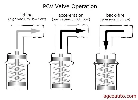

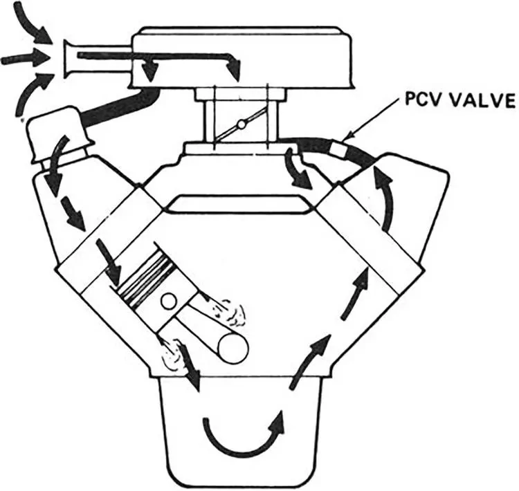

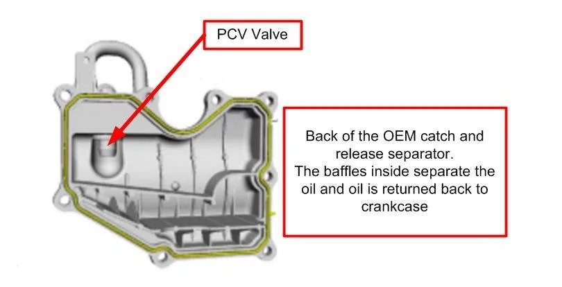

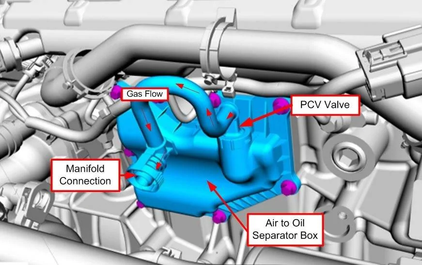

I often immediately save things, and housekeep them later. Attached are several images and one document on PCV systems. The Motion Raceworks image was modified by self.
