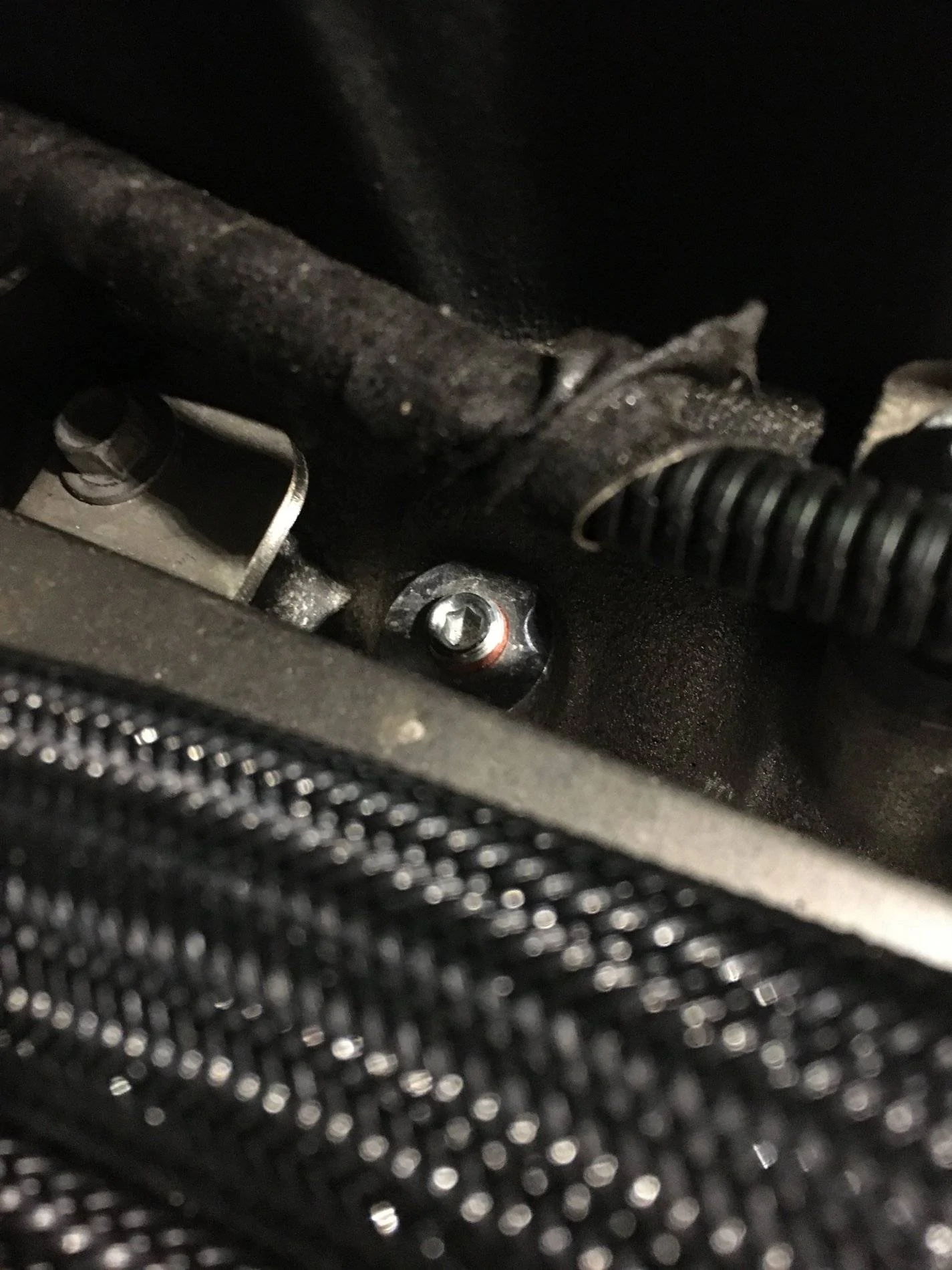

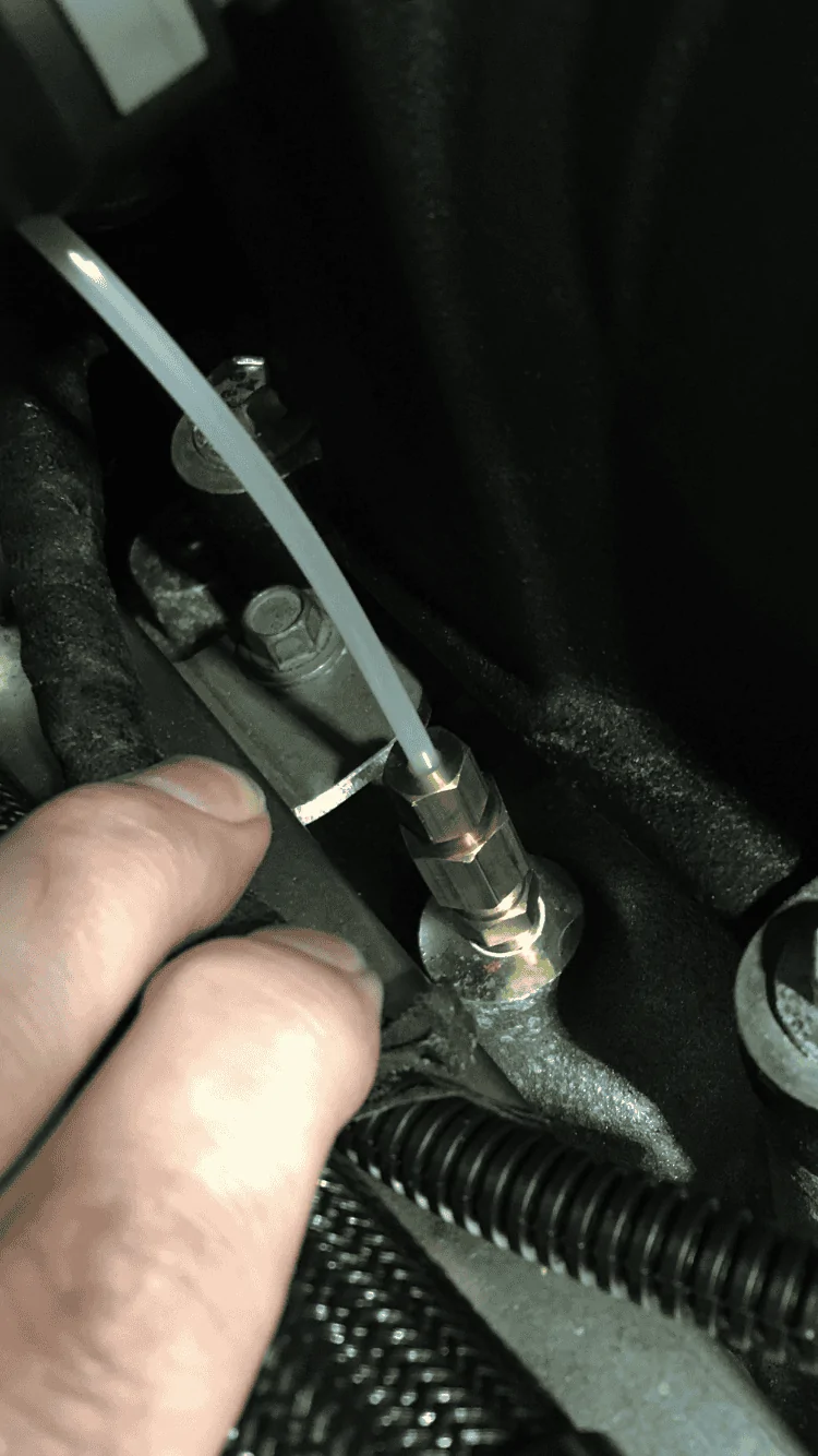

Just did this at 4am this morning. There is two 1/8” NPT plugs on the passenger side of the compressor. Use a adapter to compression fitting on one of them. Easy.

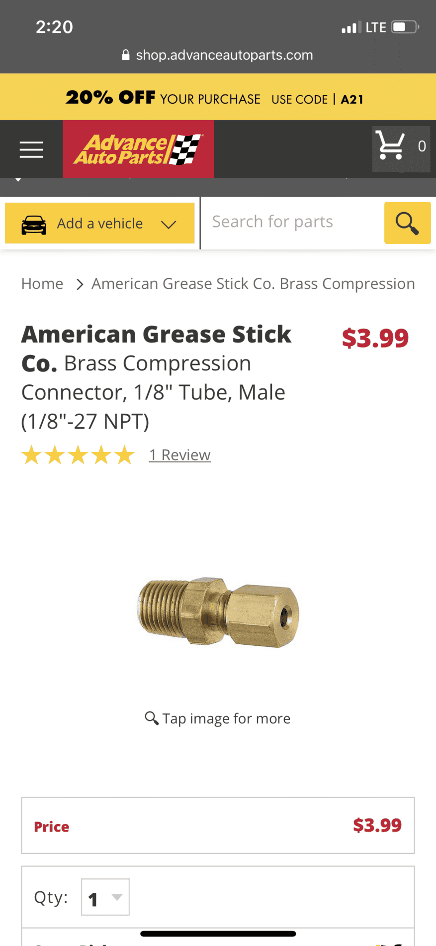

Would something like this work? And then I just run the line through the firewall and hook it up to the gauage?

That’s what I told you I just did.
