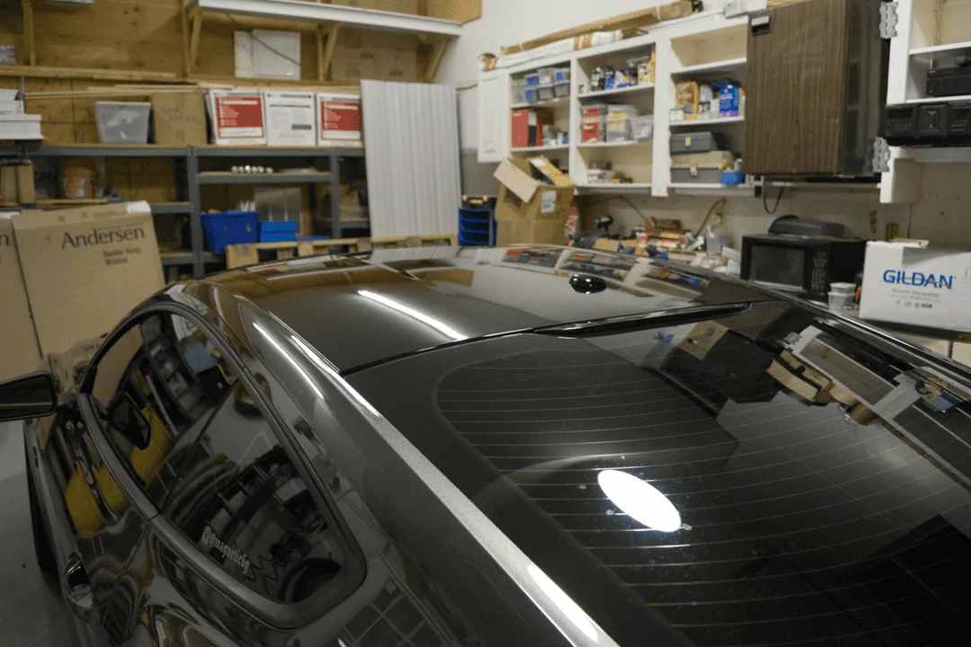

I realize this thread is dated, but find myself in need of pulling my headliner on my 2017 GT 350. I had the roof wrapped gloss black and it looks great with the exception of the Lightning blue antenna cover. My wrap guy told me he does not recommend wrapping the antenna cover as it can cause interference. So I 've already purchased a spare Ford OEM antenna and painted it Absolute black. Just an FYI, the antenna cover is attached to the base via 5 T6 bolts. (so, you aren't going to be removing it unless you remove the antenna first.). Which necessitates removing the headliner. I'm going to try just pulling down (gently) from the rear 1st.
Update: I did remove the antenna last night by just pulling down on the rear of the headliner (two magnets as noted above). Need to pull out the upper rear plastic trim (along rear window) to gain access. Be aware there are airbags under there so might advise disconnecting the battery 1st. Was tedious getting my hands with wrench (10mm) in there but manageable. To re-attach be sure and have the antenna bolt, reinstalled to the antenna, and lower it through the hole in the roof as it's next to impossible to get it properly aligned/secured from the underside of the roof (w/o removing the headliner). Once inserted in roof then you tighten from below. I used new hardware from the new antenna I bought so if you are using the original hardware you may need to bend the original attachment bracket to fit back through the roof as it spreads out when you tighten it.
