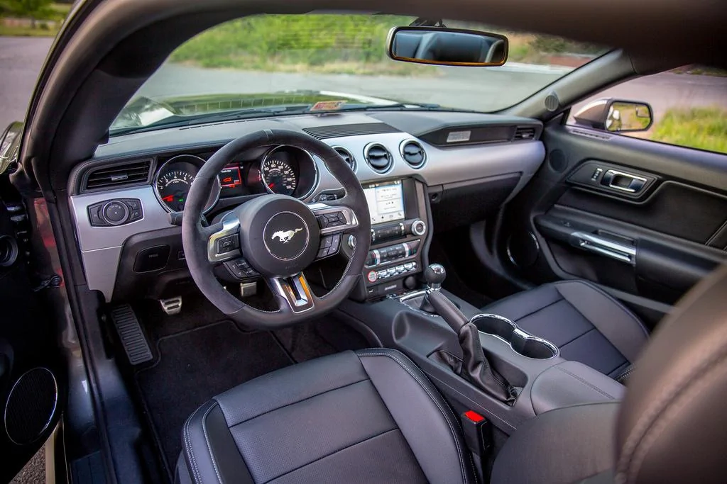

I got mine in! 20 minutes start to finish. This and the clutch spring were the two easiest installs I think I'll ever do!
This wheel is so money and I didn't have to reset anything but the clock :cheers:
