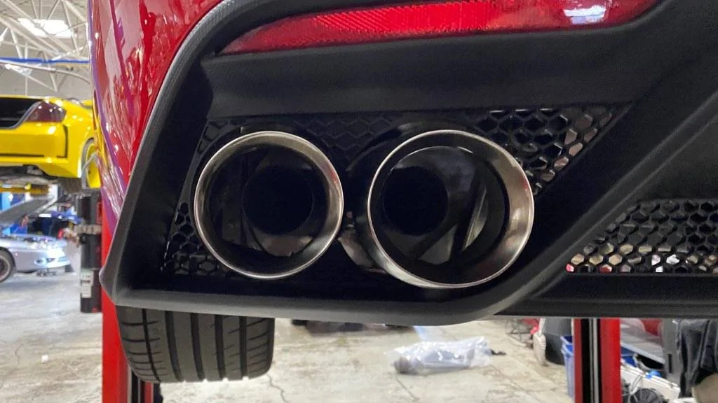

Use any single tip muffler and make a 2 into 1 slip on tip. I have roush axle backs with my gt350 valance.

I made them myself. An exhaust shop should be able to make some. I can give you a quick write up if you have access to a welding machine. A drill press and a 2.5 inch hole saw. You'll also need a metal cutting saw to make good cuts on the piping. You'll need 2.5 inch exhaust piping... 4 pieces of 90 degree bend 2.5 inch radius. I got mine from summit

Wow bro that came out very good!!! Where exactly did you buy the quad tip? Unless you got any you would sell me? Im looking to just cut off the tips from a borla atak and add these quad tips to fit my valance🙏🙏

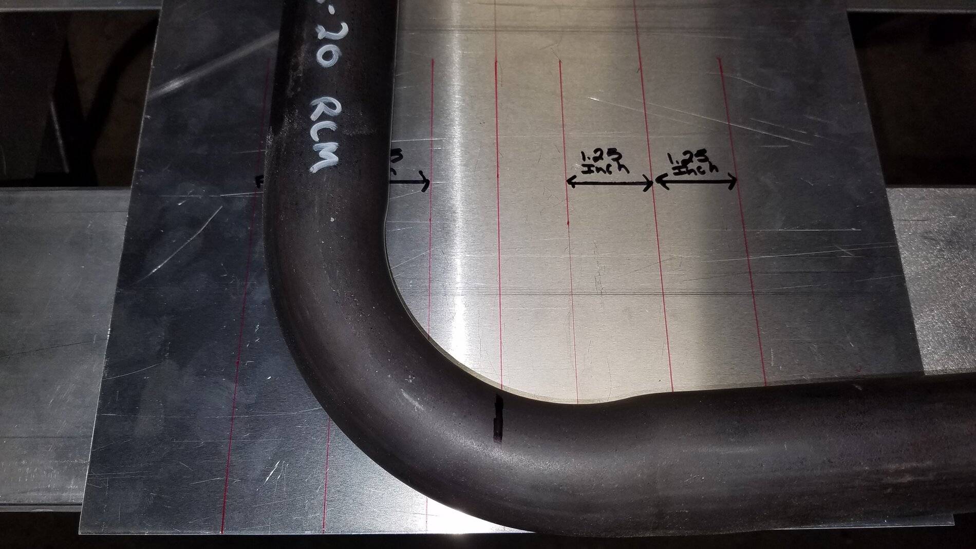

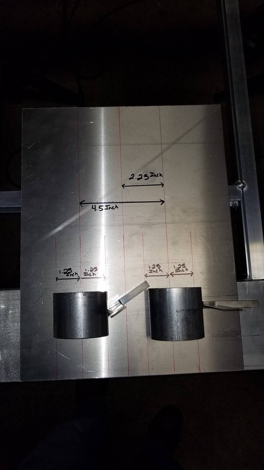

I hope this is able to help you. The tips are 4.5 inches center to center. The 2.25 inch at the top is the center cut line for the 90s. I don't have any 2.5 inch 90s to show you. So I put a small piece of pipe I had laying around to show you how it's cut in the bend.
