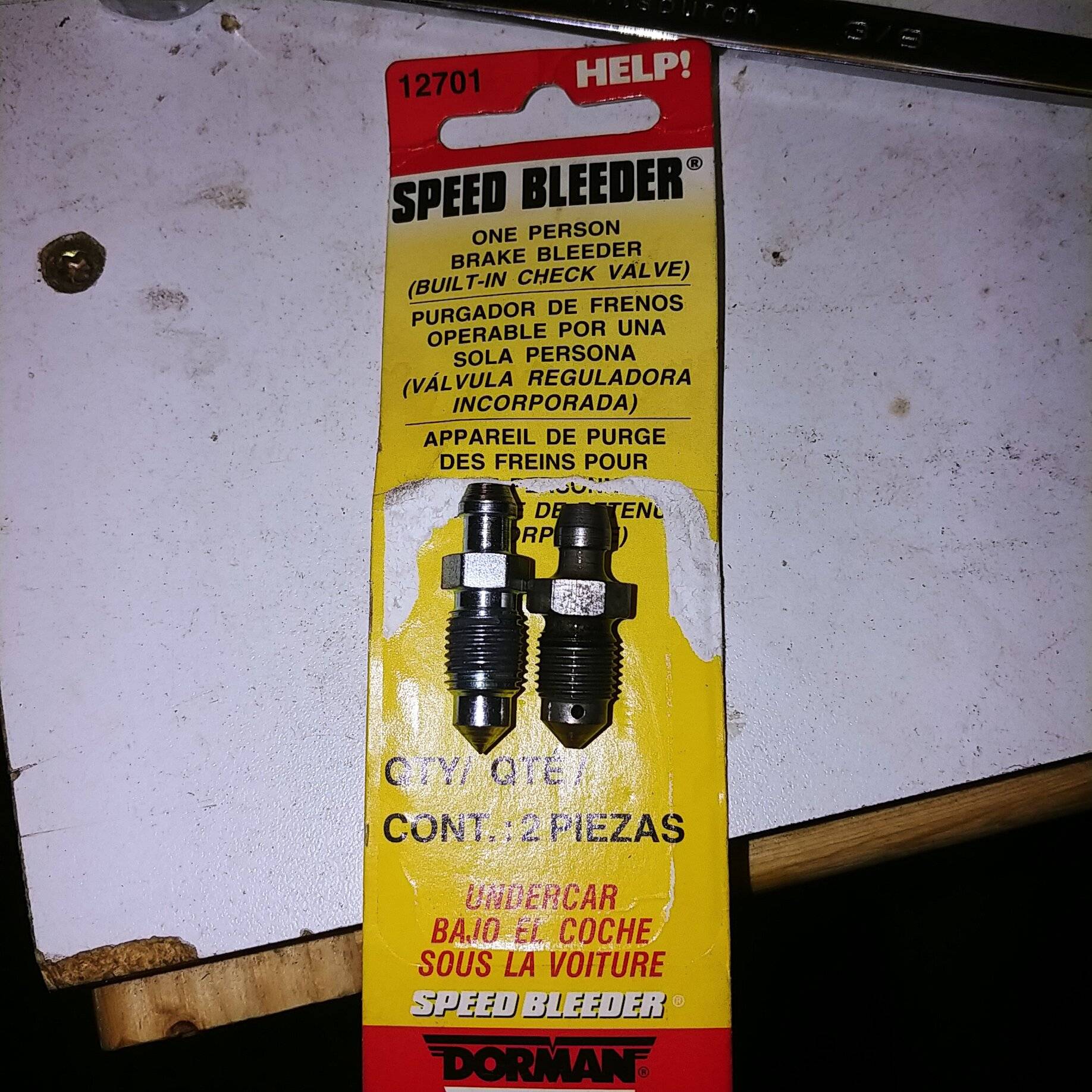

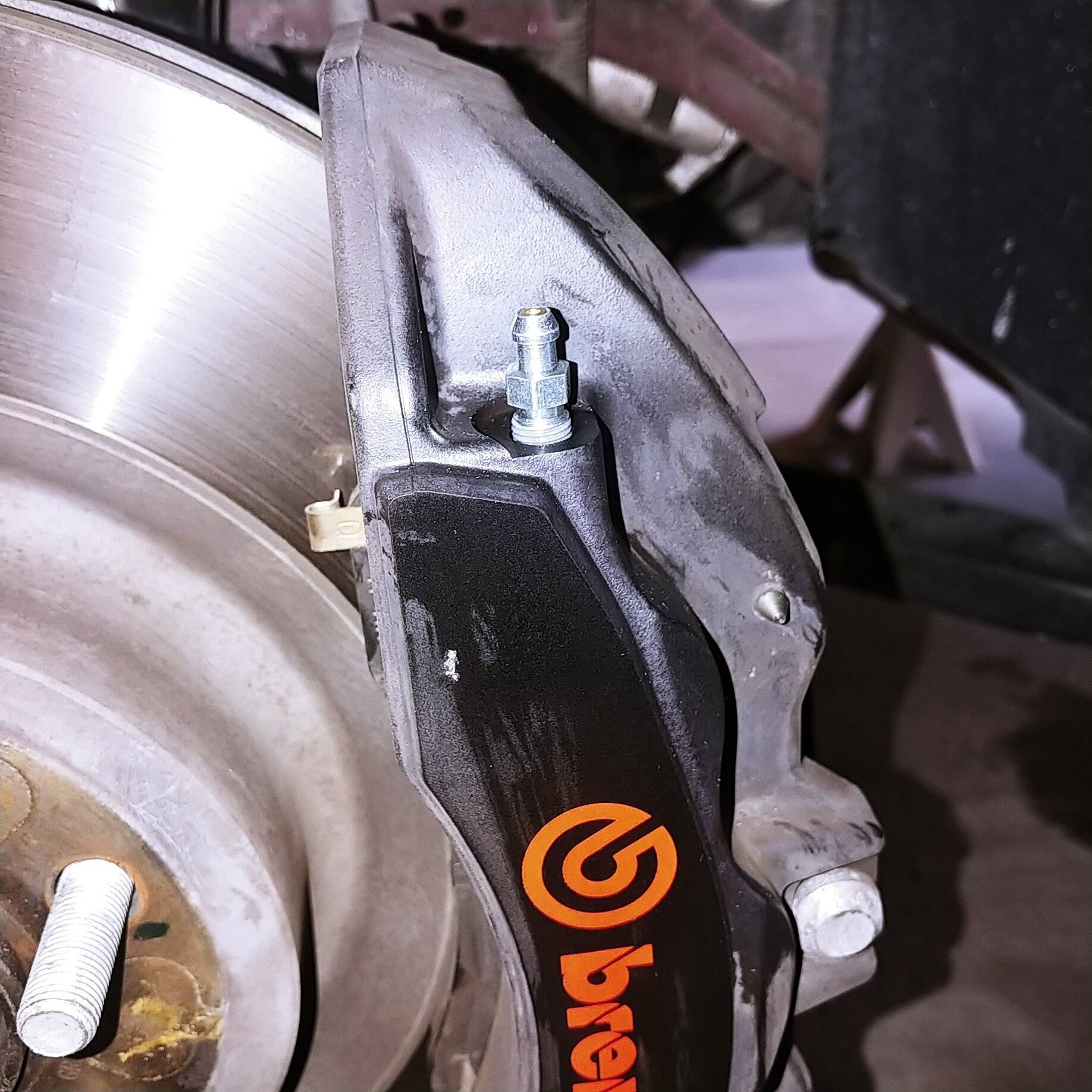

Jan 1, 2021
63
577
581
michigan
jason
2014 impala, 2017 HD. 2018 Royal C mustang gt pp1
had a old set of speed bleeders laying around still in the box. looks like 12701 is the money other than being a little longer. about 3/16"

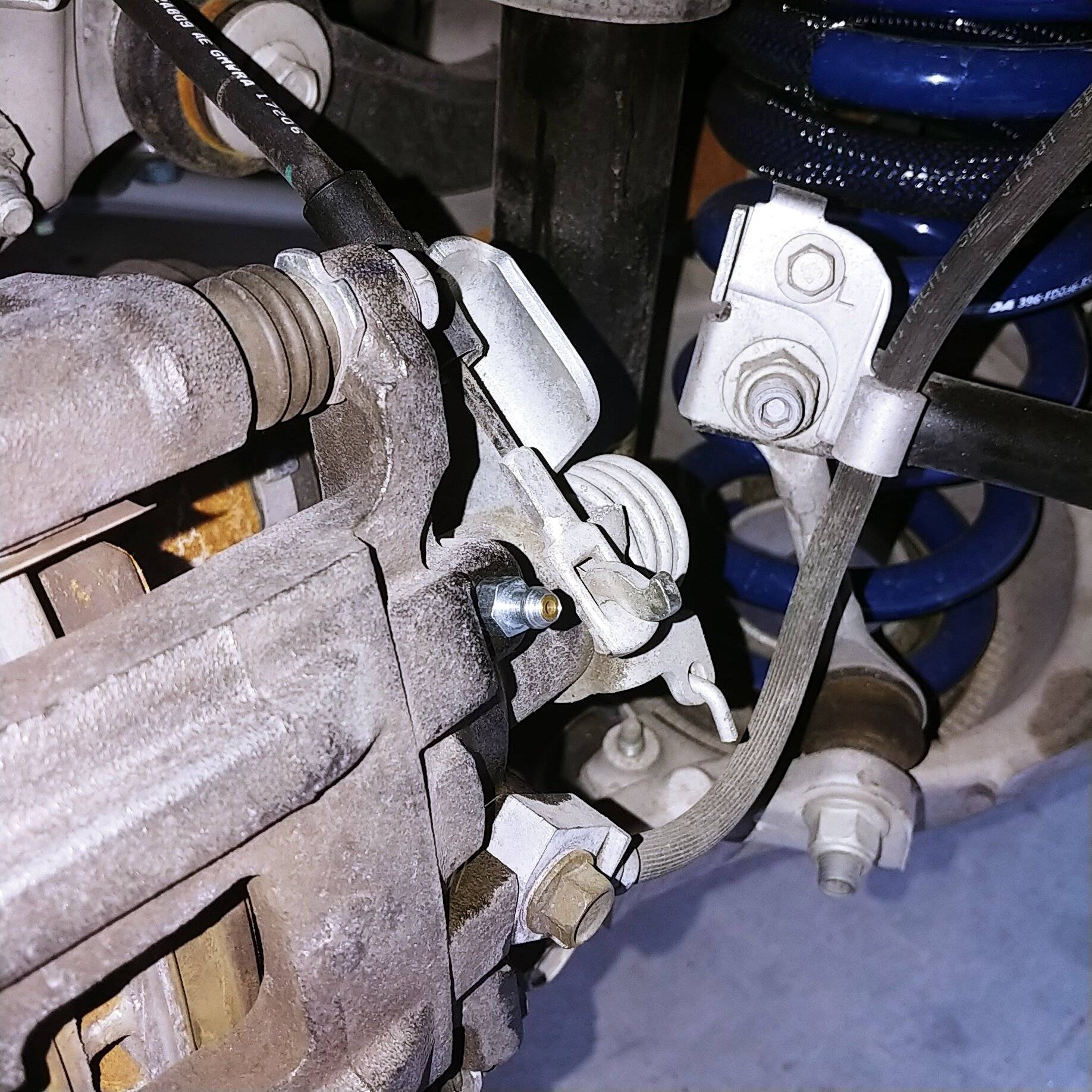

smokescreens
Jan 1, 2021
63
577
581
michigan
jason
same part mumber for the back as well. this time a little shorter though.
