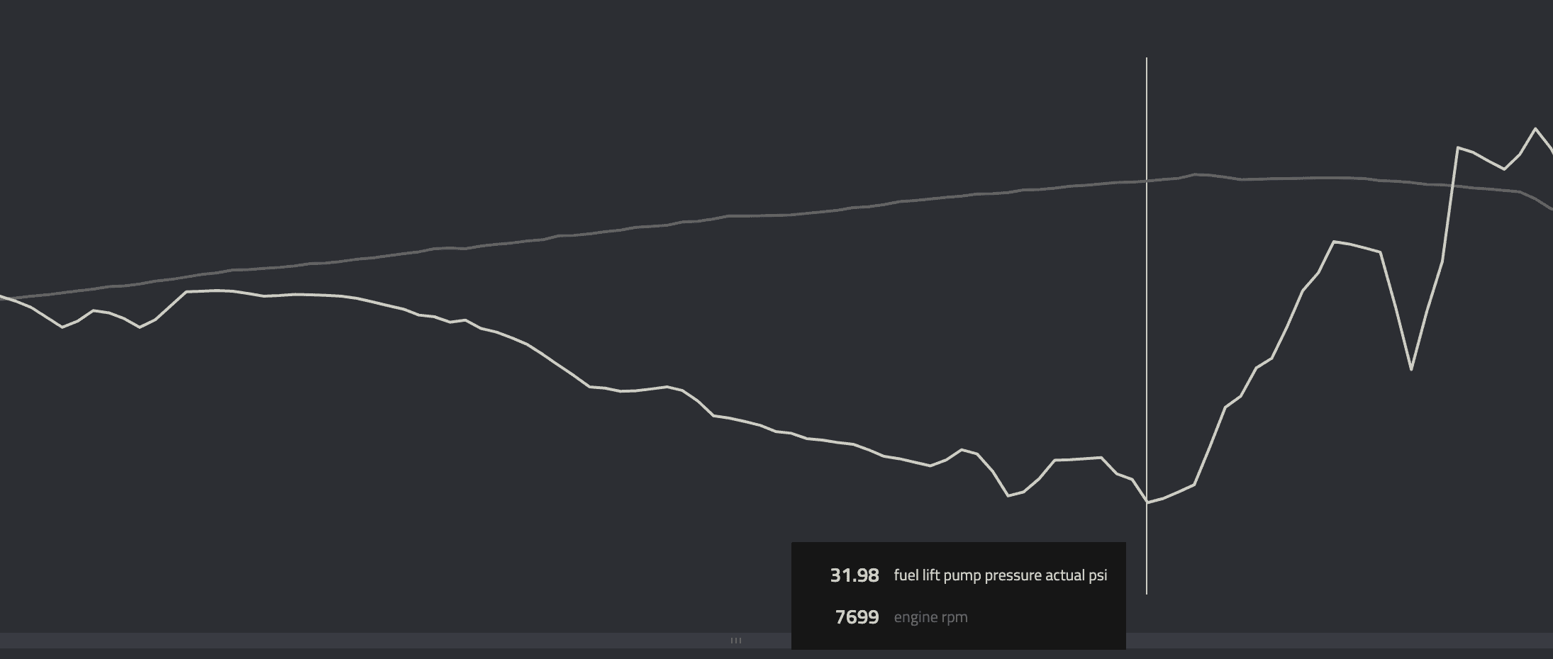

The fuel pressure drops from 60 PSI down to 32 PSI as can be seen in the log below.
https://datazap.me/u/pmor4243/fuel-pressure-drop?log=0&data=19-27&trim=27&tmin=4053.19&tmax=7819.00
To eliminate variables, I put the stock injectors back in with the previous tune and the logs showed similar results - so I am thinking this has probably been happening and I just hadn't picked up on it since I was not constantly tracking my fuel pressure (but I am now) I have not noticed any kind of leak at the injectors or any of the fuel rail fittings and they seemed to install without any issue, both times.
Does anyone know what to check for here? I have a BAP ordered that should be here soon. But based on what Wengerd is telling me, the stock pump should not be seeing this much pressure drop, especially at only 6.5 PSI. Does this point to a failing pump, or is there something else in the fuel system that would be causing it to drop pressure? Or is this just more or less normal behavior with a stock fuel pump under boost and why people go with a BAP.

Have you logged FP demanded and STFT? If not I would look there as well, but I’d imagine Darryl would have asked for that already and found nothing suspicious?
Ya, those are logged as well, should be visible in that datazap link I shared. Nothing out of the ordinary there though. Demand looks correct and STFT were good.
Why not just add a fuel system? It's cheap insurance.
Its looking like that may be the case. I didn't initially plan on it because it seemed that everything pointed to it not being needed at the power levels that I am/was planning to be at.
Ah ok found it in the link.
Hard to tell from the data if it’s the pump or the FPDM but Id look at that as well. I’ve not looked at the workshop manual if there are any tests to diagnose a faulty FPDM. Pump is more likely than the FPDM but maybe worth checking out since it’s so easy to access. You can also jumper the FPDM at the connector to rule it out.
Also I wouldn’t throw a new fuel system at it till you’re confident you’ve found the culprit here.

Appreciate the insight so far. I'm not going to deny that a full fuel system would likely have far more pros and than cons at this point.
That said, in working with Daryle, he was able to make a couple of tweaks in the tune that (I believe) brought up the fuel pump voltage a touch. Fuel pressure is looking much better right now.
I'm still a little worried that this may just be a precursor to the pump going out, but I guess time will tell there.
