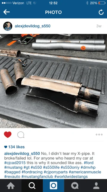

Crack is on the drivers side behind the x. [MENTION=12175]Khyber[/MENTION], I have seen this happen one other time. but It was a video on IG. I forget the guys username but it was completely blown out...

[MENTION=12175]Khyber[/MENTION] or anyone else who has never seen this.

Seen that. He also had kooks off road lts
