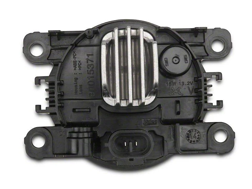

I just took these pics
Do you happen to remember if it's just a Phillips screwdriver for the adjustment, or if it's a hex/torx? And did you do your adjustments with the lights shining on a wall or the lights pointed down the road?
It's a Phillips screwdriver. Use the short handle one easy to do. I did it right on the street. After adjustment I turned on headlights. They point down right below the low beam pattern.
I did this soon after I bought the car, the lights from factory point straight down and do nothing at all. I adjusted them all the way up and then turned them back down about 1.5 turns.
This is what is looks like standing right by the door open, and second pic in the driver seat only these on, no headlights at all. I have never been flashed.

Turn wheel all the way left or right and open the little door in the splash shield. There are three push in pins.

I took the fog lights out (while the bumper was off doing something else) and put a washer under the top screw holding them in (pulling them up higher). Also LaminX'd them yellow...never have heard a complaint (nor been flashed).
*** I didn't know about the adjustment screw at the time***
