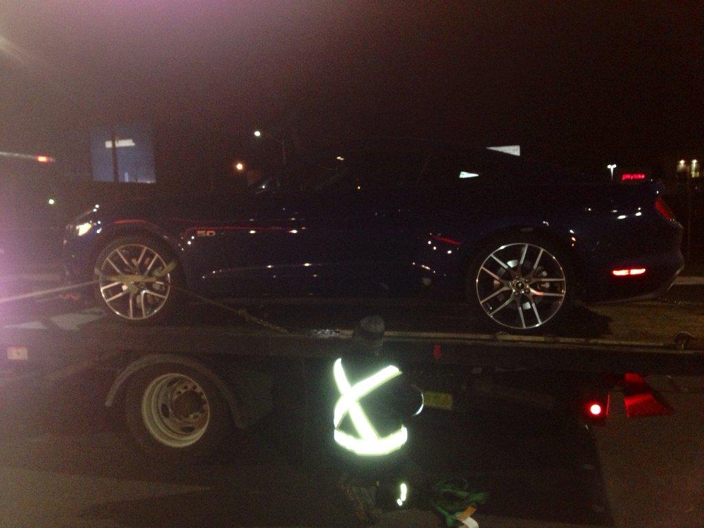

Pick up my girlfriend from work, start driving home all of a sudden engine light turns on, so now I'm really freaking out, pull off into another parking lot shut the car off for a few seconds turn it back on....nothing engine is turning over but not firing up. Try it a second time fire's up revs drop instantly to about 400-450, at this point I just wanted to get home, start driving away and I can feel something is not right, I get to the intersection start turning right and BAM car is DEAD engine shuts off no power no nothing. So I'm sitting there like WTF just happened people are driving by staring taking pictures blah blah blah, I call Roadside assistance get picked up, towed to the nearest dealership left there due to it being 10 PM.
