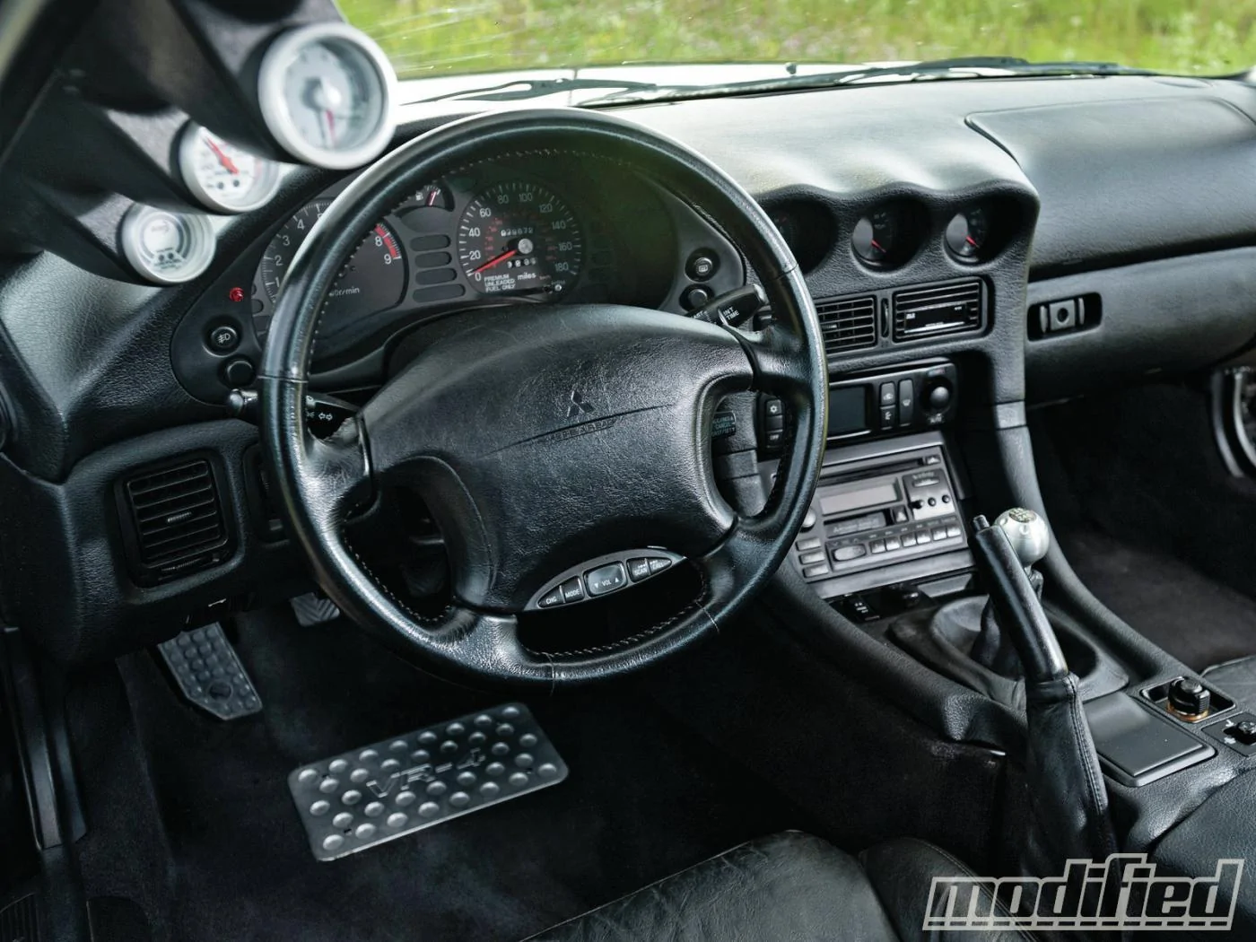

...and took it totally out of the line of sight. Those two gauges are there for the ghosts in the backseat to monitor. Had to put my AP on the windshield to monitor things like boost better.
Things like that remind me of how cool cars with wrapped cockpits and gauges feel when sitting in them. I like all of the center display digital stuff nowadays and the dash gauges are more of a novelty, but I love the driver orientated cockpits like the old 3000GT and Supra where all of the gauges were looking at you.
