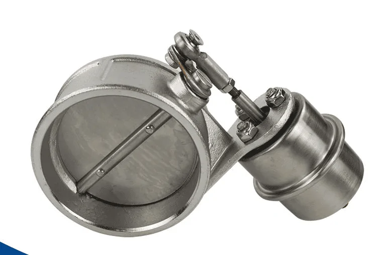

What you need is something like this, it's vacuum actuated. You can adjust the rods length to have it slightly open or a better way to use t hem would be to cut the bottom or top off of the valve so it only blocks about 50% of the exhausts path, then when you hit 0 vacuum the flapper will open all the way and get louder and flow more. the 3" size should make up for the .25" think flapper stem in the middle too so once 100% you should flow as much as the stock 2.75" pipe anyway

Yep, familiar with those and they are awesome... except when they create a vacuum leak and then they aren't so cool.
Like where your mind went though, thanks for the input.
