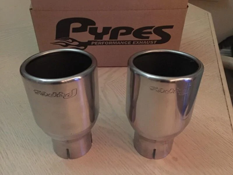

Got the Exhaust Tips in last night. Went with Pypes 4" Rolled Tips, at $56.92 for the pair....they were a great deal from Summit Racing. Can't wait for the mufflers to get in on Friday!
