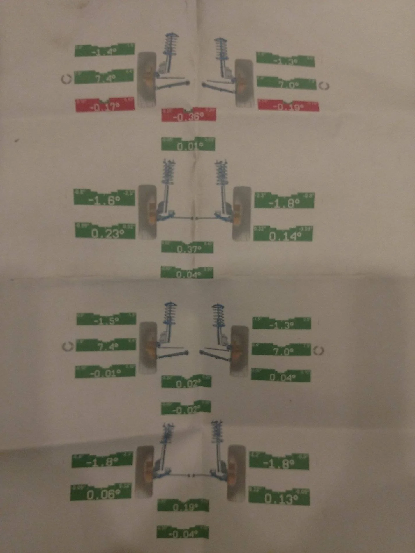

Just installed eibach springs on my 2019 mustang gt. At the same time installed rear cradle lockout, rear differential bushings, subframe alignment pins.
The struts were installed with the factory bolts. You can see the before and after alignment. Front camber is in specification. You may only need caster camber plates or adjustable camber bolt if you want to find tune your camber. No adjustment was needed in the rear end.

Which Eibach springs? Do you have any ACTUAL before and after ride height measurements?
Do you have an alignment print-out for when the car was still on its OE springs (for getting a rough idea of the amount of camber change)

I did not check the alignment before I did the work. I installed eibach pro springs. Did not take before and after ride height measurements. Here is a picture of before. I will take a better picture of after. Does ride very close to stock
