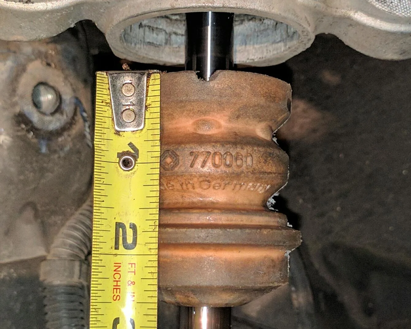

2015 Ford Mustang GT
Rears Measured It's about 2.5" and it definitely rides on the bump stops, after 40k miles. Part number 770060.
http://eibach.com/america/en/motorsport/products/accessories/bumpstops/770060
Web site says 2.75"

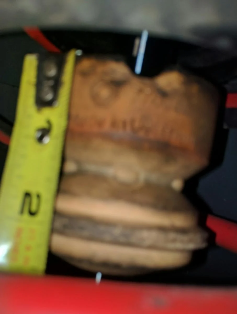

Fronts measured it's about 2.5". Part number 770044
Sorry for blurry pic my phone died as I was taking this pic.
Again these are part of the spring rate so cutting your bump stops is just like cutting your springs to lower a car.
looking at these im either going to get new bump stops or switch to BMR linear rate springs. Mine seem to be quite shorter than what they should be.
