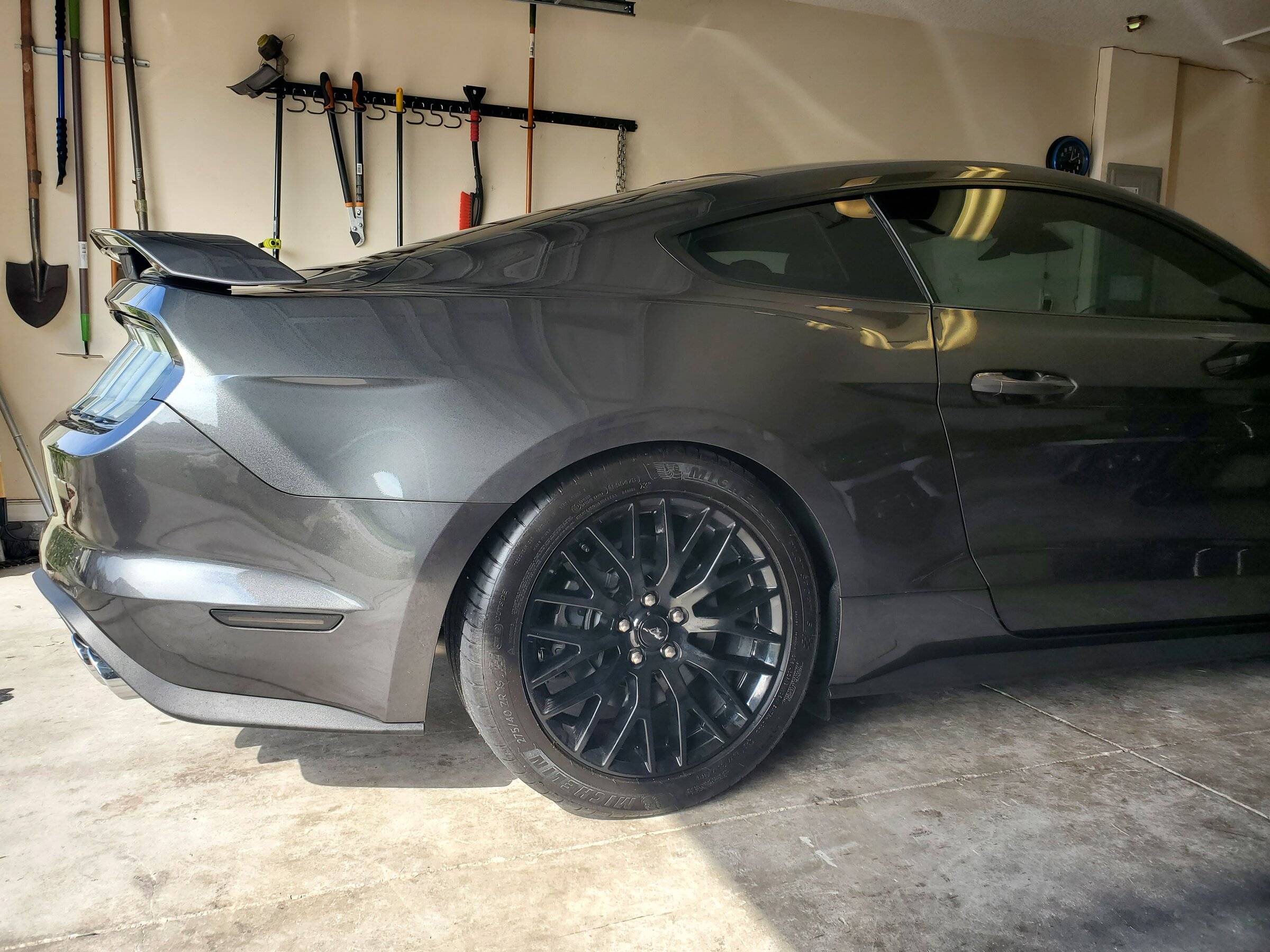

Hello all, quick question regarding tire height. My 2020 GT is a PP1 car with the factory 19" wheels. I am lowered on Steeda Progressives and have a nice stance without being too low, however i definitely dont want it to sit any higher either. Im looking at swapping out the factory PP1 wheels with the 255/40/19---275/40/19 setup and moving to a 19x10.5 front wheel and 19x11 rear, with tire size moving to 295/35/19 squared setup. What i cant seem to for sure figure out is how will this change the stance of the drop, if at all. Factory 275 rear tires sit 27.7" tall with 295/35/19 sitting at 27.1" tall. Not much a difference i know, but does this translate to the car sitting slightly higher on the lowering springs, sitting slightly lower, or not changing at all due to some suspension geometry that i dont understand yet? Or am i nuking this whole thing and can get away with running the original 275/40/19 but now squared on all 4?
Pic of my car for reference. Thanks

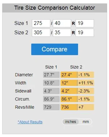

A 305/35/19 is very close to the tire height of the 275/40/19 (about 0.3"smaller over all, giving you less than 0.15" drop)

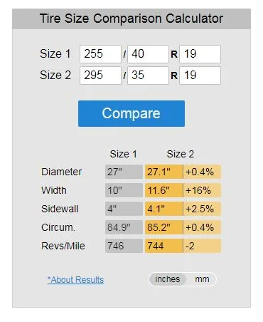

The 295's up front are within 0.01" to the taller of the stock 255s
