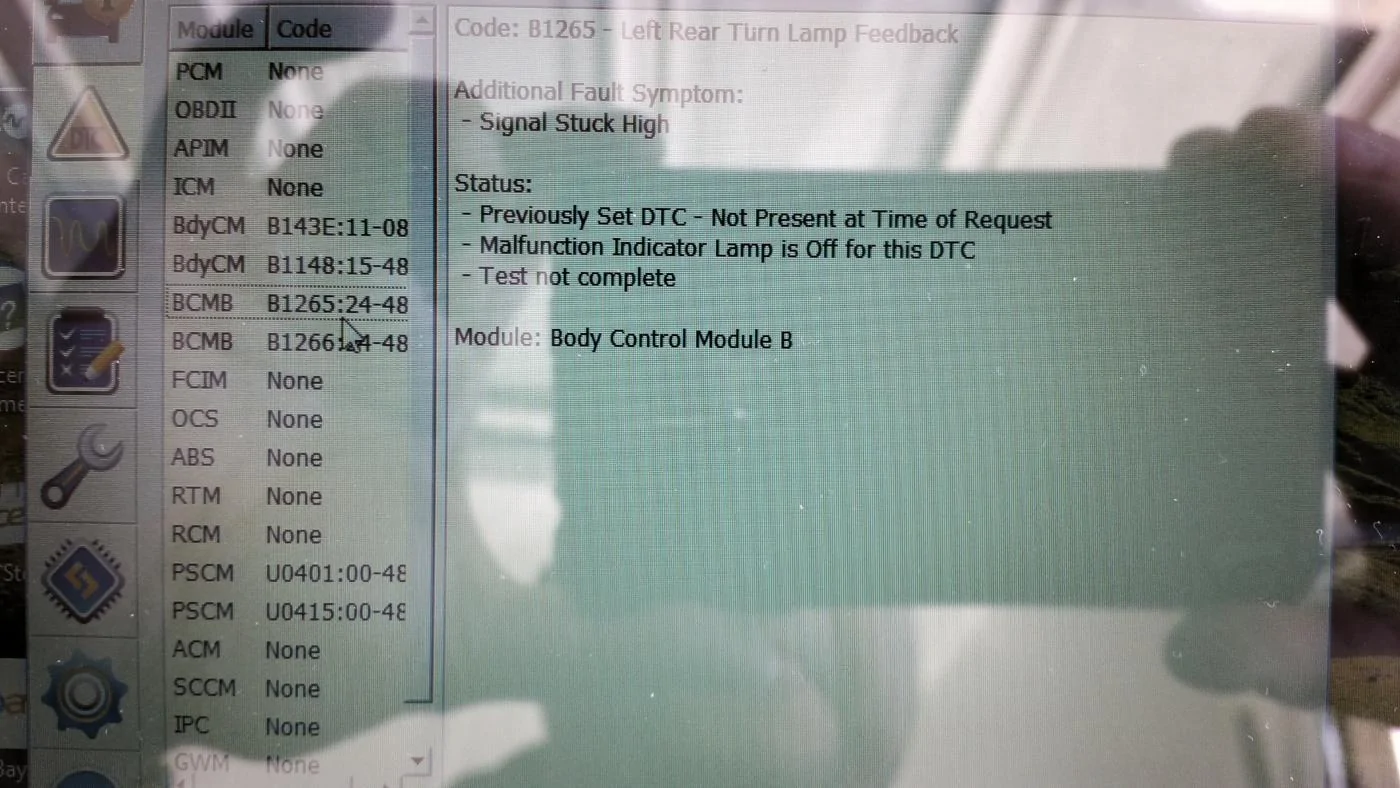

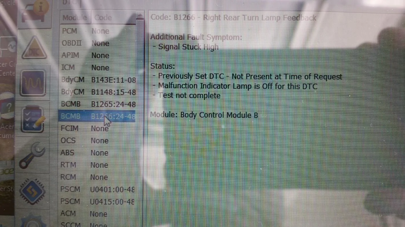

So...noticed this yesterday while changing some build data. Anyone else have this showing and are running sequencers? (DD or Raxiom...I know, same OEM)

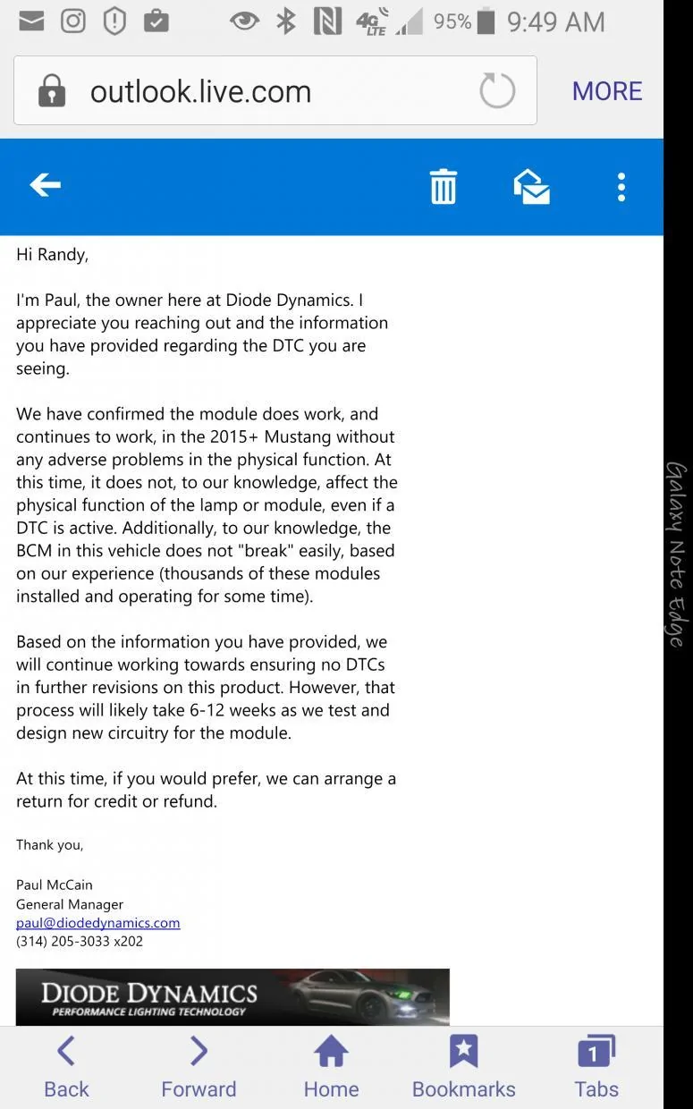

Spoke to Nick via FB...he has never seen it and will forward info to their engineering. We are both in agreement that by design, the sequencers should not be causing any error codes for them to function as intended. He told me to call or email for replacements. Spoke to Steve from DD by phone who basically told me he does not think replacements will help. So sounds like I'm SOL $80. Considering the BCMs on our cars are on the weak side, I'd recommend holding off in buying this kit...YMMV.
EDIT: Removing the sequencers and clearing the codes fixes the error messages. Reinstalling the kit brings the codes right back.
