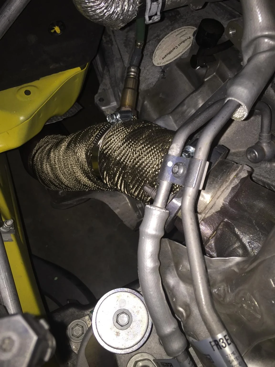

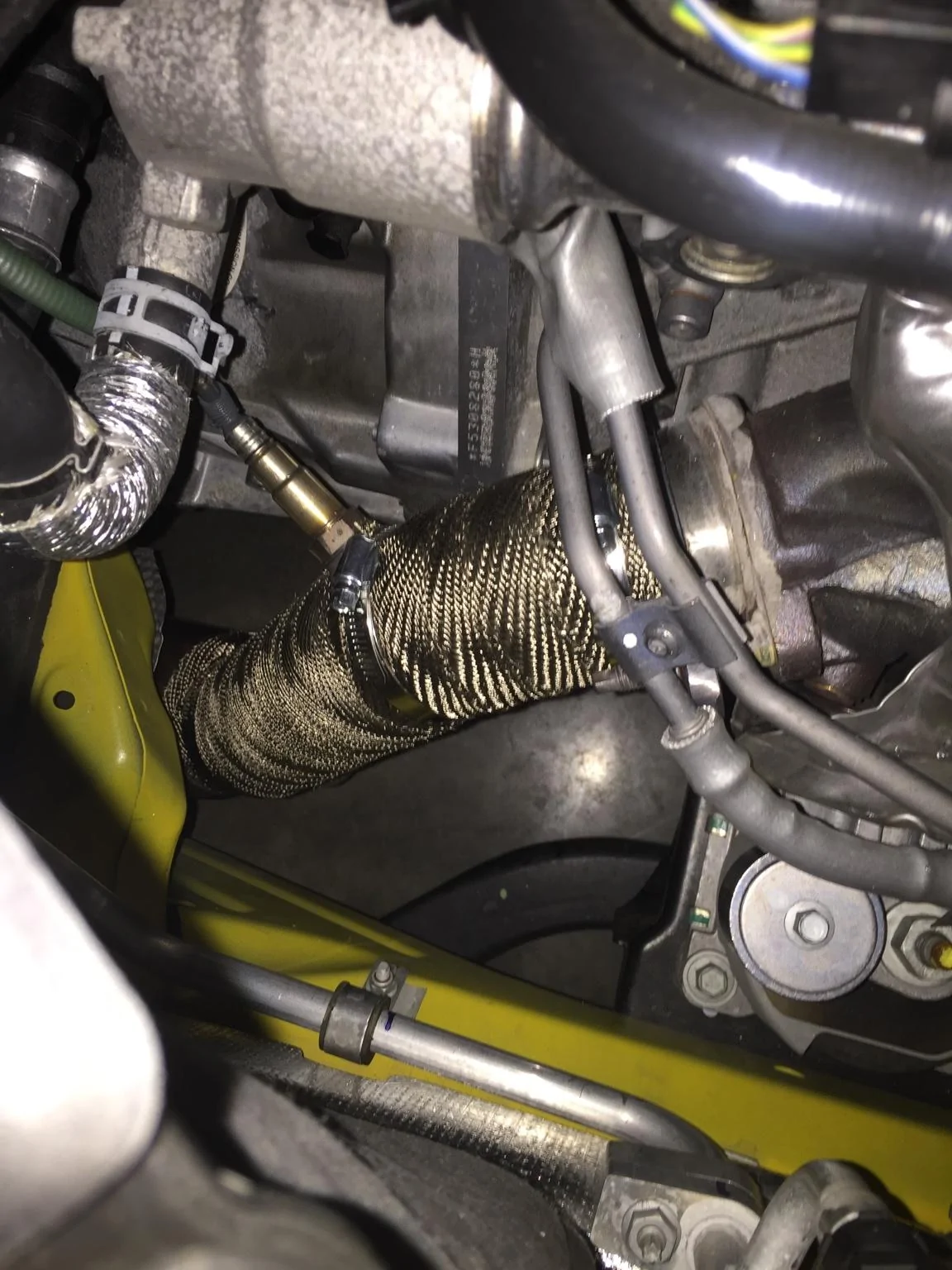

For anyone that installed a downpipe and wished they had wrapped it, well it is possible to do it on the car. I have an MRT catted DP and I was able to wrap from flange to cat while it was on the car. It was a PITA and involved dropping the roll a few times but it worked, started under the hood and had to jack the car up finish from underneath, still easier than pulling it off to do.
DEI Titanium 2" x 15 foot roll and four 3.5" hose clamps.
