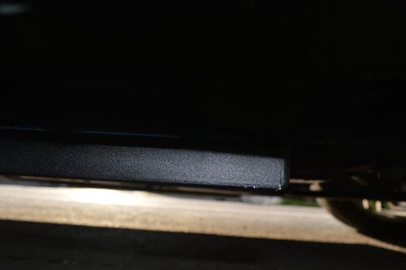

Ok, just installed the jacking rails from Steeda. Finally got some nice weather today and I had some time. Quality piece.
A 15 min install on a lift. Took me a little longer because I installed laying on the ground without any jack or stands. Used Blue Loctite on the bolts. No torque specs from Steeda in the instructions so, I just torqued them to 62-63 ft./lbs. like BMR. Hangs down about 1/2" or 25mm from the frame (didn't measure). Hope I can still get my floor lift under there.
If not, guess I'm gonna need a new jack or some ramps.
wildcatgoal
@sirboom_photography
Feb 8, 2016
76
6,589
2,513
TBD
You can get your floor lift under. I've put mine under with a lowered car, no problem.
I have one of the low profile quick lifts though.

wish those rails were that easy to mount on the convertible... I've been reading all kinds of woe from convertible users. (Apparently we got extra stiffeners down under :D)
is your plan to use these to jack up an entire side of the car (i.e. for wheel changes) or something else?

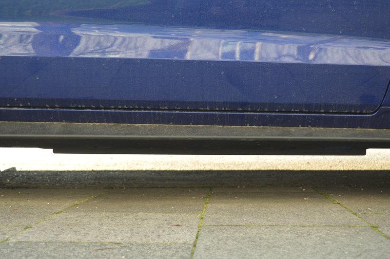

'16 DIB 2.3T
They are a bit lower than the frame but that is to be expected.
