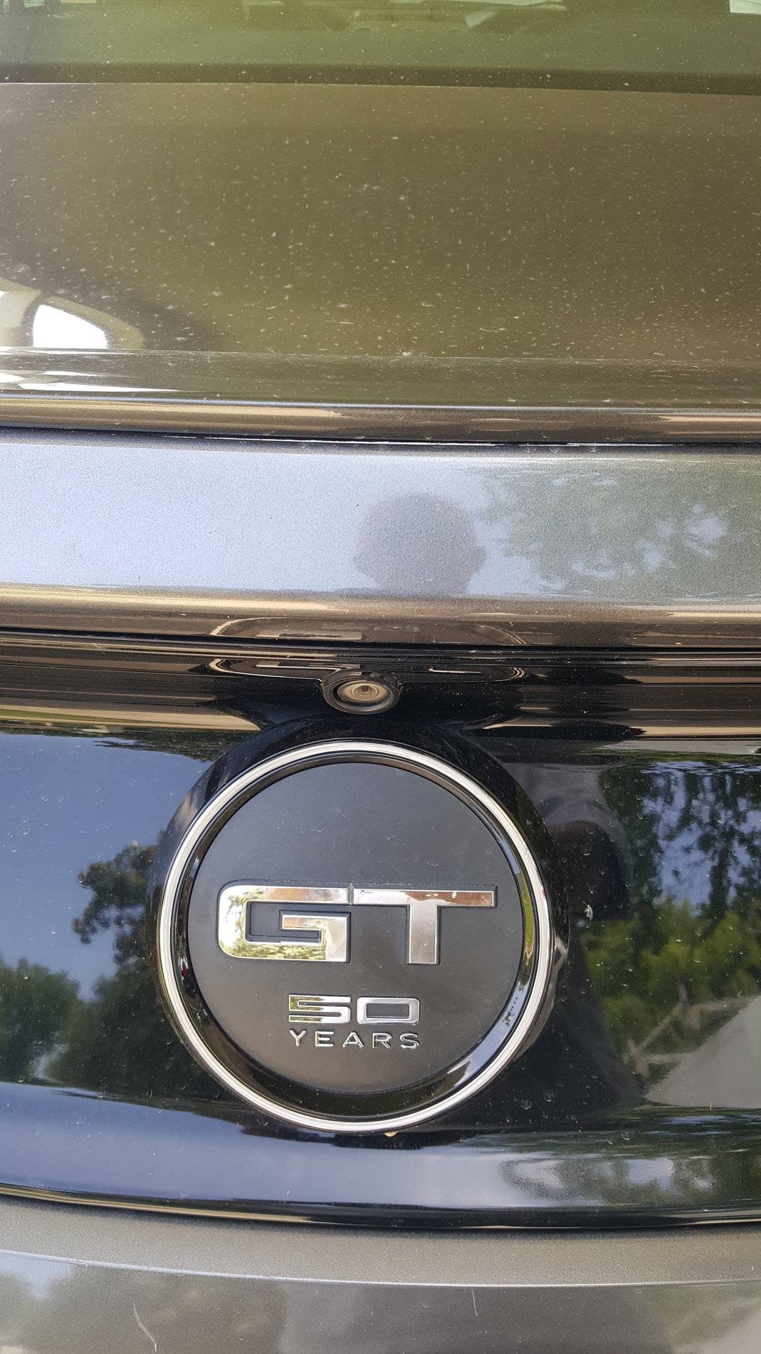

My emblem fell off recently. To fix it, I bought some JBWeld plastic bond epoxy at Lowe's. I removed the rear panel, cleaned the surface with window cleaner, then epoxied the heck outta it. I put some weight on the emblem & let it sit for about an hour. So far, it has stayed on, but I plan on ordering a plain black panel & store this one inside, for keepsakes or if I sell my car. It seems that boardroom engineering department at Ford would have convinced the sales managers that sometimes cost effectiveness sometimes needs to be overridden in the name of quality.

That's quite a good fix, mindo389. Couldn't have done it better myself.
