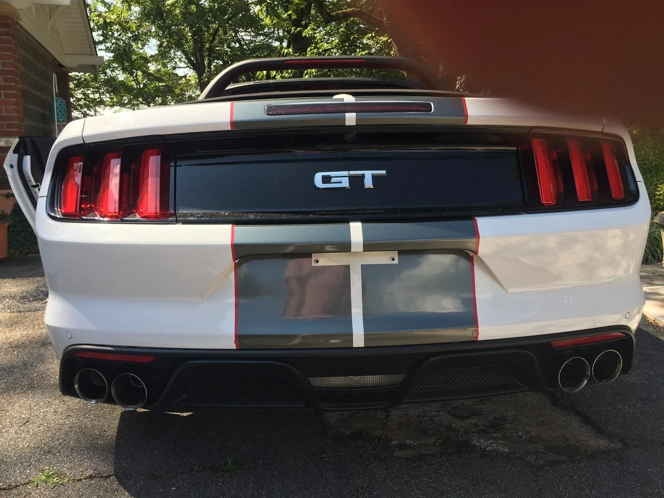

If you haven't already bought your exhaust I personally would go with the Ford Performance by Borla Quad tip Exhaust. There is a lot less cutting and it just looks better to me with the GT350 lower valance. Also you keep the rear brace if you have a convertible.

My bad, I meant I'm going to try and enlarge the current dual openings wider to accommodate quad tips... like this:
@bguerrero13
https://www.mustang6g.com/forums/showthread.php?t=44850&highlight=custom+exhaust&page=4
I might try this as well. I cut out my front grill, and the plastic material sanded up to a really nice finished edge. FWIW, I'm running a Solo II Thunder exhaust setup, my car has the Premium rear valence setup.
