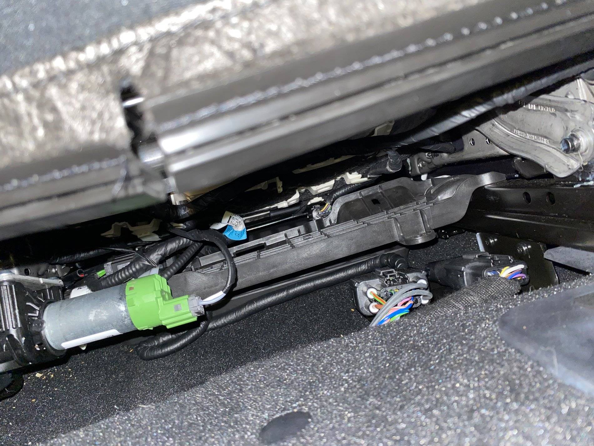

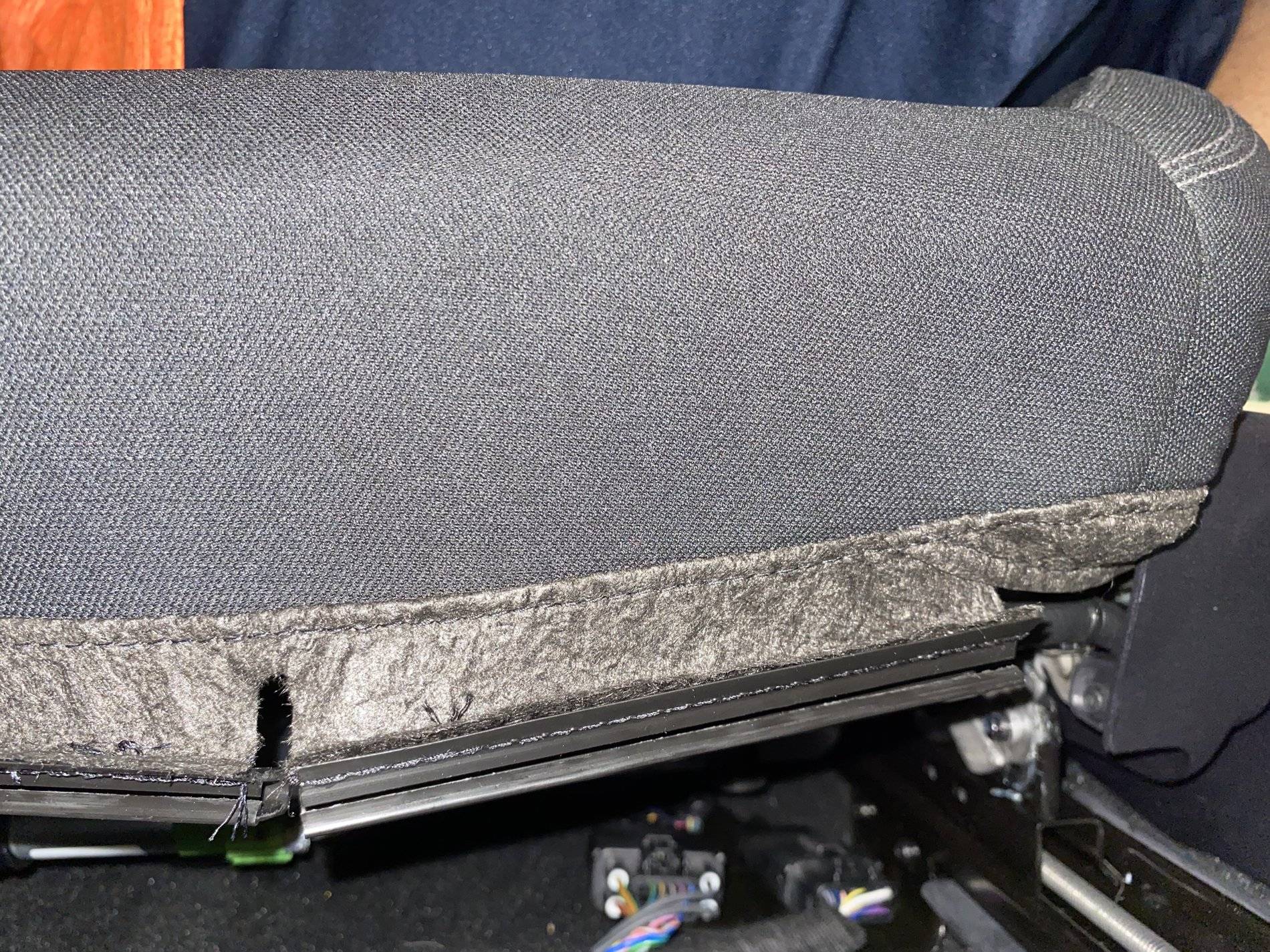

This may be a ridiculous question and I am sure there is an easy answer, but I can’t figure it out.
I have a 19 Mustang GT with cloth seats. The two plastic clips on the driver side seat that hold the cloth in place have seemed to pop off. How do they reattach? I’m sure there is an easy fix and I’m being dumb, but I spent way too long trying to figure it out. Haha

They fold over on themselves and slide onto a thin sheet metal strip on the seat. Roll them up in towards the seat so their openings are facing the strip, then you have to pull / stretch them to rotate them onto the strip.
