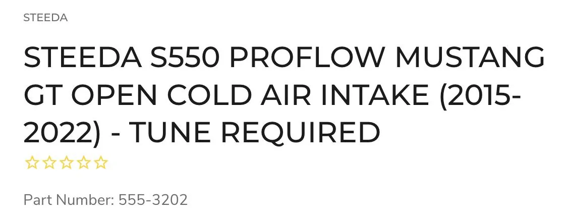

There are a few negatives though. Firstly I ended up buying the slightly older (I think) version of Steeda's open air intake (fully plastic tube instead of part metal - old P/N is 555-3228 and new is 555-3202). I hadn't appreciated this and tbh would have gone for the newer if I had known there were two! Nobody pointed this out in my emails to and fro with Steeda. This is probably on me tbh, but just mentioning it. Also fwiw the Steeda.co.uk website actually cites 3202 as what it was sending me when I placed the order, so I am a little confused... but I haven't the energy to fight it now.
https://www.steeda.co.uk/products/s...015-2020-tune-required?variant=43072752386266
The second negative was you need to be super careful with the tune form from Steeda. I selected that I had a Steeda open air intake (there was only one option) and when the tune arrived the car smelt very rich on cold start up. It took a lot of back and forth and quite frankly me being dogmatic to get Steeda to look at this again and inform me they had sent me a tune for the newer CAI and not the older one (again I didn't know there were two and even if I had the Steeda.co.uk website even uses the newer part number for the kit I bought lol). Once I got the new tune all ok but this was more than a little frustrating. Also honestly the dialogue with Steeda was painful.... one word/line responses at times and like getting blood out of a stone in terms of information. I am very happy with the outcome but I could have very easily ended up with a suboptimal setup if I hadn't pushed. I guess this is the pro of a dyno run etc, but in the end I wanted something from a company like Steeda with a lot of background/history. I guess you pay your money and make your choices and live with the outcomes.
