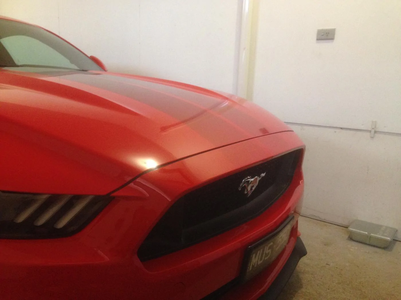

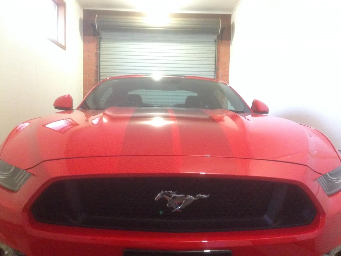

The reason I asked is, after seeing the Race Red with Black OTT stripes I have feeling my Silver OTT stripes on Ruby Red might be a bit too 'loud'.
Looks like this:
LOL
The silver stripes look good on ruby I think :thumbsup:
