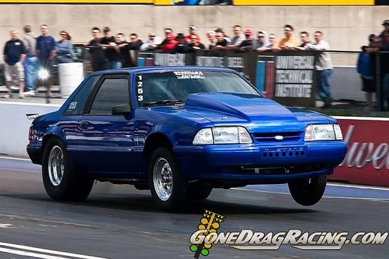

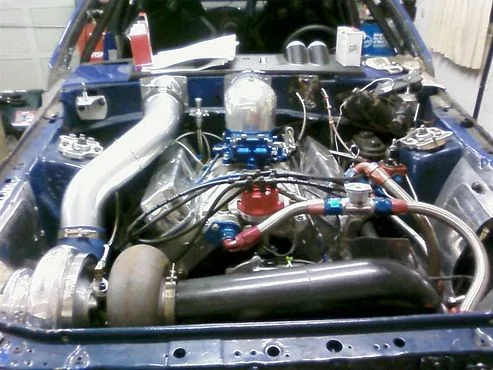

Nice I like the design with no CV joints.. You had a blue notch with a blow thru turbo setup on it back in the day right?

Yes sir I did. Miss it!

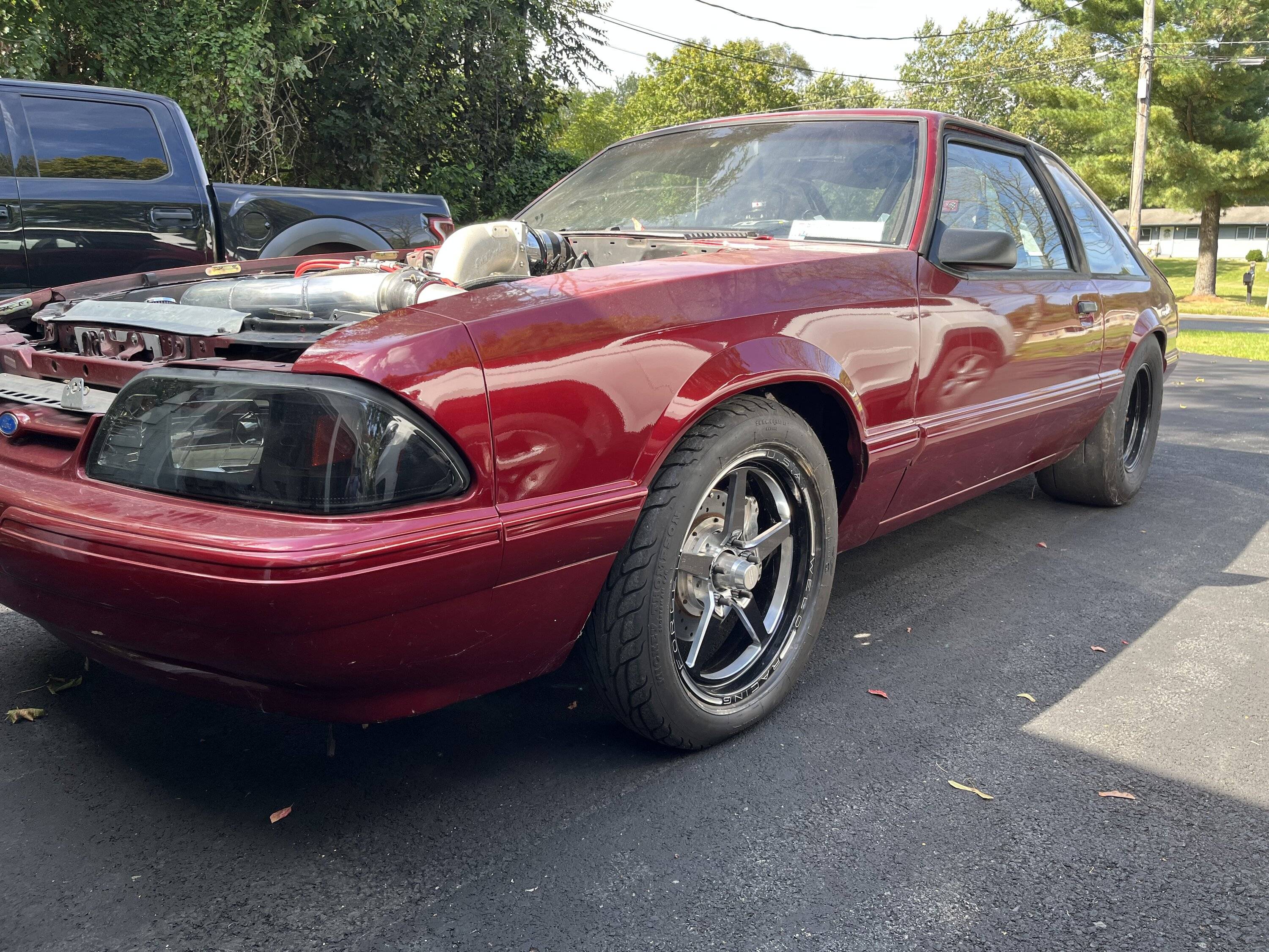

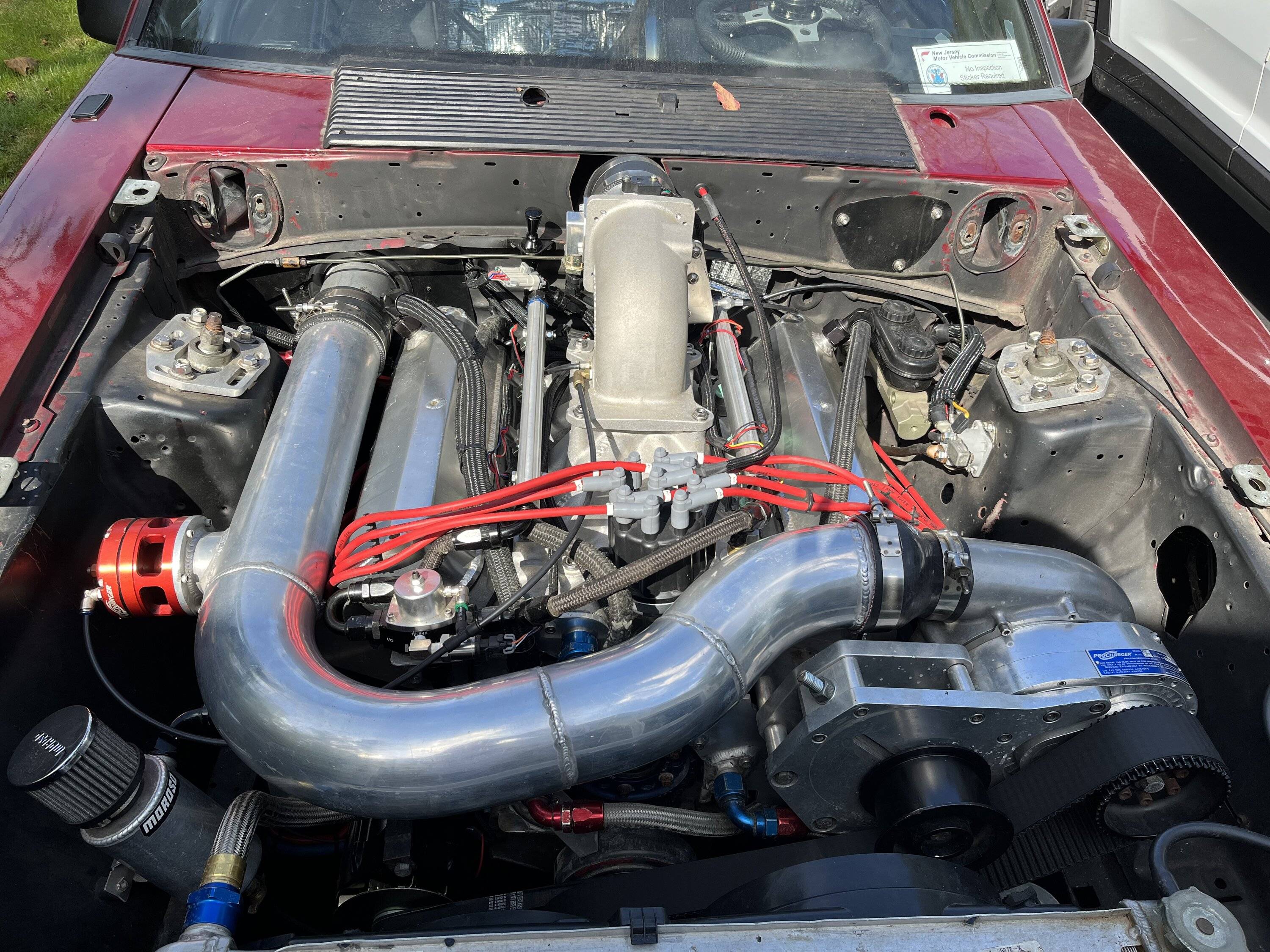

That was a badass car especially for that time I remember talking to you about the Blow Thru you know my friend Adam. Ended up selling mine last yr to get one of these also.

Yeah, it would have gone significantly faster with todays technology, but i had fun with it. Esterland? Nice hatch! What size procharger is that?

Definitely still went pretty fast from what I remember. Yes had the black notch that had On It on the back window. Thanks, it was a F1R Procharger it made pretty good power considering the motor was a little on the big side for it.

Went 8.17 @ 172 with a slow 60'. Yeah, I still talk to Adam. He was over my house for a party in May.
