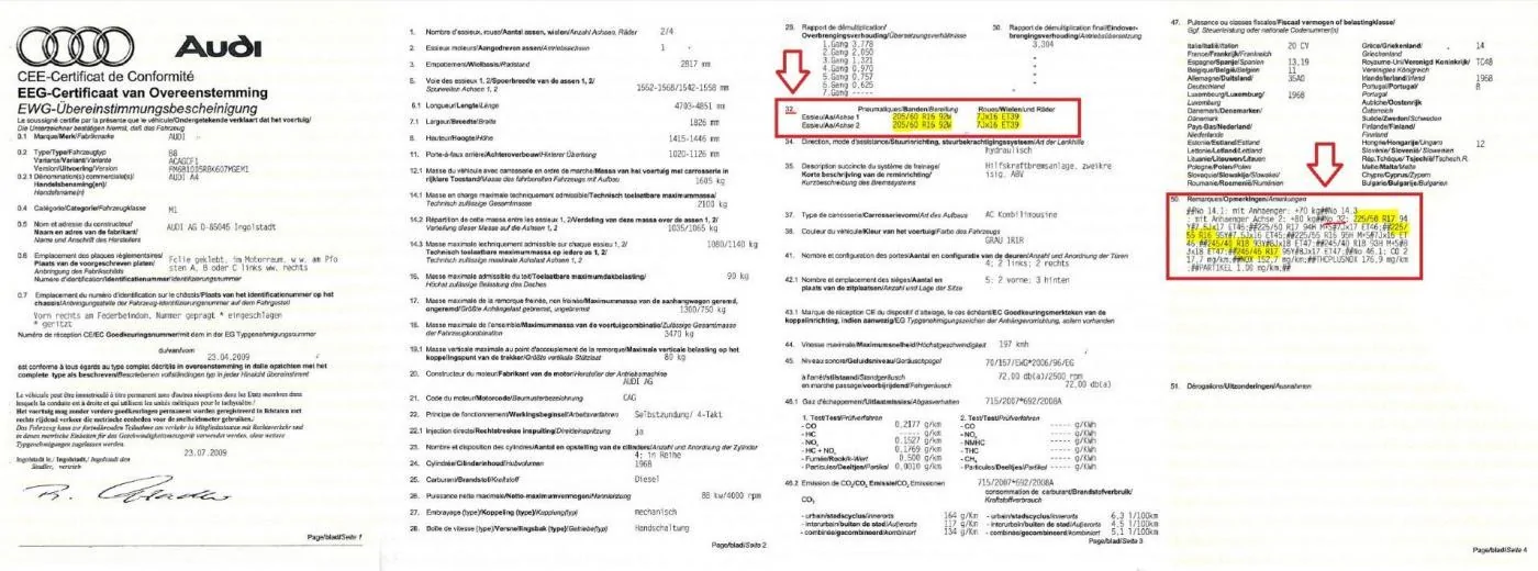

I asked the dealer about rear 275s on the Ecoboost like the GT has. He said you can do whatever the "gelijkvormigheidsattest" (sorry, don't know the english term) says is OK as alternative tire sizes, but every other size besides that would be illegal and probably a problem for insurance in case of a crash as well. (as [MENTION=21266]Voodoo077[/MENTION] already said)
Here's an example from google on an Audi.
Haven't checked ours yet... Sorry
Ericc B
Oct 30, 2013
3,428
1,352
NL/SP
Various Mustang GTs
Yeah but with most Audii there are optional 18, 19 and even 20 inch wheels, which are all homologated by the factory. With the EcoBoost Mustang there is no other wheel option than 19" with 255/40/19 front and rear. Unless indeed the EcoBoost and the GT are considered the same model. In that case the 275/40/19 rear is allowed.
