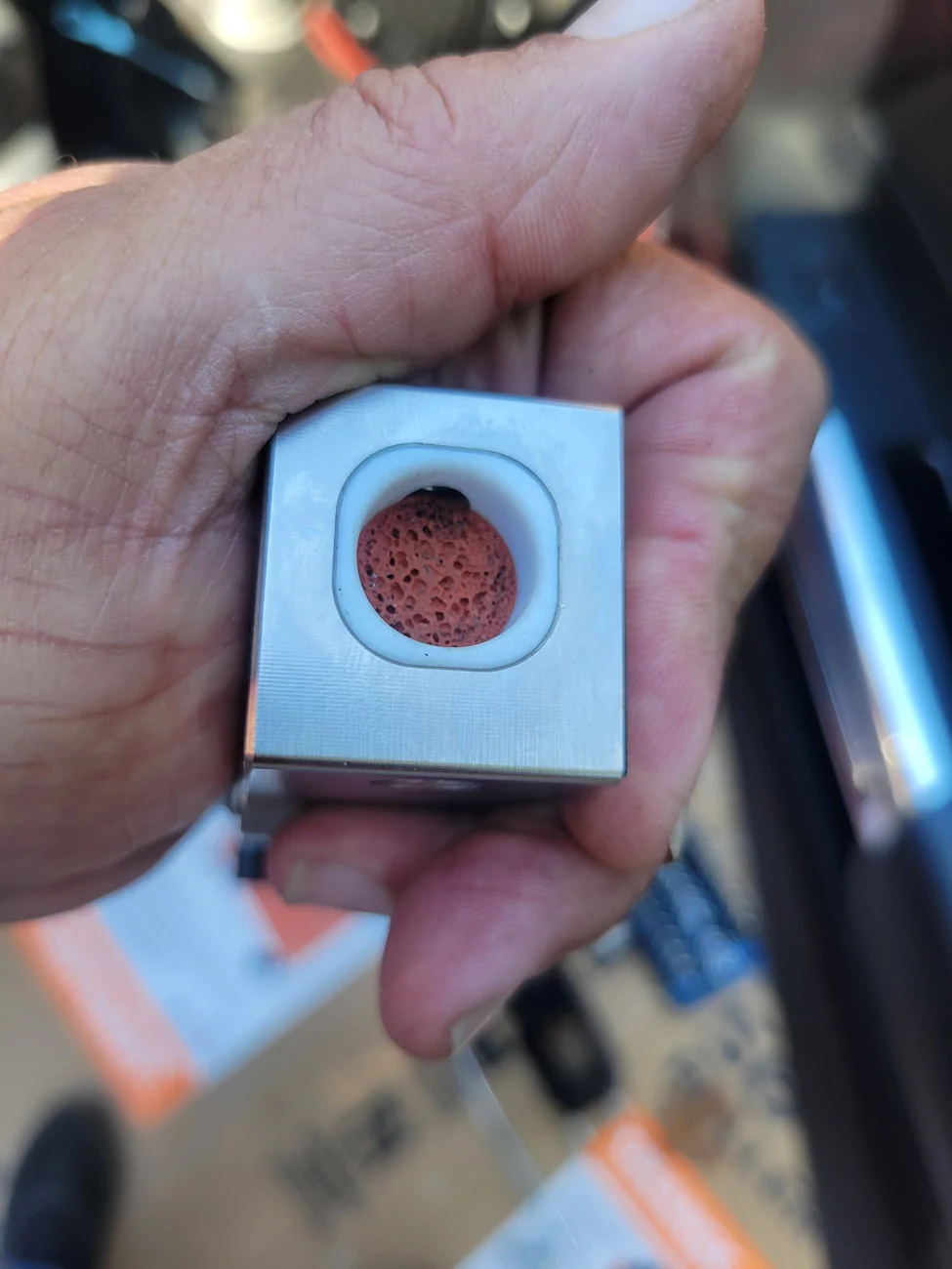

I'm installing the Hybrid 3 in my 2016 Mustang. And had a couple questions as the videos aren't quite current. Do I need to use any thread locker on the shoulder bolts on the linkage also there is a rubbery pad in the end of the linkage where it attaches to the transmission shaft, does that stay? There is also jam nut for the shifter knob, possibly? Nor written instructions in the box or on the their web site.

That rubber stays in place. It is there to remove any slop. You can use a little blue Loctite on the threads but don't overdo it. Depending on what knob you use, yes, it is to lock down the knob. Did you order the shifter with a knob?
