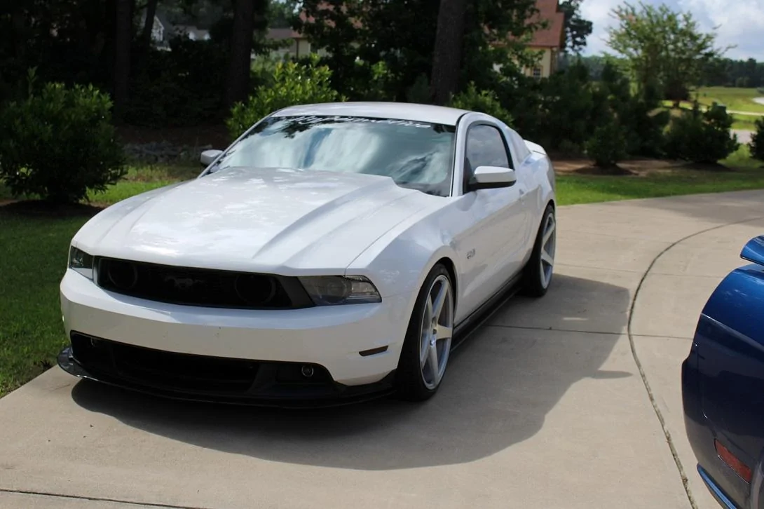

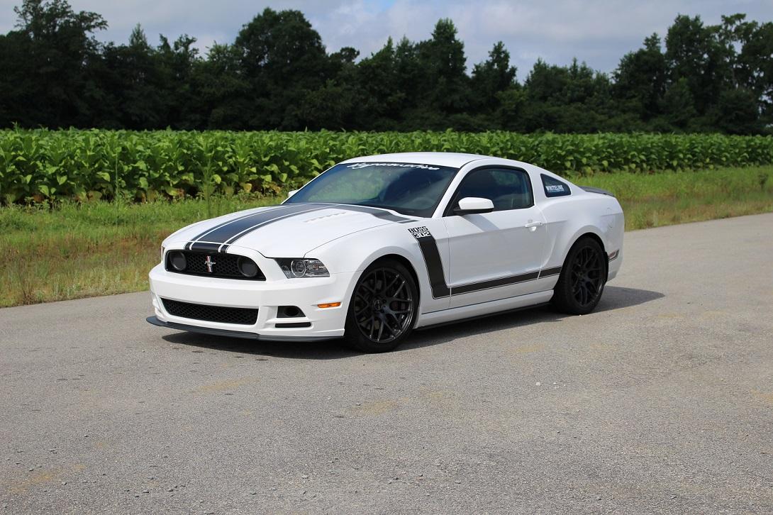

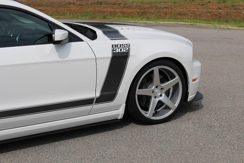

The main thing I can't stress enough is 19's in the Avant Garde's are not clearing the pp brakes. The only ones we were able to get to fit are the M310's but in 19x8.5.
Here's some more pics of Doug's white 2012 running the M550's. Also, those 20x9 in the front are running a higher offset so dropping to a 20 offset will give the front a little more of a concave look to it.
The 19x9.5 M580's will not clear the 15" PP brakes. Just like the 590's they wont even clear the 14" 4 piston brembos. Keep in mind that Doug's car shown here has stoptechs which have smaller diameter calipers.
Our 13 Boss we ran the 550's and M310's.
