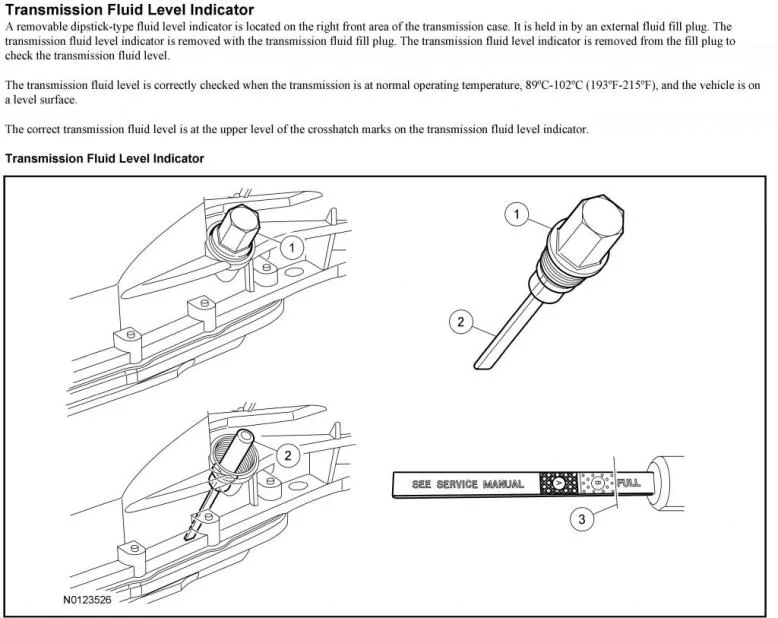

Swapped a new converter in this weekend and I noticed that the dipstick has an A and B hash mark. Googled and searched and didn't find an answer. Does anyone know if one is hot and one is cold? Appreciate any help. Thanks
