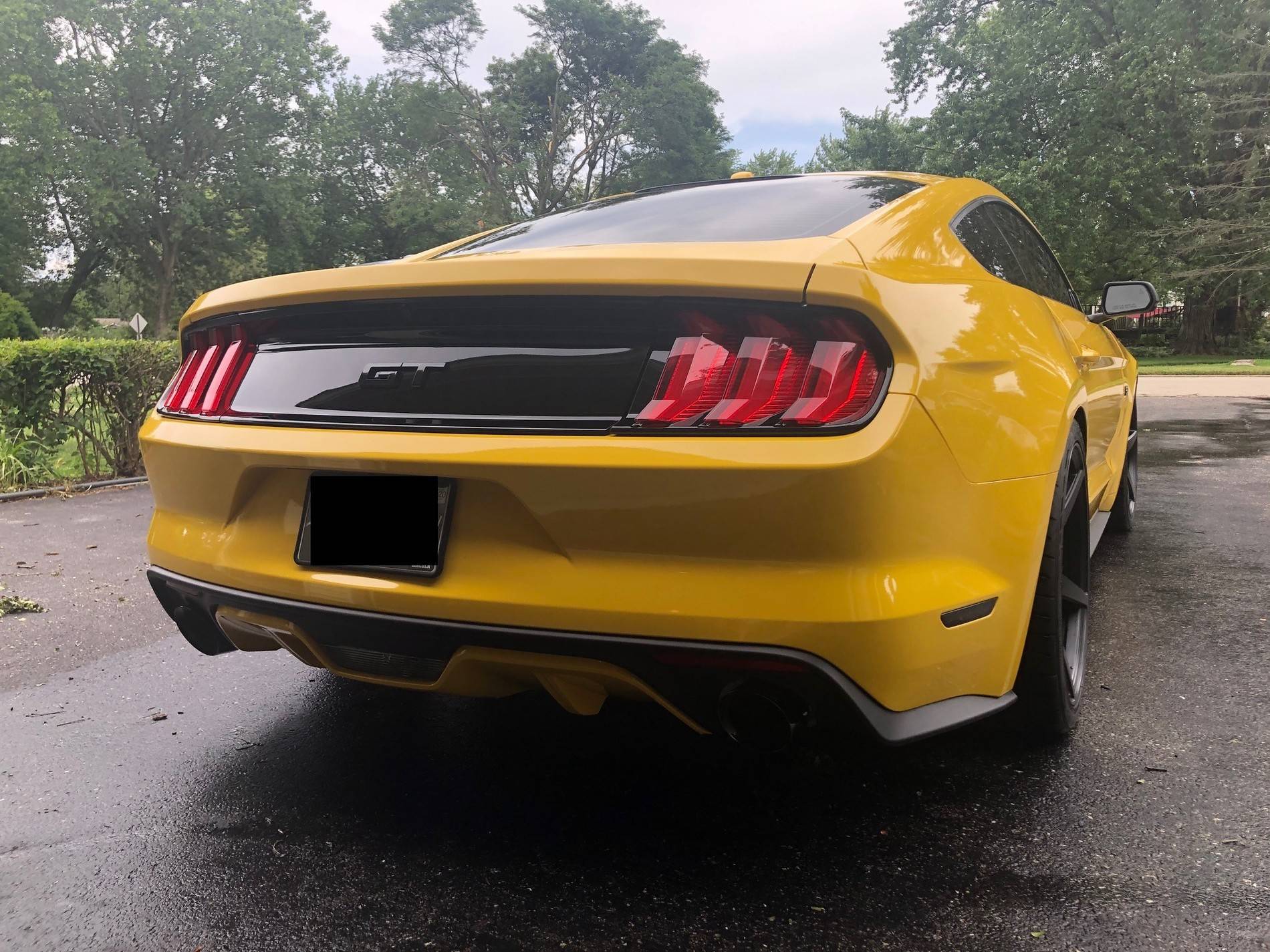

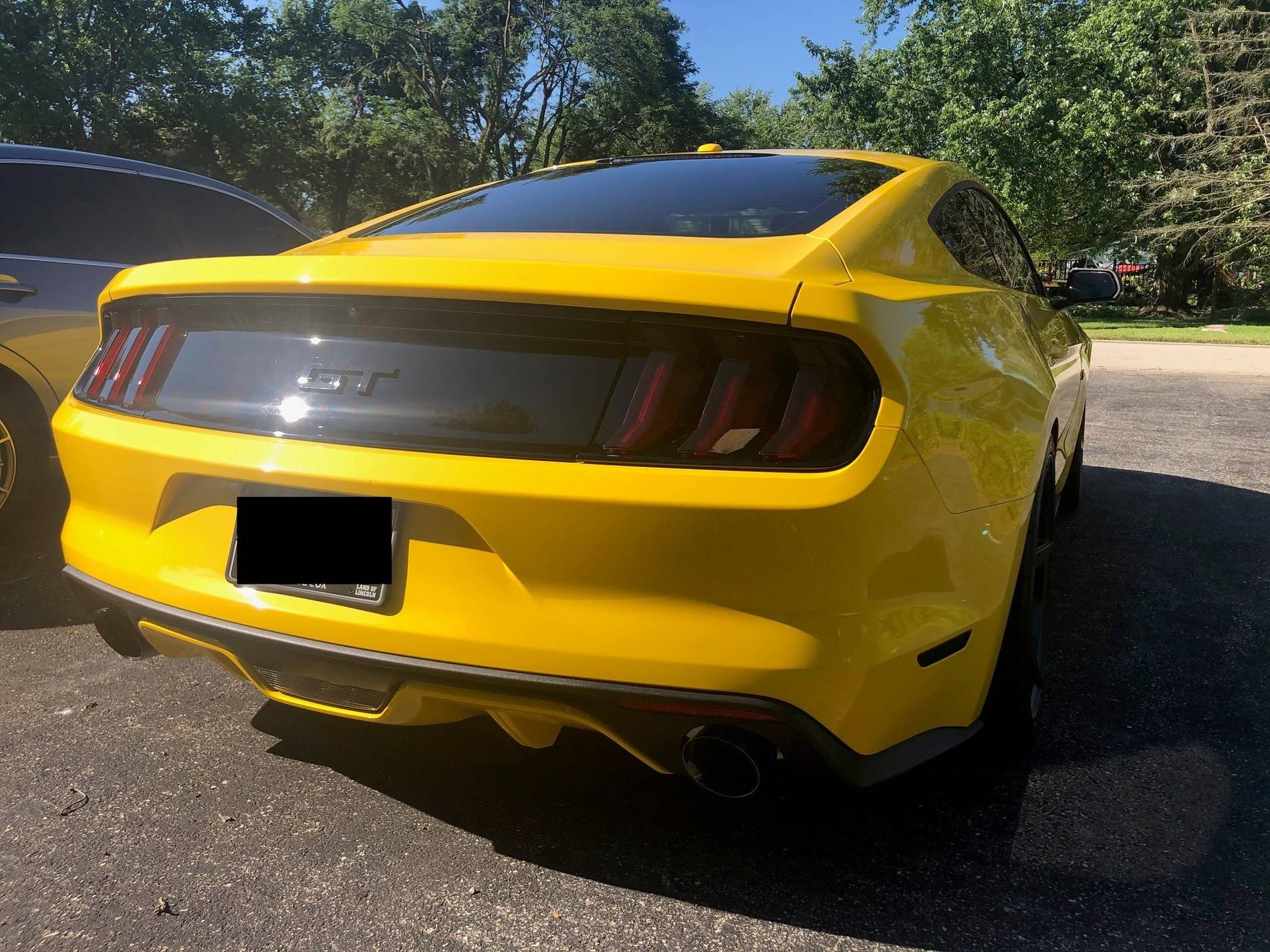

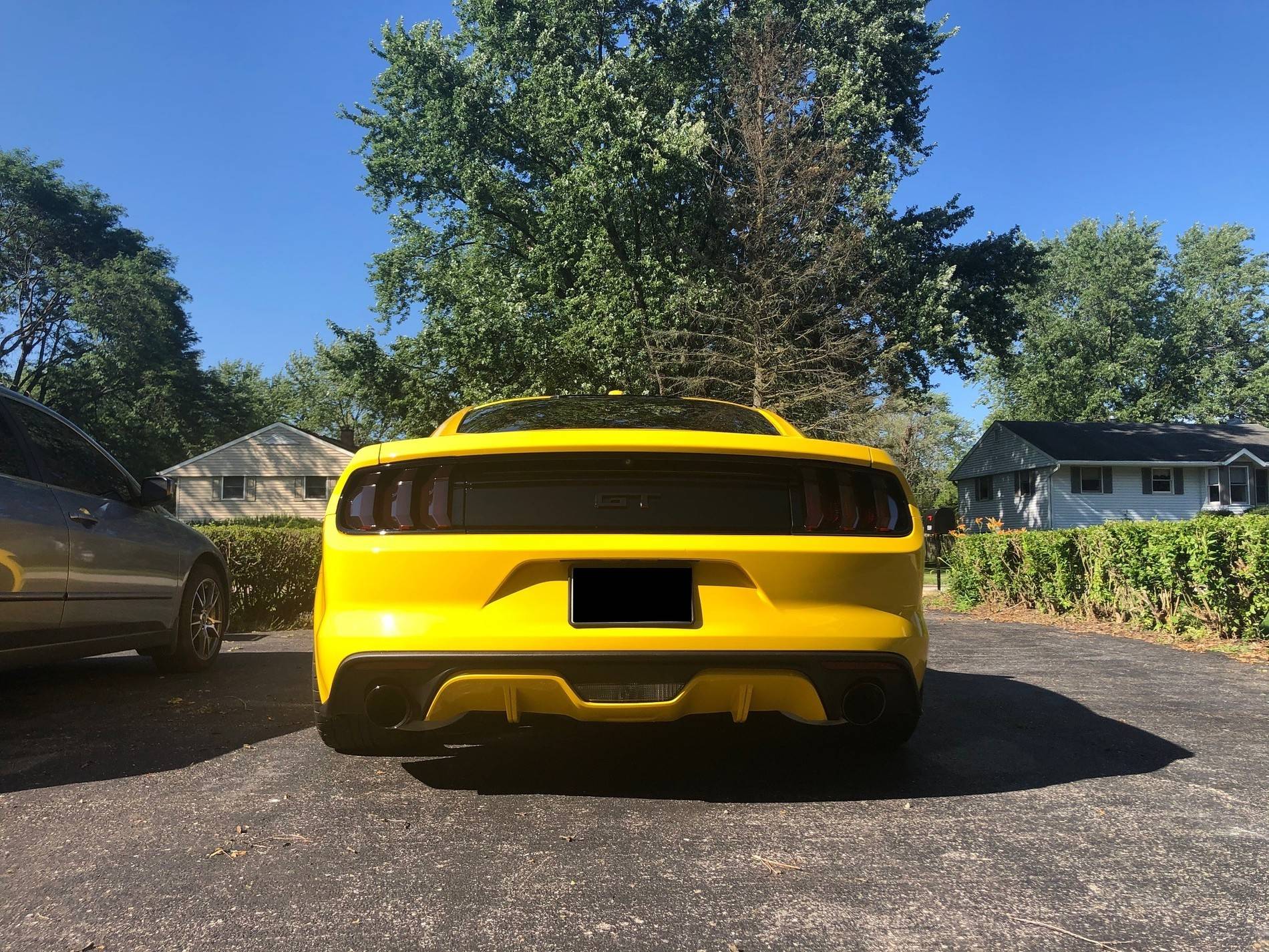

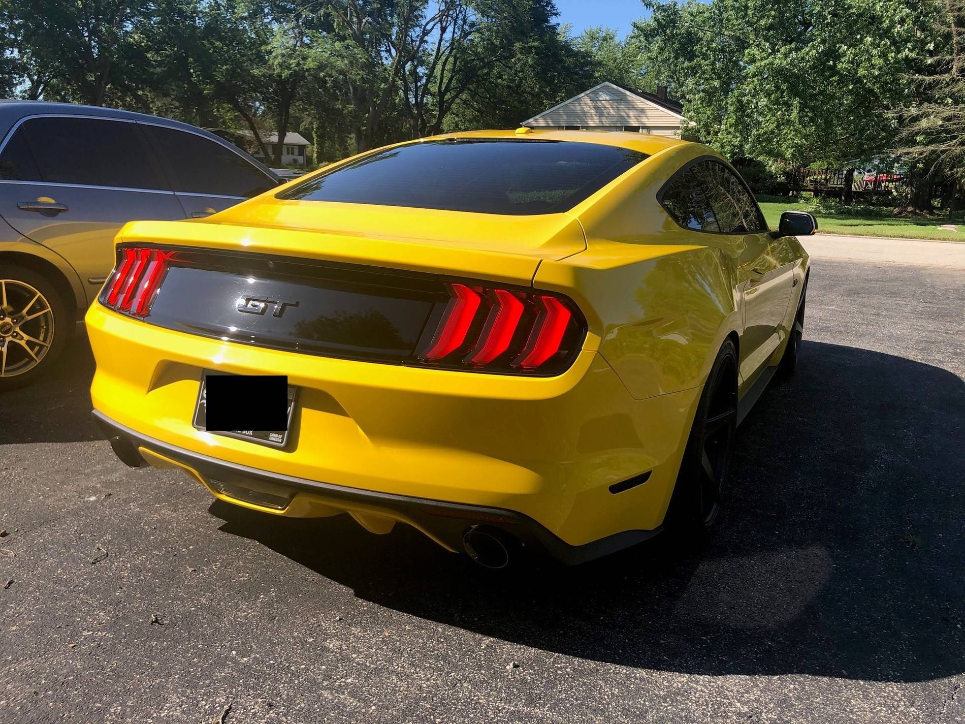

As for the color. If you like tint, go with the charcoal. It's dark, but in a good way (I like tinted tails). There isn't really any red visible when you're just looking at the tails. There is no issue with visibility of the brake/turn signal lights, as you can see in the pics. I tried to get full sun, which would be hardest to see the lights.

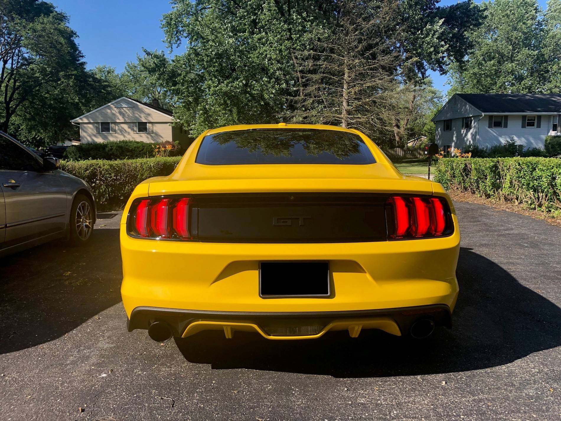

Before
https://flic.kr/p/2jkV691
After (side view) lights off
https://flic.kr/p/2jkV6aD
After (side view) brake lights on
https://flic.kr/p/2jkV69X
After lights off
https://flic.kr/p/2jkV6cs
After brake lights on
https://flic.kr/p/2jkQWpB
