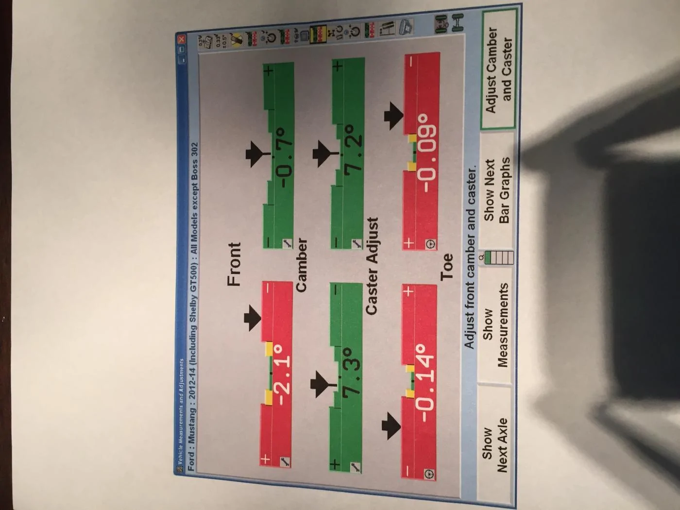

Well I just installed Streeda progressives and I'm a 20 ASE cert master tech doing alignments on the newest Hunter machine and I can tell you I needed camber bolts for mine

I have the sheets at work on my tool box. I will have to look on Monday. My car has roughly 3/4" gap on the front and rears are damn near flush on the rears. I did complete suspension while I installed the springs and have all spherical ends now and no bushings except upper camber arm. I believe this and the fact that all bolts were torqued at ride height may be why my rear is lower then what I see on everyone elses cars. I maxed my rear camber adjustment to see how much I could get close to 0 degree since I'm looking to drag race the car, I know I was only able to get -1.3 on left rear and -0.7 on right rear. I ordered spring spacers to correct ride height and will recheck rear camber. I want to say I had -1.9 and -1.8 or -2.0 degrees in the front before the camber bolts and with them I set them to -0.8 on each

I took my car for alignment after installing Steeda Progressives. The guy tells me I need to drill the camber holes in a oblong fashion or have camber bolts.
That sheet is not for an S550. 2012 - 2014 is an S197, and I think the specs are slightly different.
Whether camber correction is necessary depends on how hard you need the guy to hit the factory preferred spec in the middle of the range or if it's OK to let it run a little more negative than that. Generally, running front cambers a little more negative than factory preferred when lowered is a good thing for at least one geometric reason, emphasis as shown.
