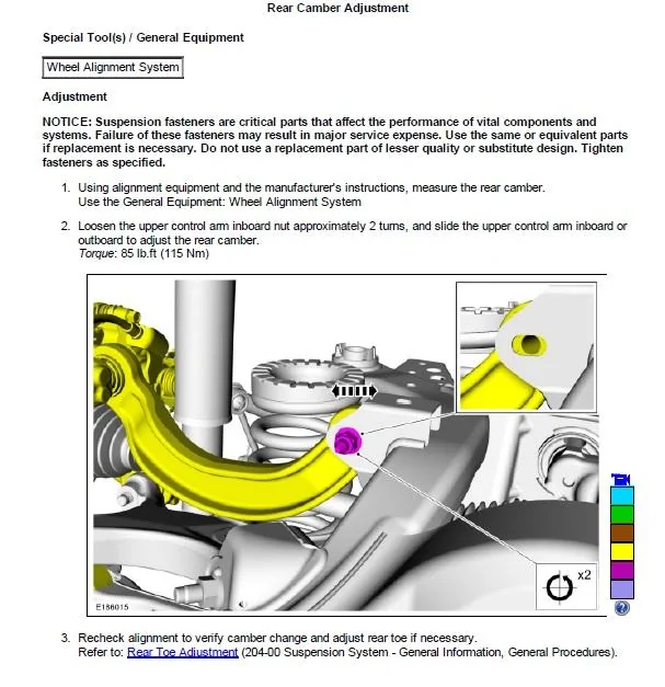

That would be my guess. There is a bolt on the IRS to adjust the Camber. Thanks to Tim Hilliard for the picture.

Rear camber is adjustable from the factory (within limits).
Front camber requires slotting the front clevis bracket hole to adjust it.
Have the shop adjust the rear so each side is the same. Regardless of what that number is. Get as close to -1.5, but if you lowered the car a lot that might not be possible.

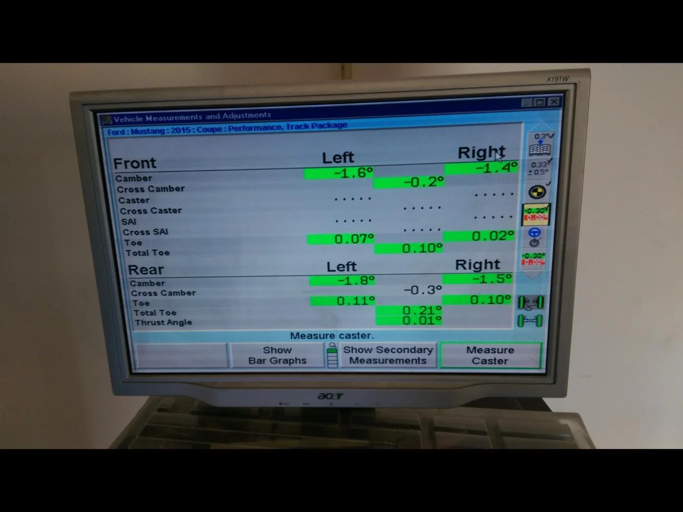

Here is a shot of my setup and it matches the picture I posted.
Camber is adjustable, within limits as stated above.
