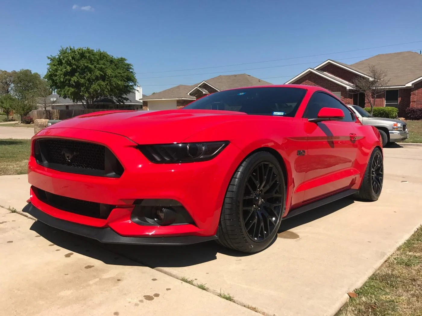

I am lowered with Steeda linear ultralite springs with 25mm spacers.
Car looks great. Does the rear tires stick out at all and does it rub? I have an 18 PP and looking for a lowered stance with a beefier look. I don't want to go to a 20" wheel, especially because I like the 19's.

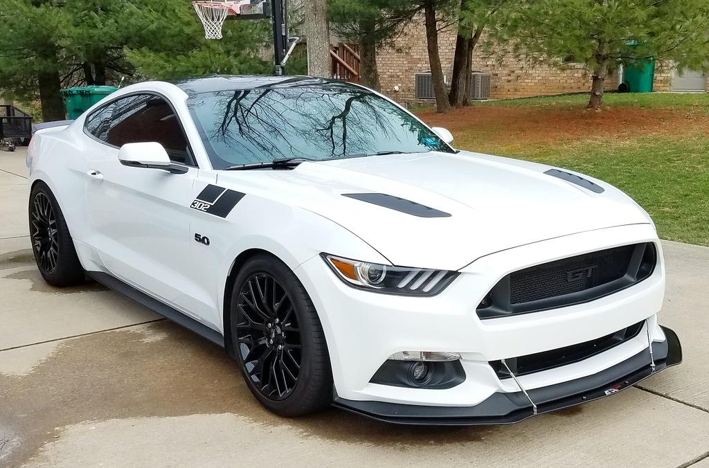

im doing 20mm rear and 23mm front.. only because im running a bigger tire on the rear, and yes ill have to trim the rear studs 3mm.. but ive seen a few and 25mm with stock camber pokes on the rear.. and i cant stand poke.. im running -1.8 rear atm with a 285/40 tire.. and from my measurements i should be dead flush no poke
im just waiting for the fronts to be made by motorsports

I'm not a spacer fan but I did order a set for just car shows until I get new wheels. I went with motorsporttech 25 front/23 rear. When I get them I'll put them on and post before and after pics! If I was planning on running spacers all the time I'd run 23/20.

I went 1" Coyote spacers all the way around on my 18 GT pp with Ford Performance springs 1" drop before getting new wheel setup. No rubbing issues.
