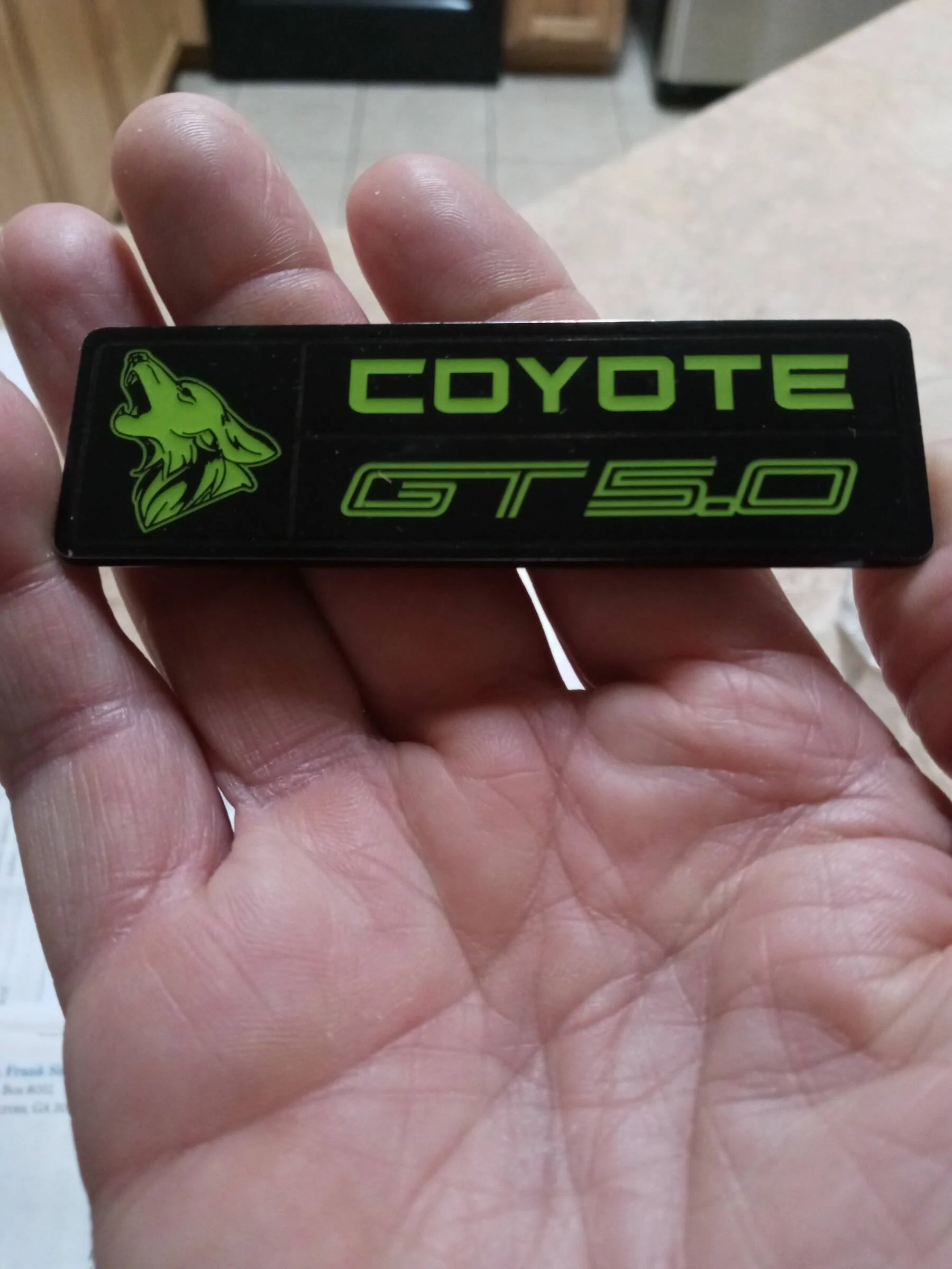

The vendors instructions say simply pry off the original with a thin blade screwdriver.......
Not working!
Anyone actually done this?
If so, please explain in detail how you removed the original.
Mine seems to be on there pretty good....

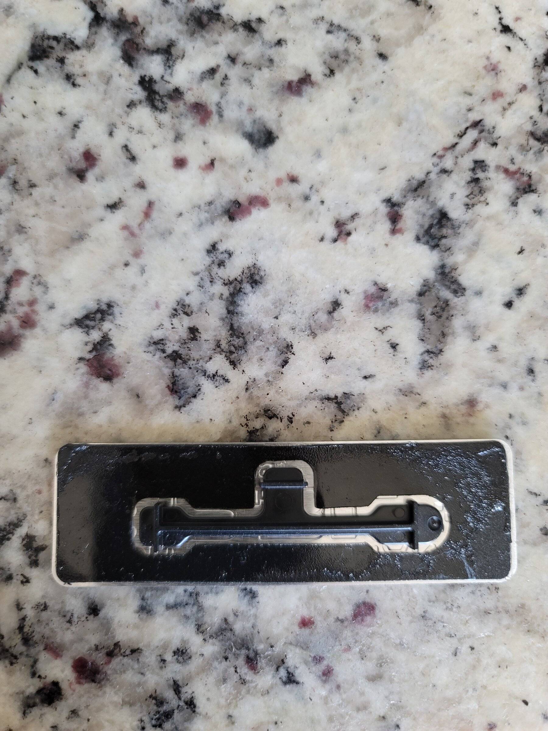

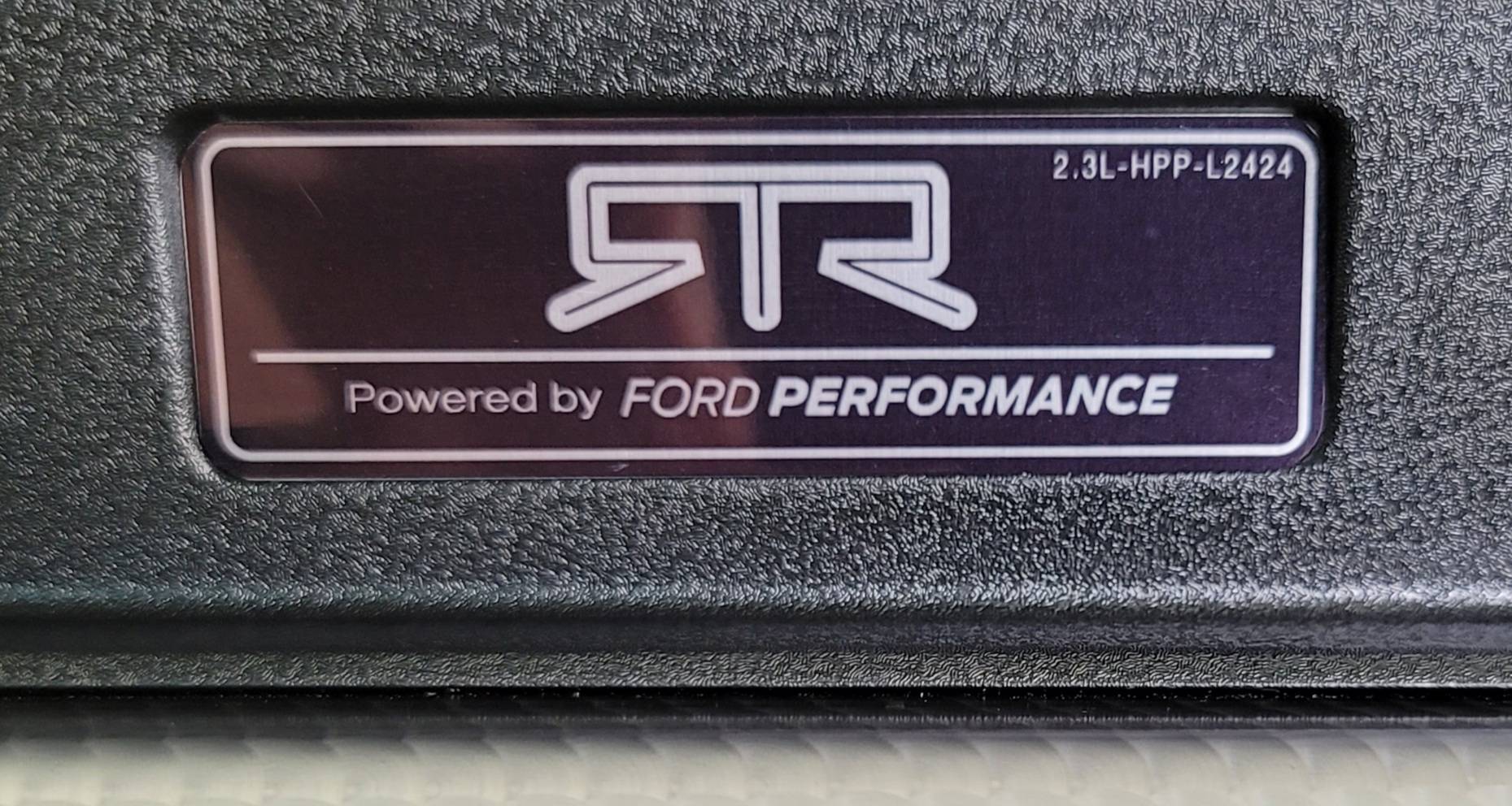

I think I used a small 90° pick tool after I heated it up with a hair dryer, came off easy! Also a 2020 but a HPP 2.3. The back is just adhesive and a guide clip. I had Anchor Room make me an RTR one.

Oh yeah, yours looks great too!
I didn't try the hair dryer last time.
I'll give it another shot!
Thanks man!
