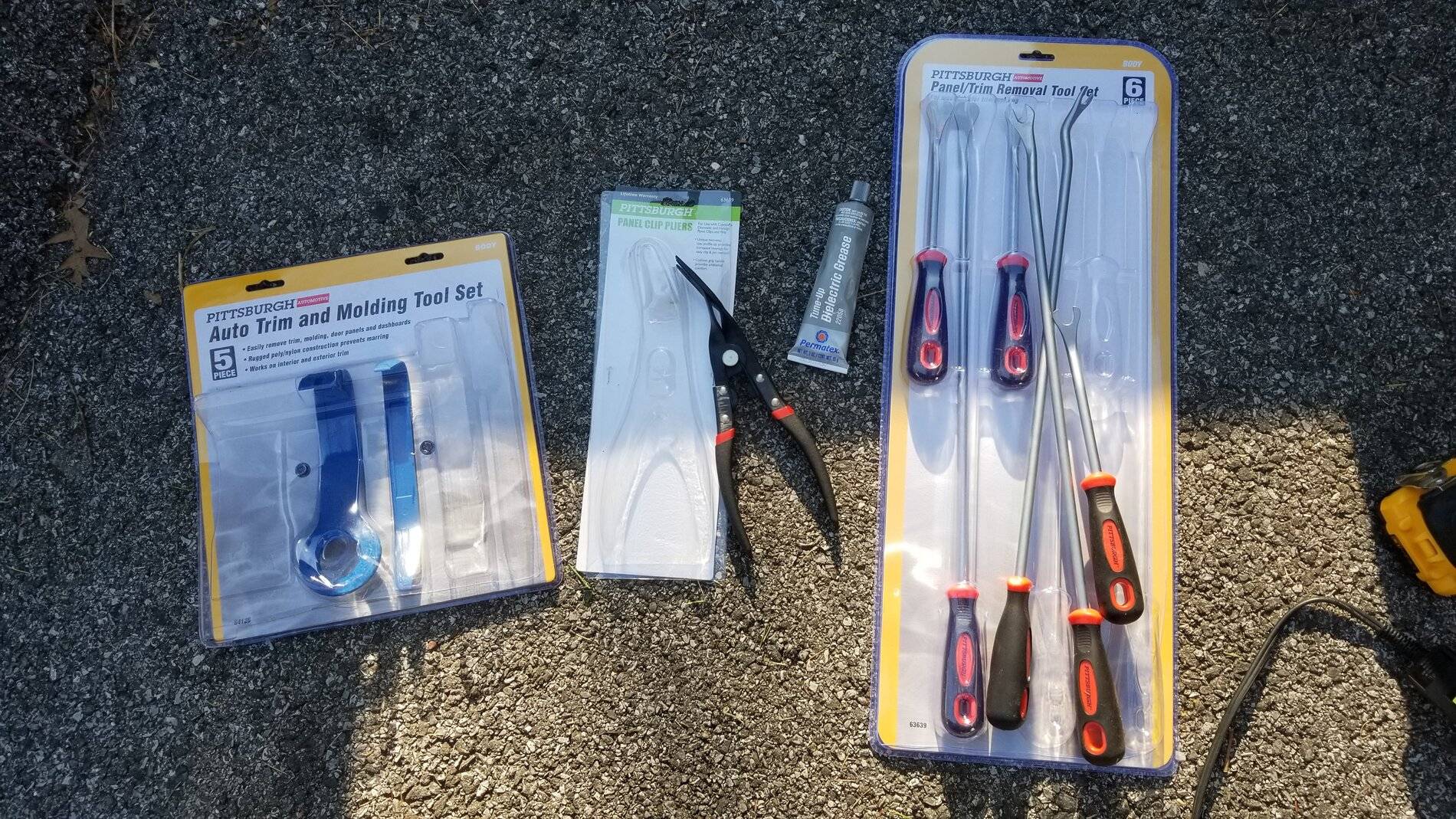

I ended up going to Harbor freight and getting these.
The dielectric grease was not from HF, I borrowed it from my 13 year old who got it for his keyboard construction project. I think I initially got it for him from Autozone).

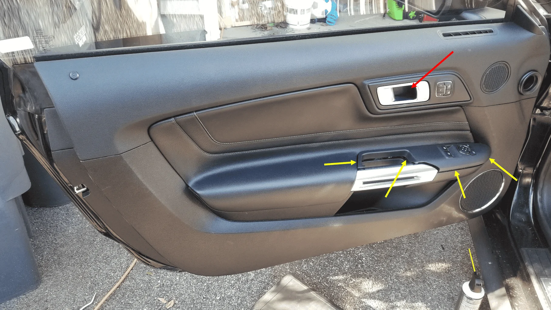

1. Using plastic pry tools, pry up on where the yellow arrows are, to pop out the switch trim.

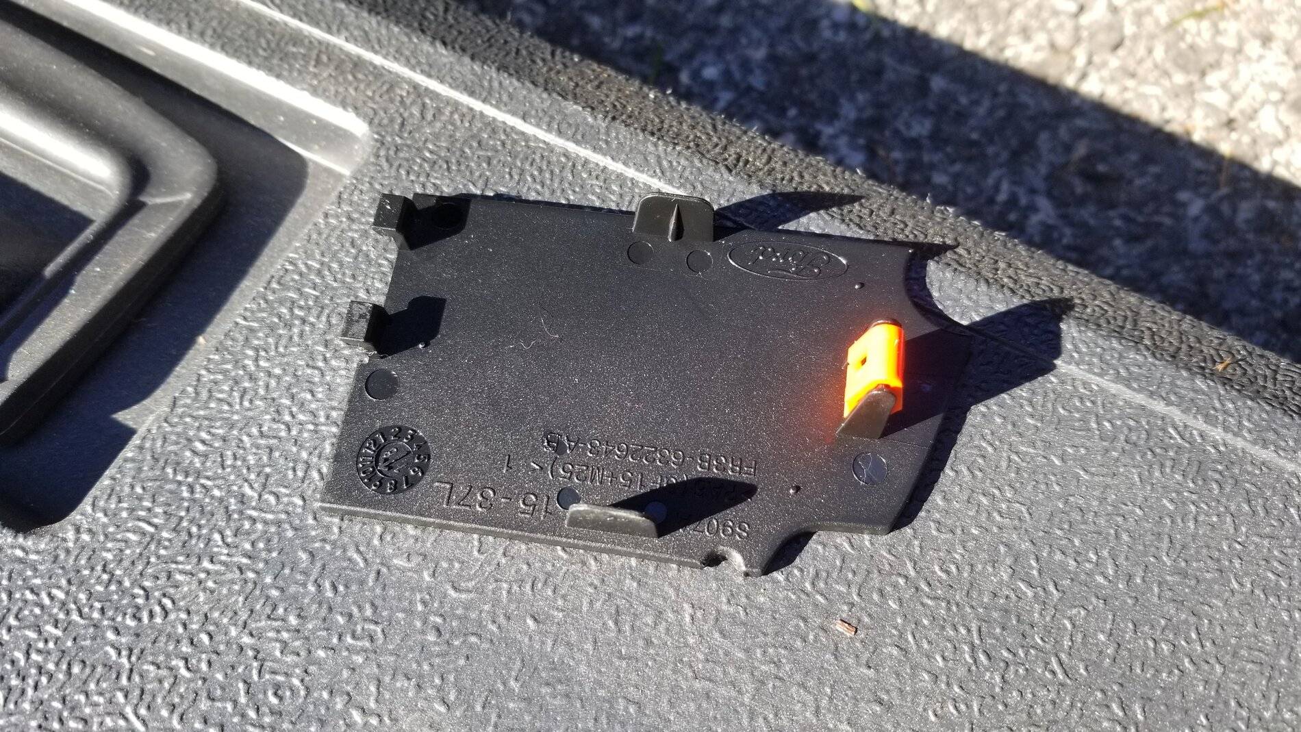

2. Open the door handle, and while holding it open, use a pick to pull out the back plate (there is a hole on the top corner).
What the plate looks like on the back.

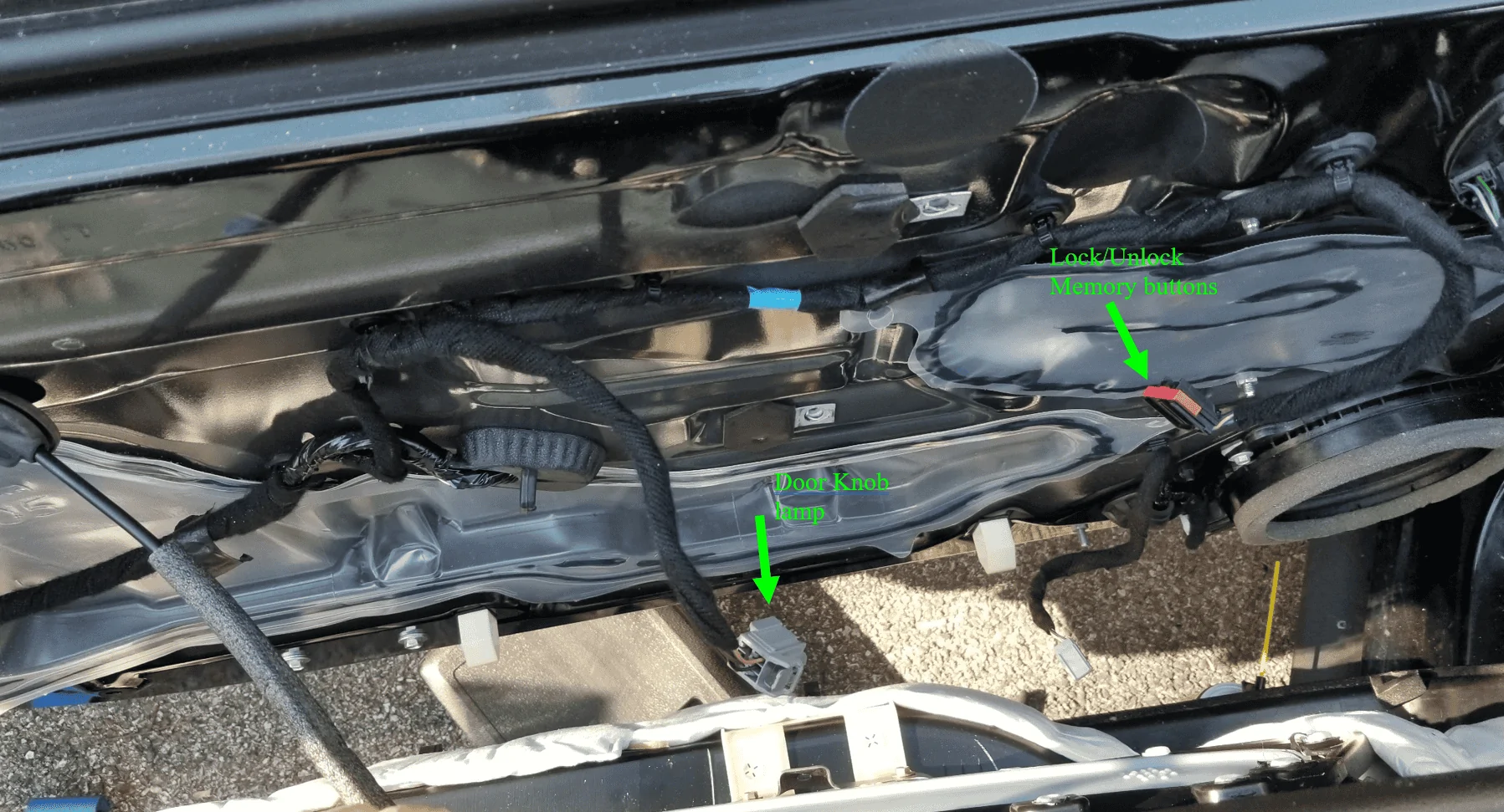

4. disconnect the lock/unlock/memory harness and the door knob light harness (green arrows below).
If you can dislodge the door handle cable, you may do so, but I didn't want to break the plastic clip holding the cable, so I just let the door panel hang.

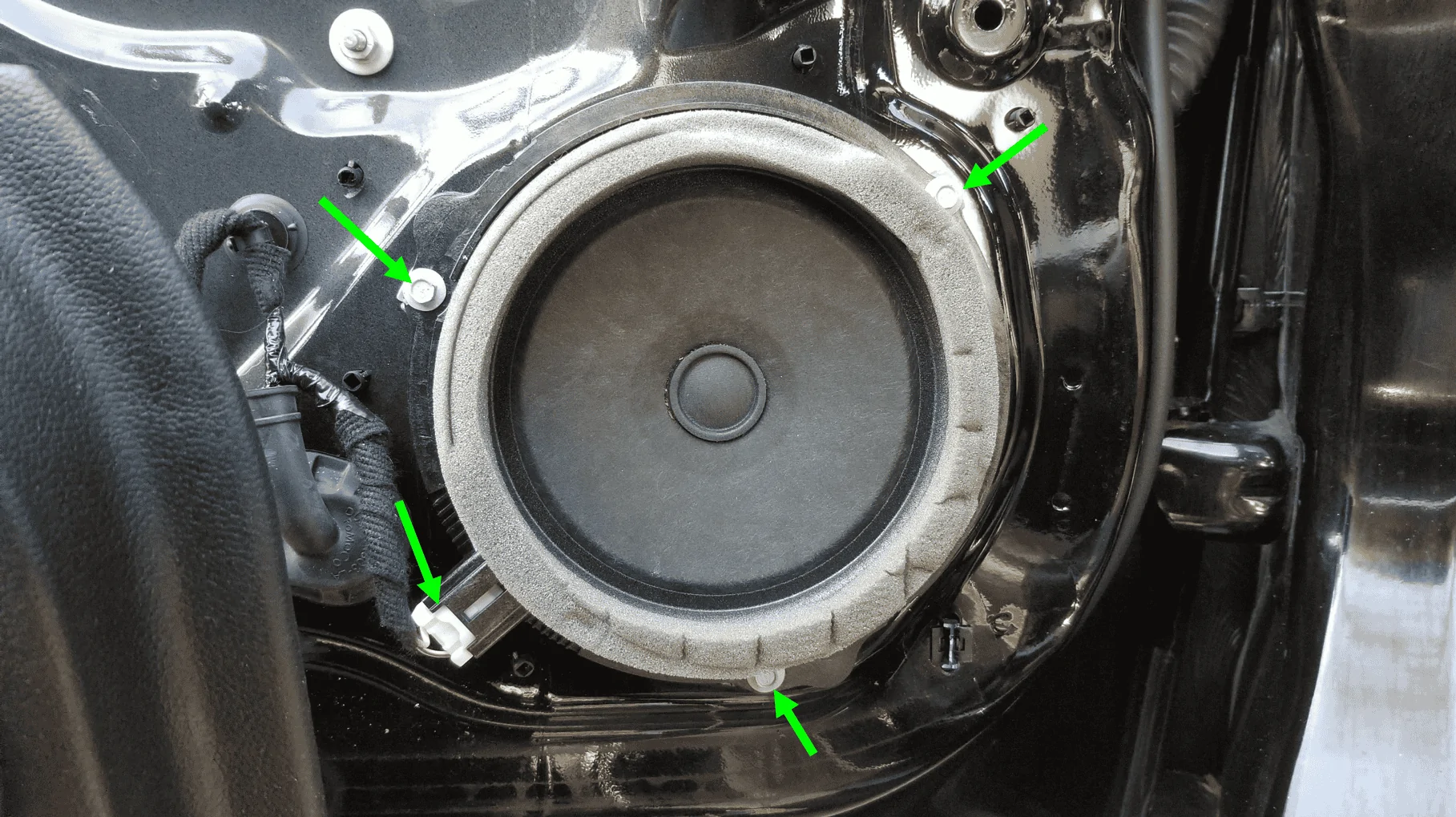

6. To get best access to the harness, it's best to remove the door speaker. Remove the three screws (green arrows) and unplug the speaker harness (green arrow below ).

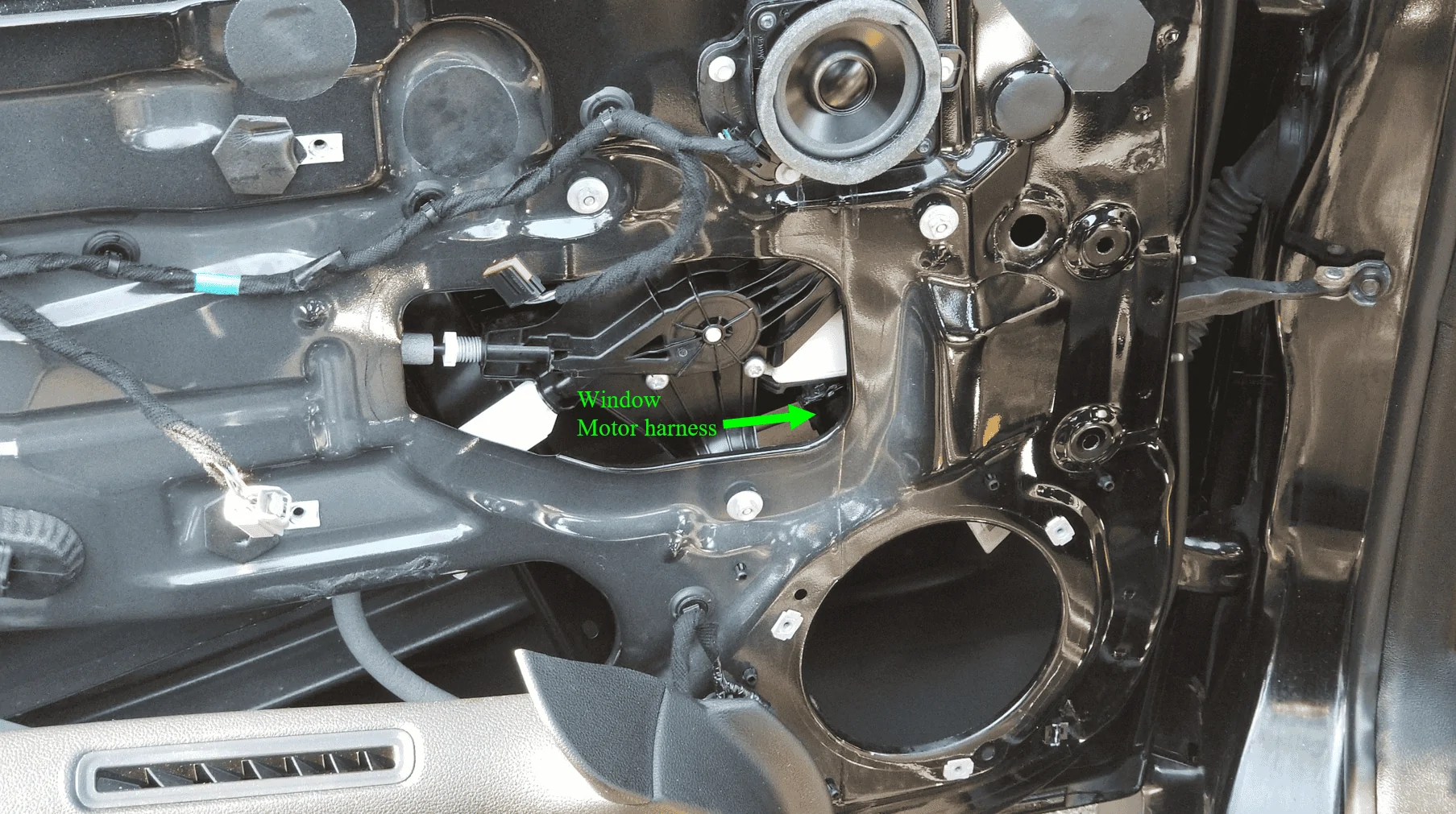

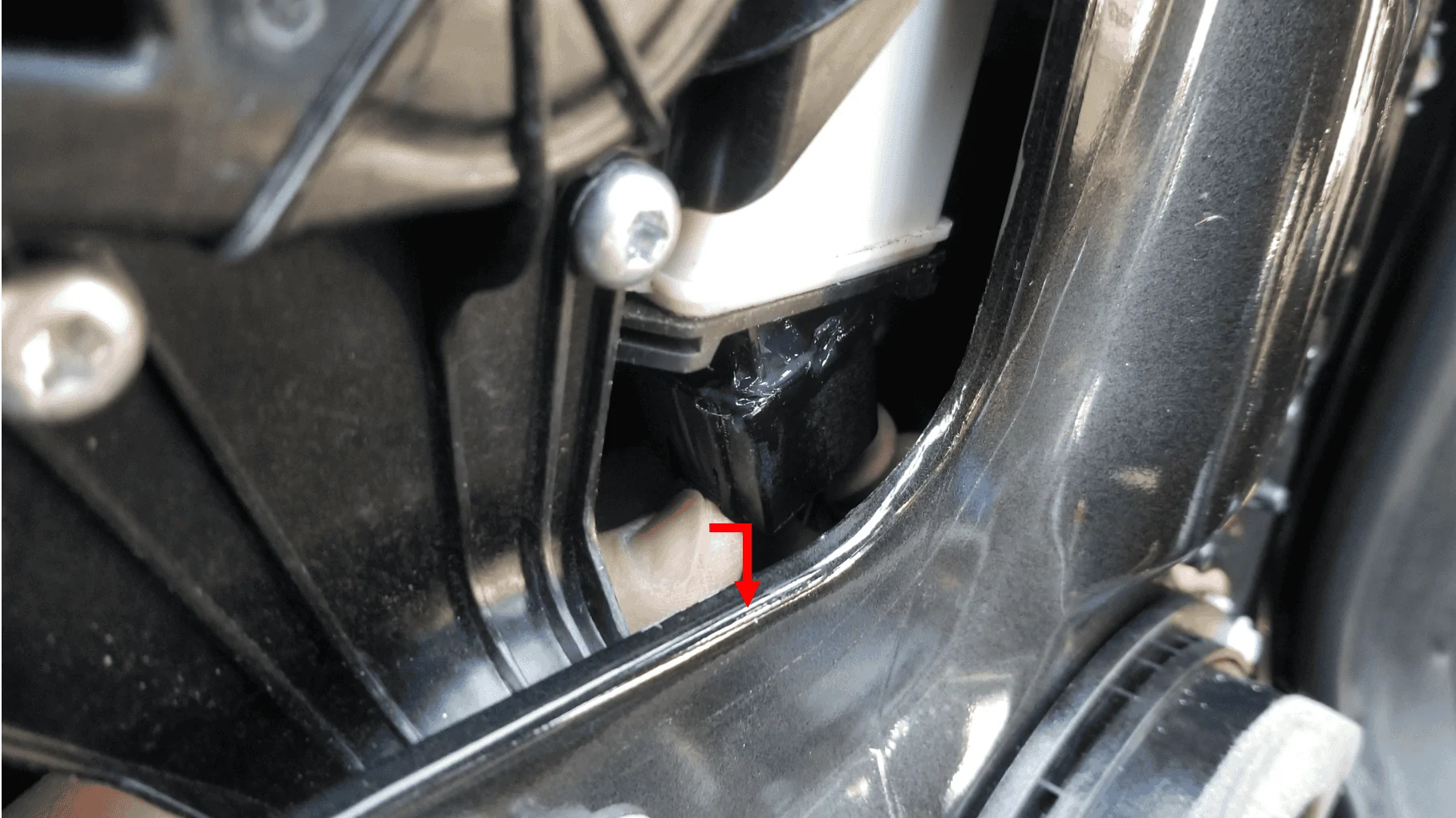

7. Window motor harness is behind the upper vapor barrier (green arrow below).

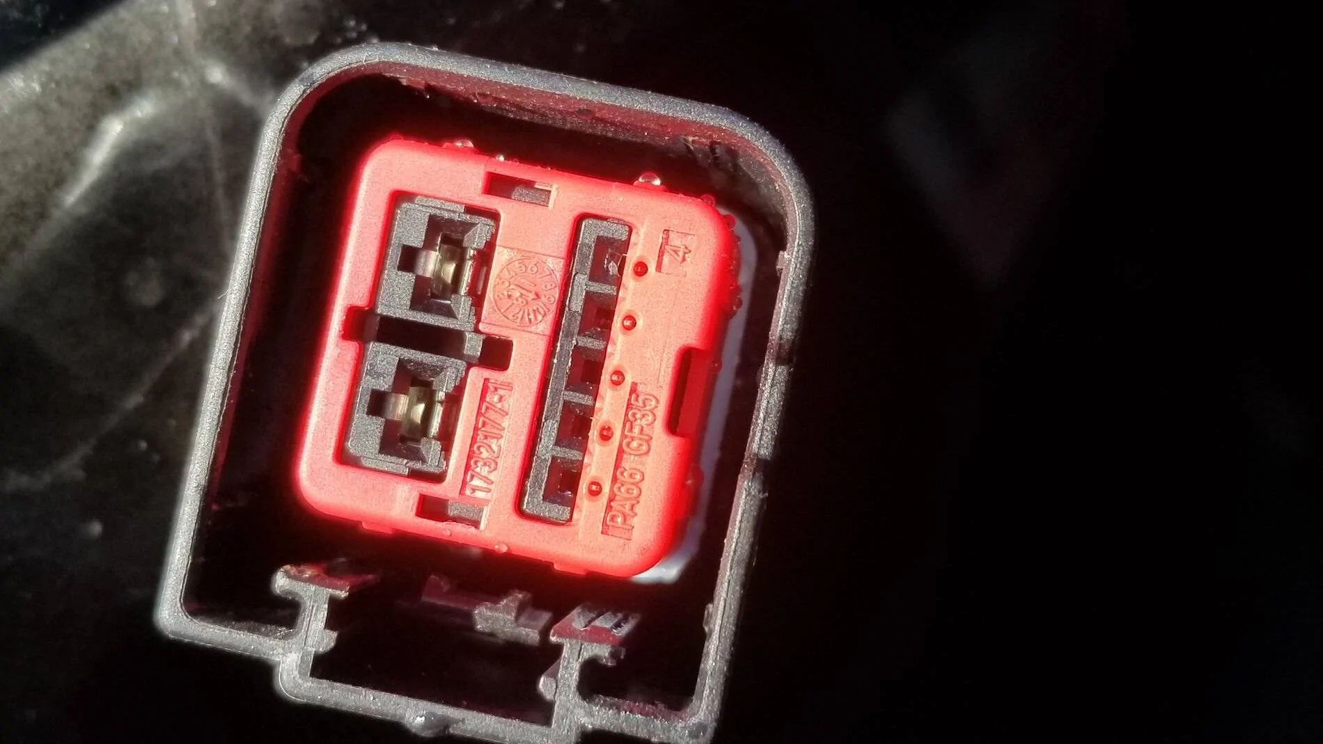

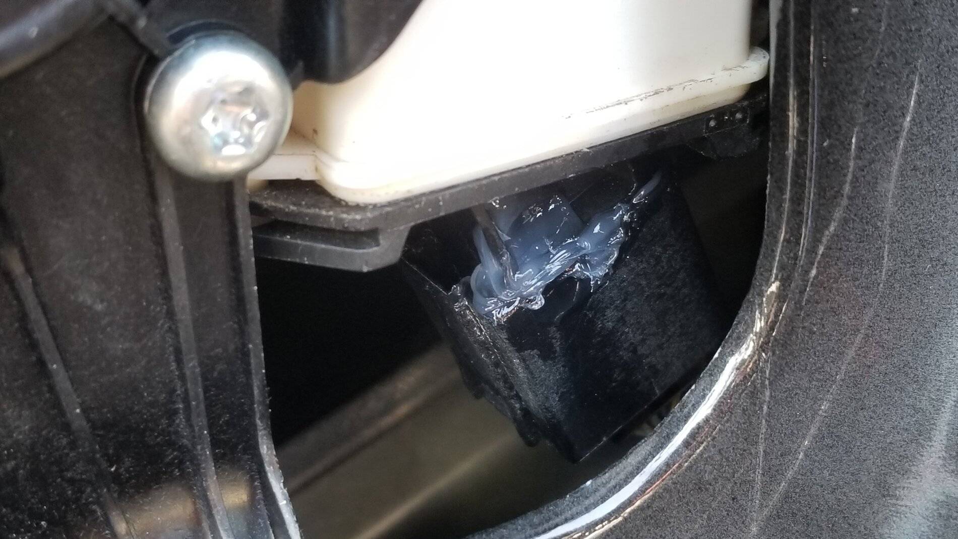

8. I took this photo at the end because I wanted to show how to remove the plug so please excuse the finished dielectric grease. to remove the harness plug, press in on the lower tab, and pull the harnedd straight down.

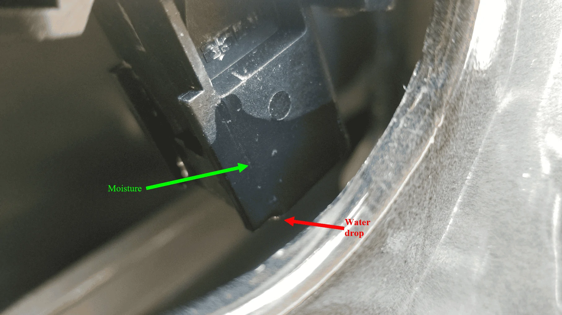

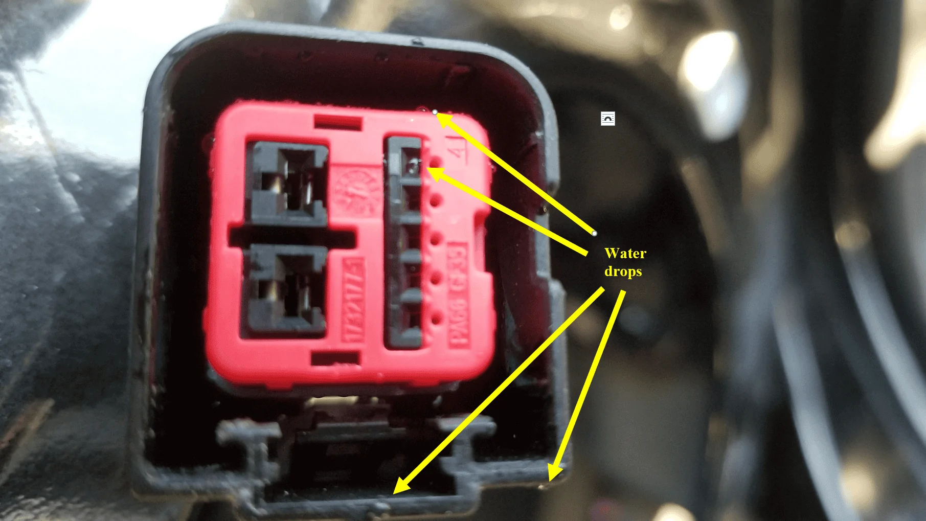

9. This is the motor end of the plug. Notice it is dripping wet with water.
10. the harness end of the plug with water after the harness was pulled through the speaker opening.
when I tilted the plug after removing it, a lot of water just poured right out.

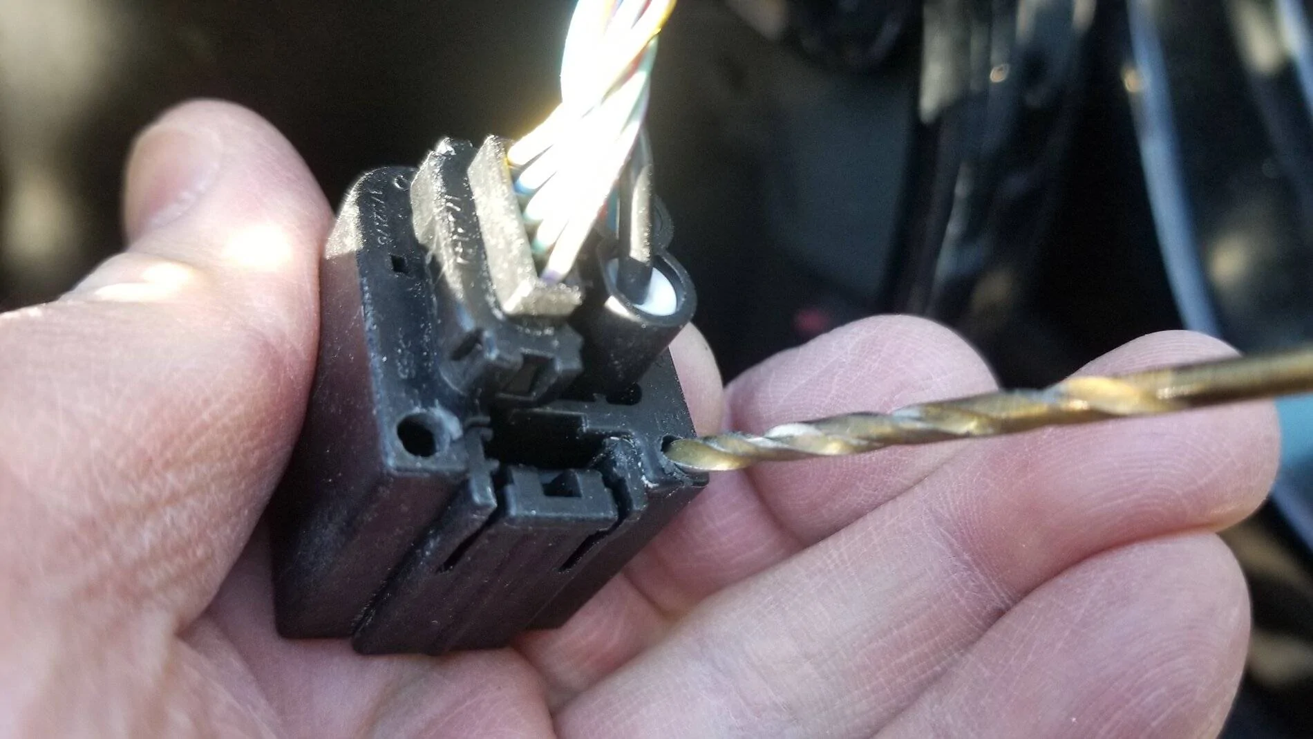

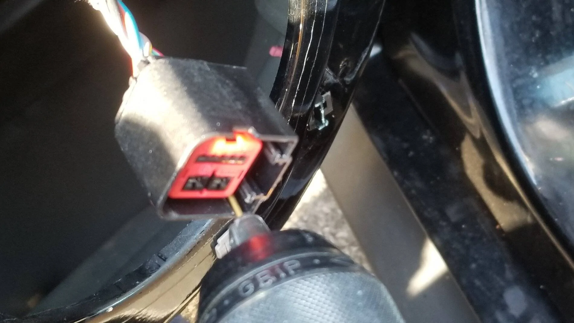

11. I decided to add some drain holes on the harness plug. Drilling with 1/16th bit.

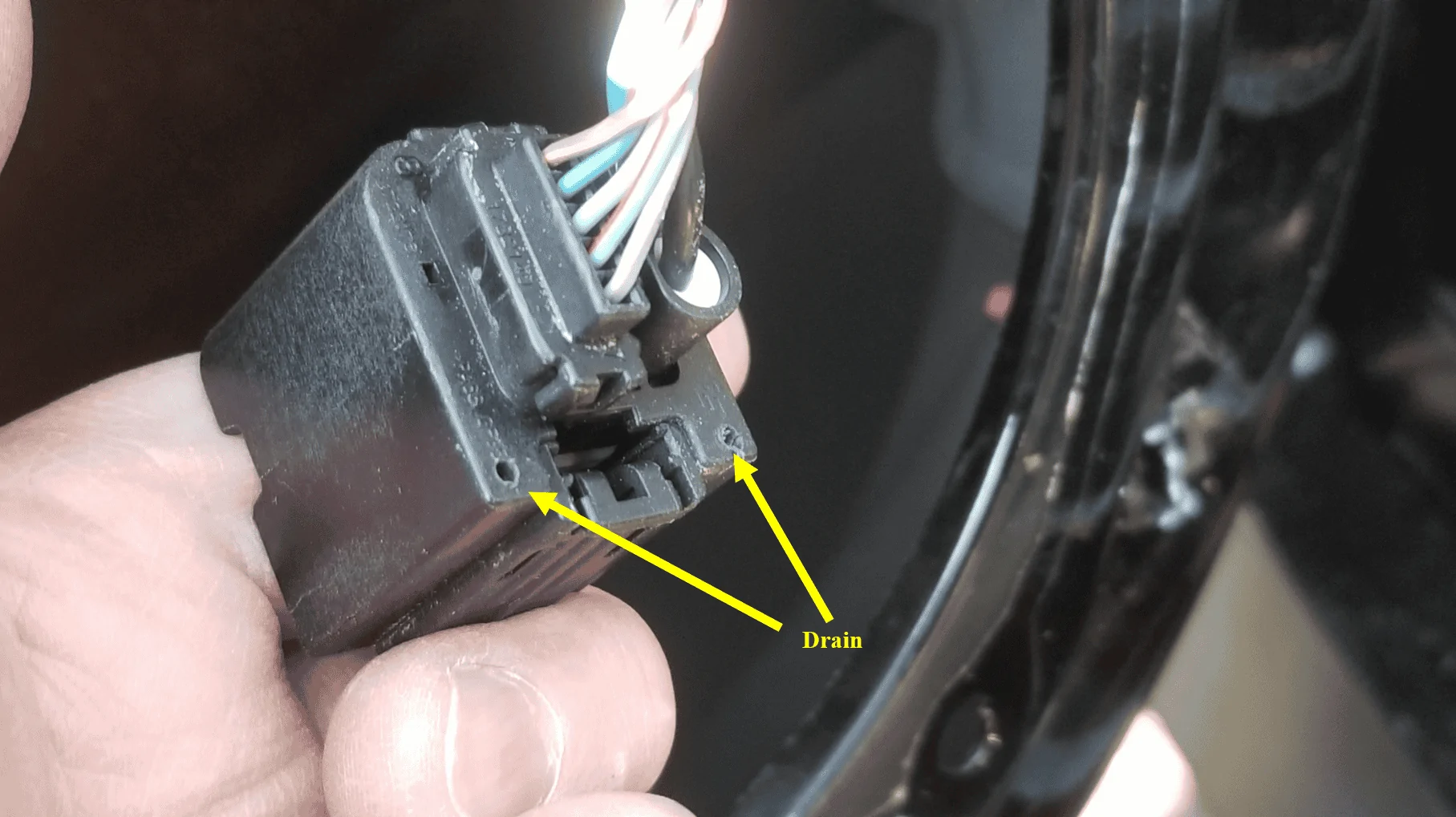

the back side of the harness
I decided to enlarge the hole with 1/8 in bit

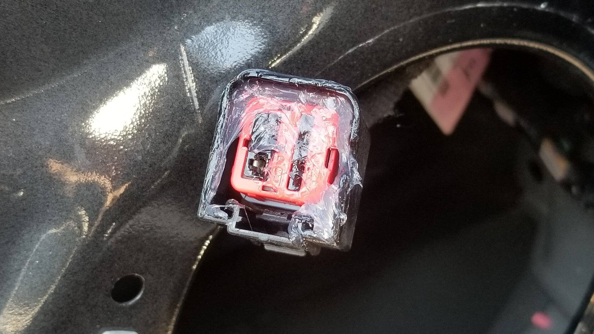

12. packing dielectric grease in the harness plug. I packed it like I was packing wheel bearings.
13. the reconnected harness with dilectric grease oozing out.
It was low 30's while I was doing this, so I haven't tested it.
It will be in low 40';s tomorrow, so I will test this out by using my harbor freight electric pressure washer to wash my car tomorrow.
