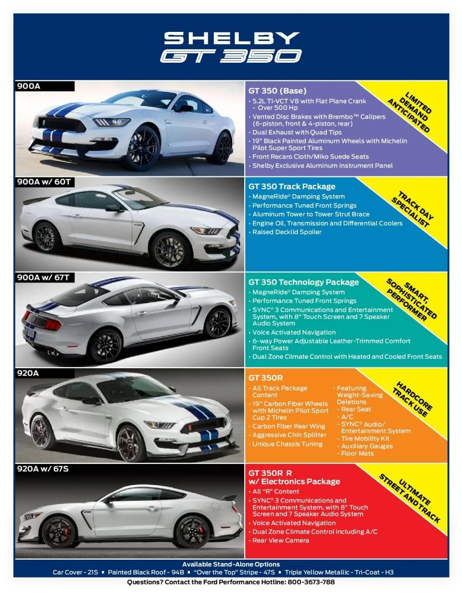

Track pack and tech pack cars both have the magneride, only base cars don't.
I believe that is not true. I think 2016 Base and Tech pack cars did not have Magneride. Only Track packs and Rs. My buddie's 16 Tech does not have it. FWIW
It is a great option and it really works well. Awesome tech.
Edit: Was looking for this. I am wrong and you were right. Only bases did not have it.
