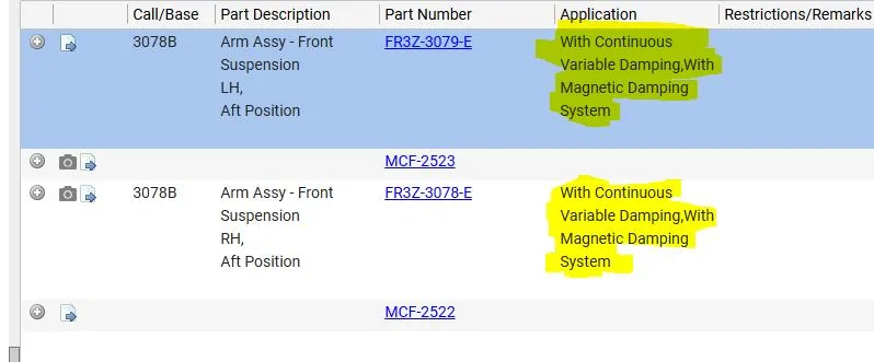

As per the Ford Parts catalog it shows the following part numbers for the control arms:
LH AFT: FR3Z-3079-E
RH AFT: FR3Z-3078-E
Also these show in the catalog to be for magnaride they are 100% for the car!

Good Evening Trey!
The forward ones would be the following:
LH : FR3Z-3079-H
RH: FR3Z-3078-H
Happy to hear you ordered with us in the past! PM me if you choose to order with us and i can supply a discount code!
