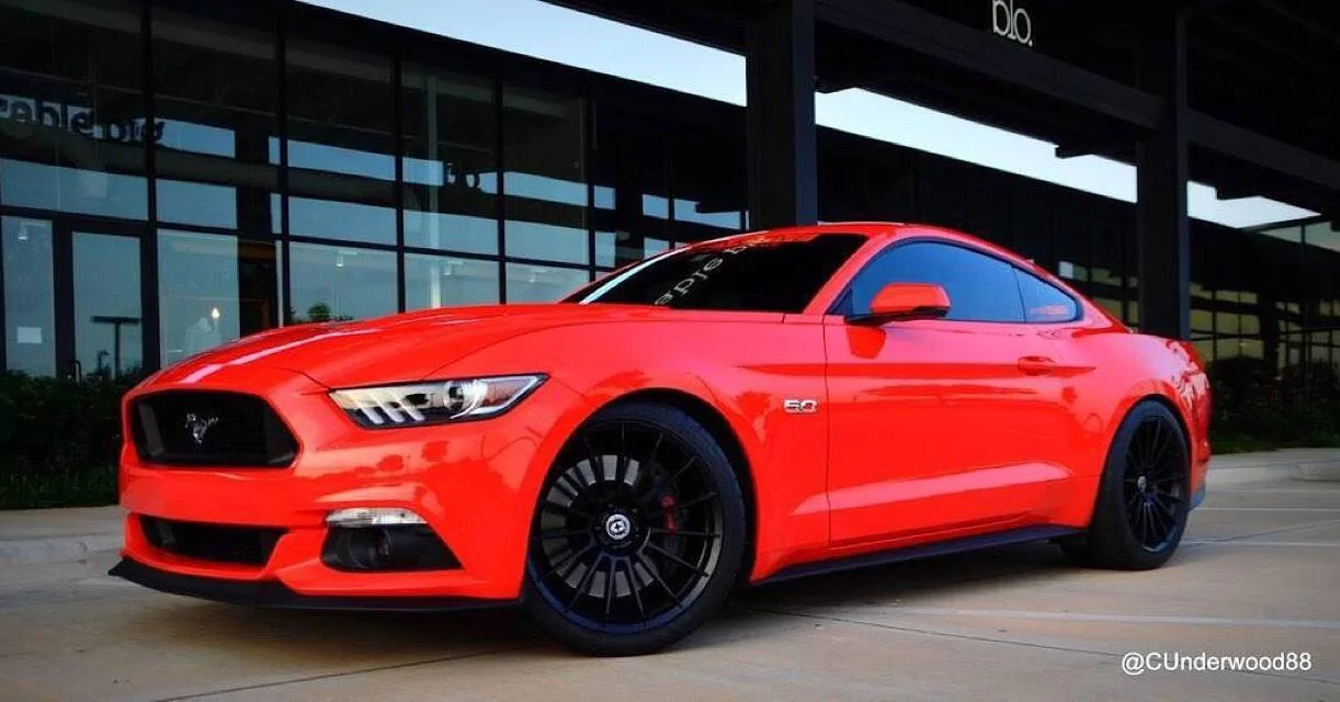

I run the FF15s 20x10 and 20x11 wheels on my car. I personally think the car handles better and rides the same as stock since my tire height is the same as stock. My wheels and tires weigh less than the performance pack wheels and tires which took about 25lbs of rotating weight off the car. Plus they look badass! Hope that helps.

Looks- fills the wheel well a lot better. I think 20's look best on the S550 of all the wheel sizes.
Tires- you ca get a lot wider tires on 19/20s than most 18s. 20s are also a more common tire size to be able to find than 19s (and sometimes cheaper in the same size as a 20). More tire width=more traction.
Weight- You can get 20s in the 23-28 pound range. The PP 19s are 35lbs and I believe the OEM 18s are 32plbs. So you can can a better look with more wheel and a much wider tire with less weight per wheel.

no because we run 20s on this car with alot of meat. this whole "20 is rough" crap is from cars with 20,25 or less series tires on a 20" wheel. there was literally zero difference in ride quality going from 19" pp to 20s to me.
