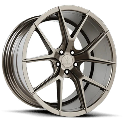

im curious if these 2 would fit the front 19X9.5 +38mm 20x9 +38mm im considering this wheel
lex101 Well-Known Member Joined Apr 15, 2015 Threads 7 Messages 68 Reaction score 11 Location houston Vehicle(s) 2015 mustang gt May 27, 2015 Thread starter #1 im curious if these 2 would fit the front 19X9.5 +38mm 20x9 +38mm im considering this wheel Sponsored
Need4SpeedMotors Well-Known Member Diamond Sponsor Joined Nov 17, 2014 Threads 194 Messages 21,557 Reaction score 5,143 Location Los Angeles, CA Website www.n4sm.com First Name N4SM Team Vehicle(s) S550 Mustang & Shelby GT350 platform May 27, 2015 #2 On the GT it will work on the GT PP the 19" wont clear the front calipers. Let me know Ive done a few setups with there wheels and am a authorized dealer def can help you out with fitment and package pricing.
OP OP lex101 Well-Known Member Joined Apr 15, 2015 Threads 7 Messages 68 Reaction score 11 Location houston Vehicle(s) 2015 mustang gt May 27, 2015 Thread starter #3 ok so the 20s with the PP brembos will fit? even with that offset?
Need4SpeedMotors Well-Known Member Diamond Sponsor Joined Nov 17, 2014 Threads 194 Messages 21,557 Reaction score 5,143 Location Los Angeles, CA Website www.n4sm.com First Name N4SM Team Vehicle(s) S550 Mustang & Shelby GT350 platform May 27, 2015 #4 lex101 said: ok so the 20s with the PP brembos will fit? even with that offset? Click to expand... Fitment for the GT PP I would recommend the following 20x9 Et 30 20x10.5 ET 45 Sponsored
