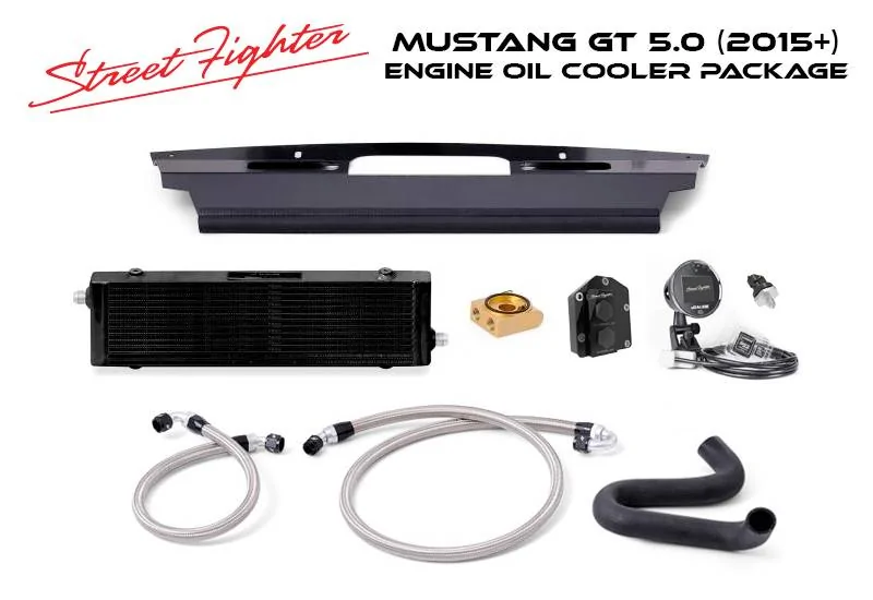

Streetfighter finished development and are in production of our engine oil cooler upgrade package for the Australian Mustang V8.
The Australian delivered Mustangs have been known to experience external and internal, oil and/or coolant leakage of the standard OEM engine oil cooler.
We expect both the Streetfighter Engine Oil Cooler Package and Streetfighter Oil Pressure Monitoring Kits to be ready for release before end of 2017.

Hi
We are utilizing the Mishimoto bar and plate cooler and lines along with our own Streetfighter manufactured by pass manifold to perfectly suit the RHD Australian Mustang.
We have several vehicles that have our development kits on. They have been 100% perfect on road and track.
The radiator hose is part of the kit.
You can obtain all spare parts from Streetfighter directly.
No parts are in contact with coolant/ or water. It is a oil-air cooling system.

What exactly is not compatible between the RHD and LHD? Rather than just a marketing words and taking advantage of people none wiser.
The LHD Mustang has the engine oil cooler housed under the oil filter.
Due to the steering box being on the opposite side on the RHD models, there was no room to have the oil cooler under the oil filter. Instead the oil cooler was relocated towards the LH rear of the engine block.
The RHD oil cooler is a completely different design and has been known to fail.
Imported oil cooler kits , eg Mishimoto do not have the extra components to delete the RHD oil coolers therefore there is still a problem that the standard cooler can fail.
Stretfighter have manufactured a 100% Australian made by-pass manifold that compliments the kit and serves as a total solution for the RHD cars.
In regards to marketing words and taking advantage, all we are doing is creating a solution for the Australian Mustangs to meet an known need and letting people know about it. If this is taking advantage , my apologies, you have the choice to ignore it.

Just curious, why is one of the radiator hoses replaced for an oil cooler kit? Is the OEM cooler water cooled and comes off this hose?
Streetfighter Mustang
Aug 2, 2015
58
438
320
Australia
www.streetfighter.net.au
David
2015 GT Mustang
Correct. We delete the oil to water cooler and replace it with a more efficiant oil to air cooler.This requires a new bottom hose.
