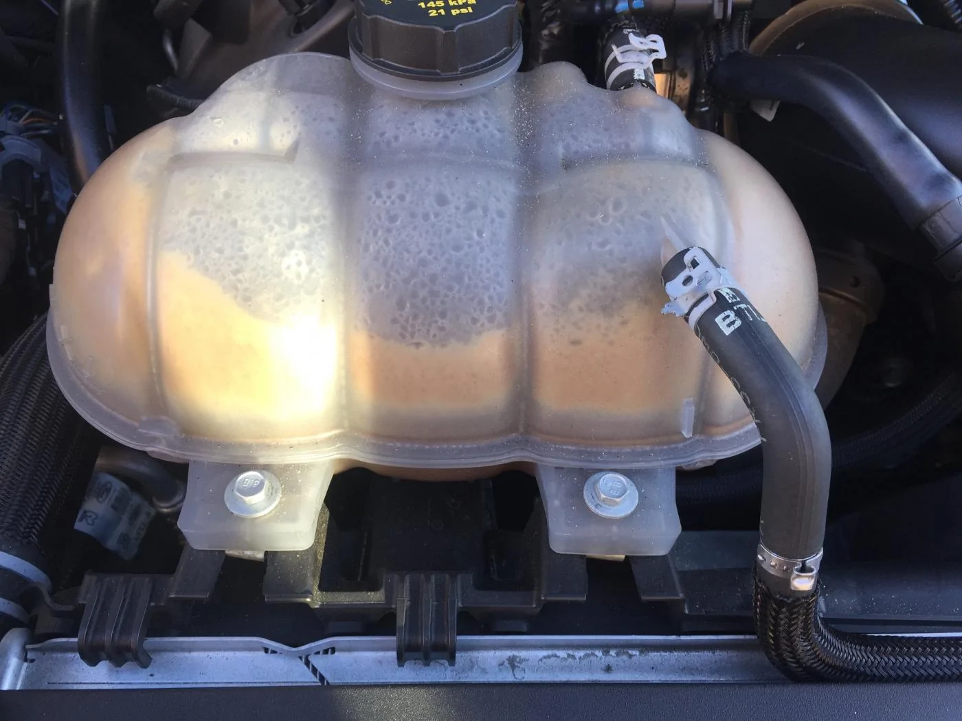

Hi Guys
Can you please give me some advice. I had my first service on my 2015 mustang GT in January since then I have noticed my coolant has started to go a watery milky brown cooler (I think it was pink before) i…..I’m worried as looking around the web, people are saying it could be the head gasket which is not good at all?
Could you please have a look at the pic below and let me know if I worrying for nothing or do I need to get it into the garage quickly.
Thanks in advance. Alan

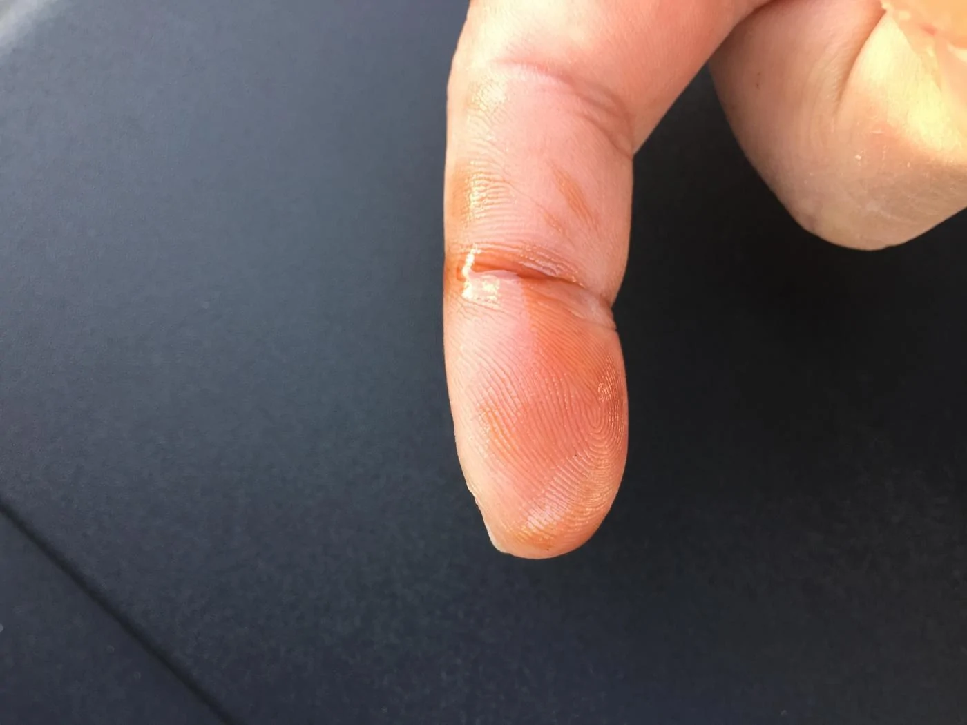

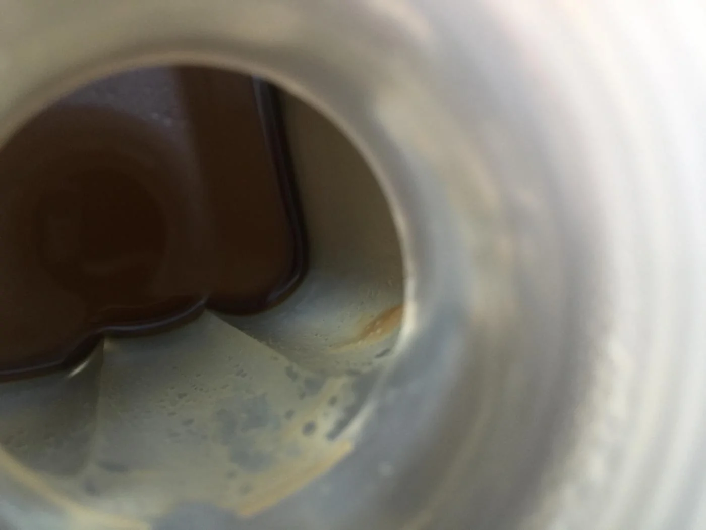

just quickly to check take oil fill cap off and run your finger around the inside under the lip edge of where the cap goes in.
does it come out looking like brown cottage cheese ?

Get that looked at ASAP. Get Ford to arrange recovery from your Ford assist. To be on the safe side ;)

That ain't right for sure! Back to Ford ASAP if it were mine.

That does NOT look good :(
Sorry to see this.....I'd definitely get onto your dealer ASAP. Good luck....and keep us posted.

That's sure as heck not right... maybe another faulty oil cooler like [MENTION=13598]Gibbo205[/MENTION] had, or worse... Get ford on the hook for it asap.
Speaking of which, i'll check my coolant when I get home.

The oil side look all clean. But will book it in. Thanks guys

Looks like water and oil mixing. Suffice to say, that ain't kosher. Good just be the beginning of a major problem.

Probably another leaky oil cooler.
Seen a few times on the forum now.
