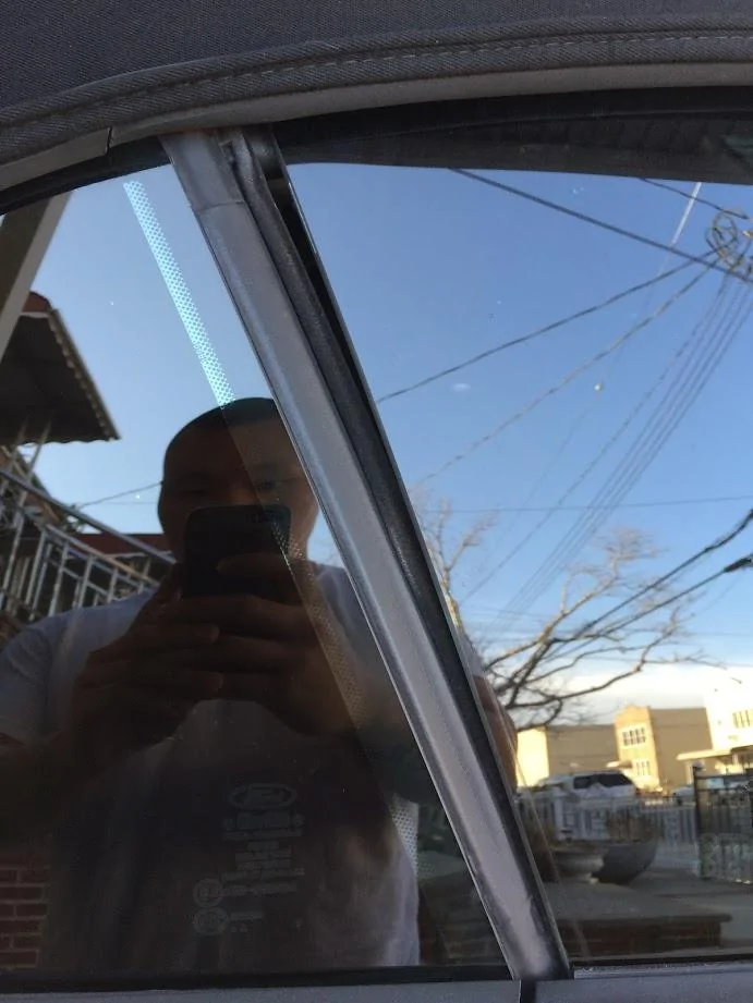

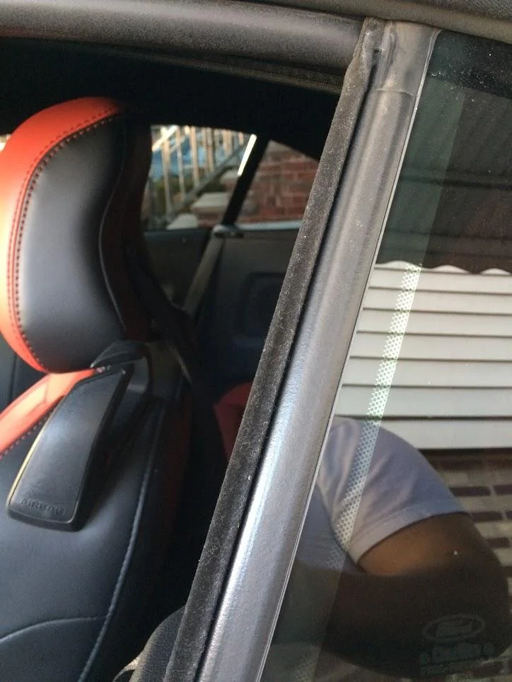

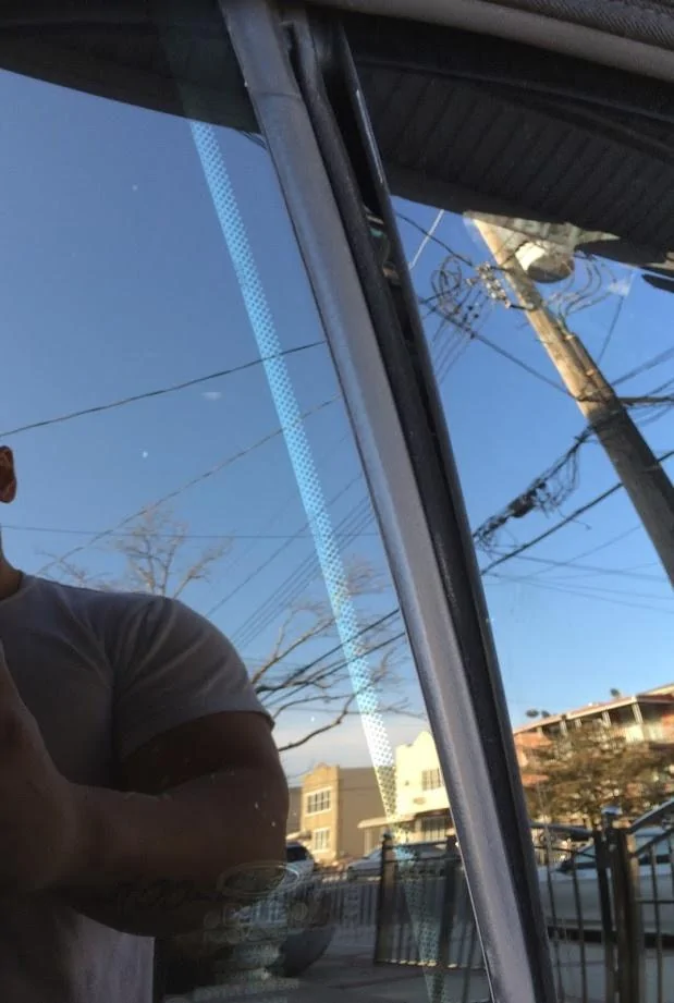

I've noticed this on and off and I finally got a photo of it. Sometimes it looks like the glass is out of place or the motor isn't pushing it all the way up. I'm not sure if this is just a convertible problem. When it doesn't close all the way even after trying a hundred times, I would have to push it up by hand.
Anyone else have this issue?

Having owned convertibles in the past - to me, it looks like the window is either not following the track, which could have something to do with the guide rollers or the window tracks have become detached from their mount points. If the tracks are loose, when the window motor is in operation, it could torque the track which would cause misalignment.
Question:
When you have the top down, and put up all of the Windows, does the same thing happen, or do the rear 1/4 windows match the fronts without issues? If they are aligned and match the fronts without any issues when top is down, the the problem lies within how the top is coming in contact with the rear 1/4 windows. It could be that the window is getting stuck or can't smoothly close as it should if it's binding on the top.
I would take it to your local Ford Service Center - that should be covered under warranty for sure. Before you do though, contact DEYSHA on here who's user ID is "Ford Service" - she can set up a case number with you which will elevate your concern so your bumped priority wise with your FSC.

Yup, only happens when the top is up. Top down, windows align perfectly
