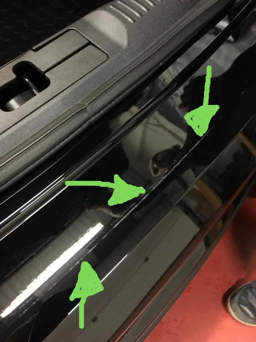

Having had a dirty car for the last couple of weeks, I hadn't really noticed this,
Well, I noticed a 'dirty line' but just put it down to muck.
Turns out, the boot hits the bumper every time you shut it. It then springs back slightly to lock into place, so you don't notice it touching. Paint is damaged down to the primer.
If you feel on the bottom of your boot lid (the bit that would touch the bumper if you had my car!) it's a really rough and knarled up finish which doesn't help.
Has caused quite a bit of damage that will need repainting to put right. Also, the boot or boot catch will have to be re adjusted. If the boot is readjusted higher, it won't be flush with the rear panels though.
This needs doing but I'm dreading the thought of taking into the dealer. I'm bound to have a Big G level of pain, especially as they'd also be having a stab at the boot alignment.
Just thought I'd highlight this as I'm sure I won't be the last person with this issue.
Others (in the USA) must have had the same issue, but for life of me I can't find on the forums. If its an easy fix (like the bonnet latch) I wouldn't mind doing myself, to at least prevent further damage.
Just paid a fortune for a ceramic coating. I know this is not the dealers fault, but if I bite the bullet and take into the dealer, I'd expect them to pay for this to be re-done on the bumper. What do people think?

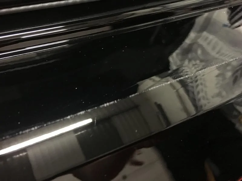

Sorry - curse of the over-zoomed in image!
Hope the image below is clearer. Basically a line of damaged paint where the bumper slams against it every time it closes. If you feel the bottom edge of the boot its about as smooth as a wood saw, which hasn't helped.

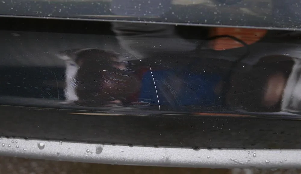

Aha, thought that's what it was.
Can't get my head around how the lid gets that close to it though? :shrug: Is that scratched line flush with the lid when it shuts?
Is that what you thought YOU were causing with your Wolverine claws?
It slams straight into the bumper, if you stand back and watch someone else shut it, you see the bumper wobble as it hits! Yes the line is flush with lid so I just assumed it was a build up of dirt where the rain drips down/collects.
Sort of, there were still (other) faint scratches from wolverine claws, but these have been pretty much polished out. I'd have put a clear boot protector on it, but its too late for that now!
Discovering the damage really put a downer on the excitement of picking up from the detailers.
Got a price for a complete covering (same stuff as on your front) of the car by the way, but pretty eye watering for whole car (well over a grand). Meant to be fantastic mind you.
