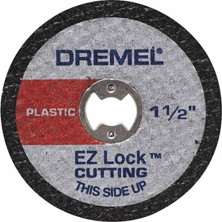

amazing work brother quick question does the trimming on the back cover bezel need to be perfect as in if i cut it straight and not diagonal like you did will it affect anything? Im using this for the cutting both bezel cover and buttons

Does not have to be perfect. Just needs to clear the new screen. I know it wasn't pretty but I used my side dykes to cut it. Just take note about where I cut mind and make sure the sides are angled cut because the screen piece is angled
