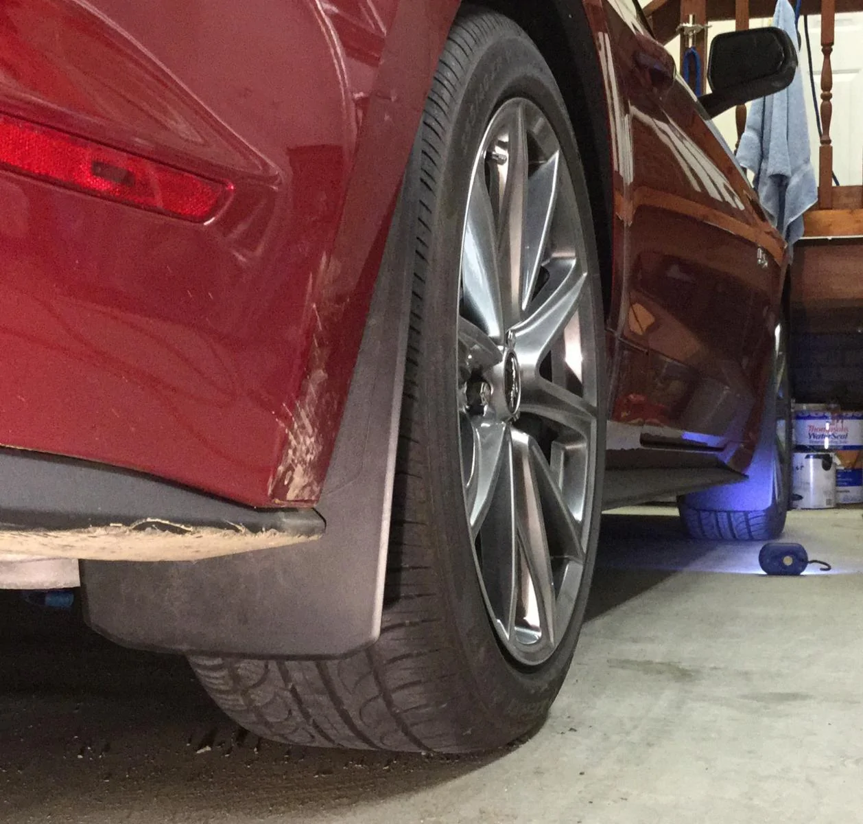

Ok, got the backs on, they came out ok but likely I will be tweaking them a bit. Also redid the fronts to move them up and out a bit. I have the MMD 19x8.5" 35mm offset wheels up front... and 20mm spacers to flush them to the fenders. Definitely needed more coverage.
So the backs I used only two bolts with nuts/washers on each side and a bit of loctite. Drilled through the fabric like liner and bolted them on:
Fronts I mirrored the OP's install, but used the black sheetmetal screws that come with the flaps to put one on each side near the top to pull them in to match the fender curve, no tape:

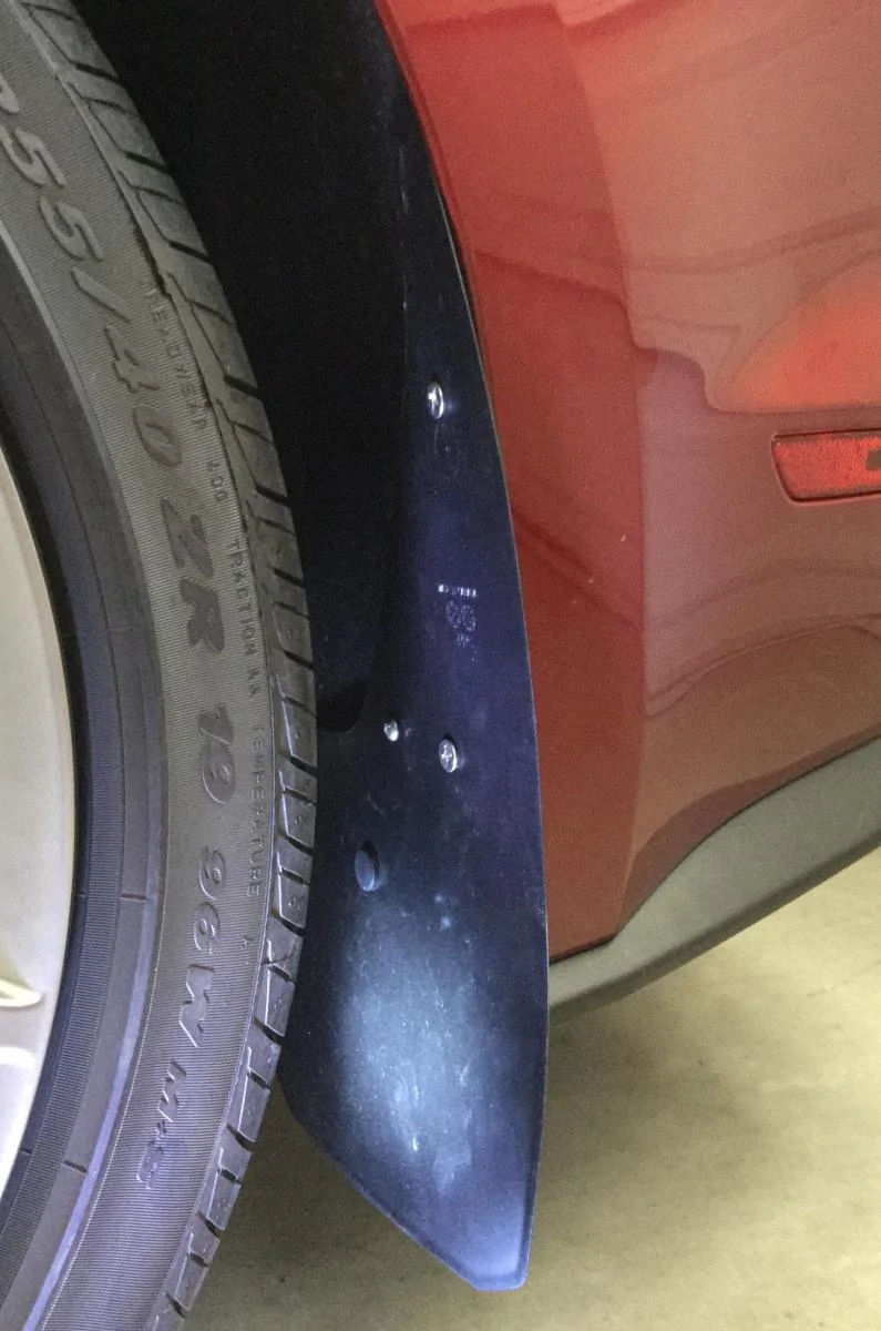

I did a very similar install today on mine. I cannot find the A size in my town so I bought B size and they are the exact width of my tires . So I modified the install plan a little bit. I used black RTV to glue thin strips of a bicycle inner tube to my fender so the guards won't rub on the paint. Also I could not find The correct fasteners so I found some 5/16 plastic drywall anchors and tapped them in the bottom two holes in front. I have to remount the fronts in further and level them and add a few spacers to level them out and paint the stainless steel screw heads and I'll be done.

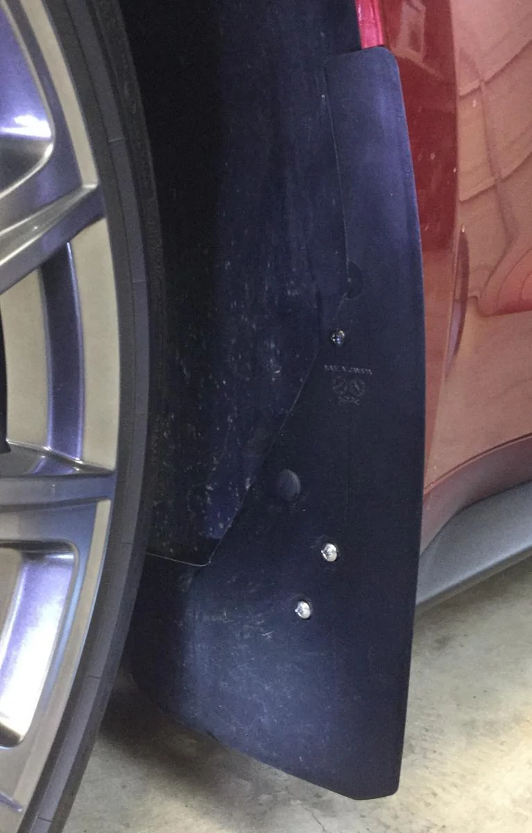

I used stainless steel nuts bolts and screws...I need to make some spacers to align the fit a little better. I had 4 inch stainless bolts,I had to cut them down to about 3.5. The 3 inch bolts were too short. If you look in the rear well, close to the rear bumper cover portion, you will see a deep valley with 2 plastic trim retainers... I removed those and used them for my bolts...so I actually went through the fender liner and done a hard mount places on a bumper cover bracket..... I also sank a screw through the splash guard, into the carpet like backing to adjust the angles of the guard....that screw can be short, like a half inch.....also reused the lower inboard trim retainer. My problem right now is I have the splash guard on the fabric liner, and the bumper cover, with the 3.5 inch screws holding the outside an top edges... That allows the top of the splash gars to slide around, without spacers, the splashgard just deforms when you tighten down too far....and yes I need to paint the screw heads too!!
I used the rears as is from the auto parts store, the fronts I trimmed down some because it was duplicating the inner liner and causing a pocket to catch mud...so I trimmed the upper and midrange inside of the guard.
