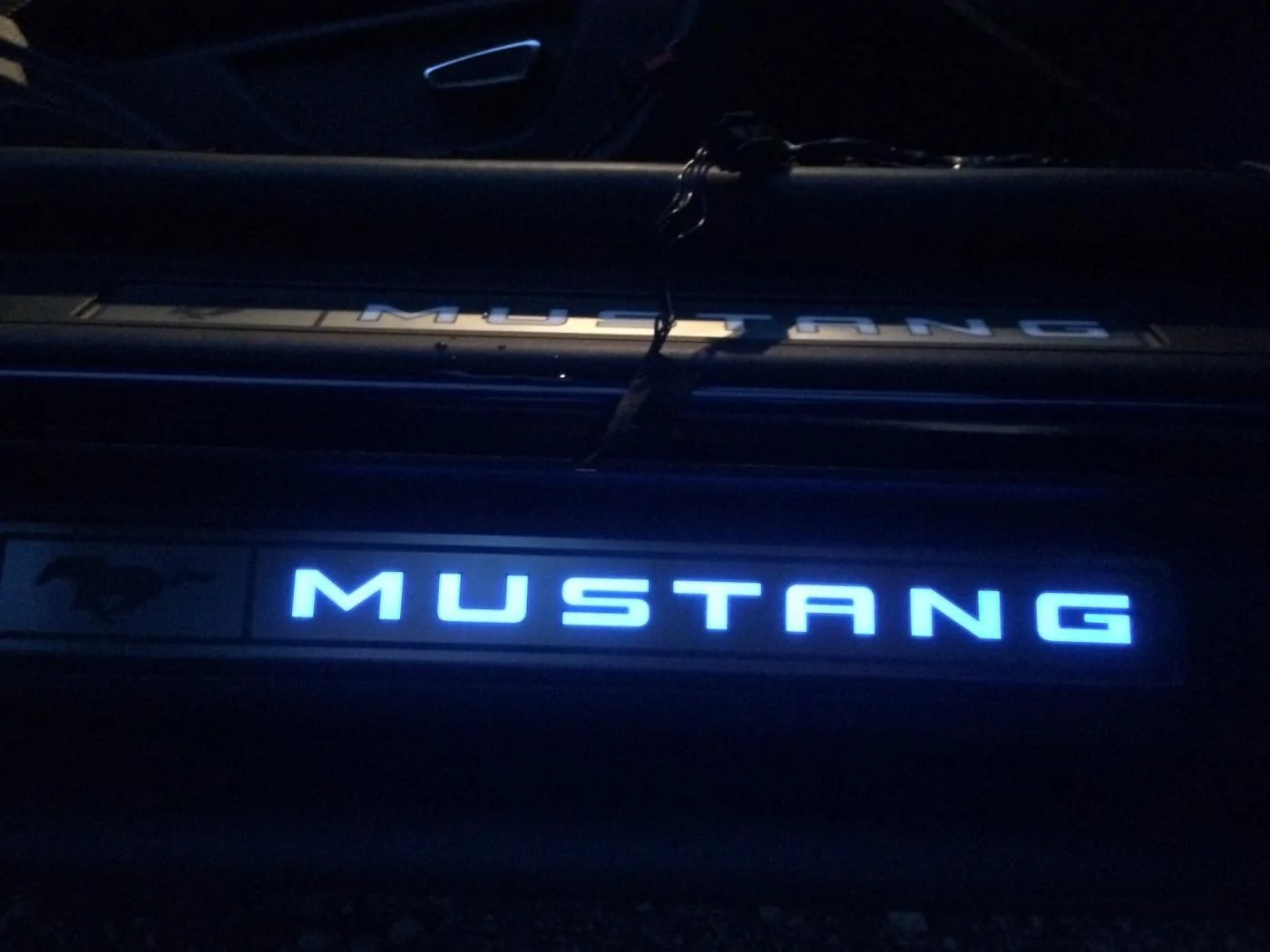

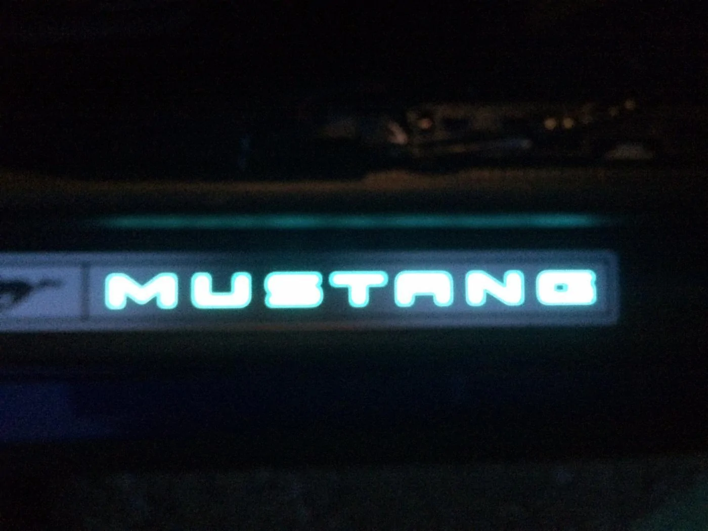

I purchased Part#: FR3Z63132A08AA, which includes the wiring harness. It is only the greenish white backlighting. The male and female plugs are reversed on the harness and the parts; I cut them off, and soldered them back on, so that the male plug is on the part. I also switched the pin-outs on the harnesses to match the ground and blue locations on the factory location plugs( the ones that have no power). I then purchased a "take-off set" off eBay, which look almost identical to the anniversary kit, except they have all 4 wires on the part, and they have the male plug. I plugged it in, and viola!, blue led door sills! I'm having problems attaching multiple pics; here's the kit wired:

Thanks Husker, I'm still looking into finding out the real part number for the multicolored set I bought, so other owners can install them if they wish. Buying the 2 sets set me back $390; it would be nice to shave some of that cost off.
