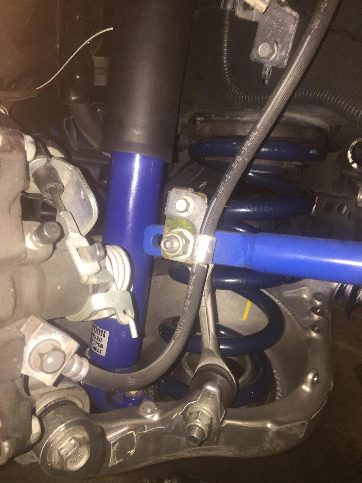

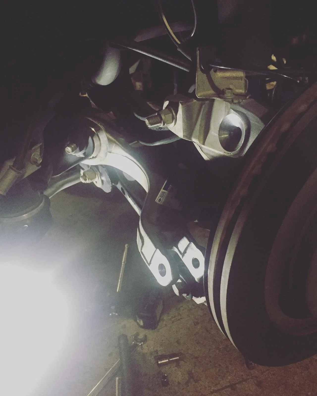

Last night I finished up the installation of new lower control arms equipped with the Steeda LCA bearing and I also upgraded the toe link bushing to the FRPP toe link bearing. I won't get into how much I hate universal ball joint presses (for the toe link bearing), but I hate universal ball joint presses!
Steeda acquired the LCAs for me and installed their bearing in Valdosta, saving me the frustration of having to find someone local to do it for me. I paid reasonable shop labor and of course for the parts, but this allowed me to take off the old LCA and put the new LCA on without leaving my car on jack stands in my HOA-controlled parking garage (which wouldn't have gone over well). I just wouldn't have the time to take the LCAs off, get the bearings pressed, and put them back on all in one day (or even the same week...). Plus I know it was done right. HUGE thanks to Steeda for this!
I'm sorry, I don't have great pictures. I'm not Bill from CJ Pony Parts!
Installation Notes:
In order to do this job, I leveraged mostly BMR's instructions for installing their LCA bearing. Steeda's instructions were more detailed and immensely helpful, but seemed to suggest lowering the IRS, which makes dealing with the LCAs easier, I figure, but isn't necessary if you have a 24mm swivel socket. Why? Some dipshit at Ford put the front, inner LCA bushing bolt facing backwards into a very tight spot. If they just made it face the other way, you could take it off from the wheel well in a jiffy. Instead, with a combination of a long 1/2" extension and a 24mm swivel socket, I got it off by fishing that assembly just under the inner half shaft joint (that goes into the differential) and over the IRS cradle. Ultimately this made the swivel almost perfectly straight, just a smidgen of "bend". I couldn't do it without the swivel, a straight socket wouldn't stay on the bolt.
The work was actually pretty fun, but time consuming. The only really frustrating part was getting the new LCAs into the inner brackets. The most efficient way for me was to get the inner mounting points close to their brackets, then push in the front inner bearing in past the bolt hole some, which lined up the rear bearing in its bracket enough. I used my rubber persuader to knock the two bearings into their home a little while feeding the bolts in (rear first), but mostly once you get them into where they have to go, you can manipulate the LCA fairly easily (just have to have the knuckle jacked up so it's not interfering).
So obviously the rear springs come out doing this. But I was able to put them back in and seat them just fine by installing the inner bolts first, putting the spring in and getting it set up, then jacking up the LCA and lowering the knuckle assembly into where it bolts to the LCA. After that bolt was torqued down (to like a billion torques...) I was able to reinstall the shock, the lower sway bar end link, toe arm, end links, and whatever else that's down there no problem. I am frankly amazed I was able to articulate my 900' 1/2" torque wrench under the car on jack stands (just two rear jack stands, I needed the car at the downward angle to have enough space).
I did have to remove my exhaust because it was getting in the way.
The Wonderful Results:
Honestly I was half expecting the addition of two spherical bearings to create noise. I have no additional NVH - just different and frankly more desirable NVH. I guess the only difference is that everything is MUCH MUCH tighter in the back, so the rear suspension feels stiffer which results in "stuff" in my car moving around a bit more. Going over bumps is a little more abrupt feeling, but it's actually preferable.
I get less "thud" and "jerk forward" when I put the car in gear. I have no idea why... but that's nice. Driving, the rear of the car now feels composed, every input of power is so much more immediate. I don't know why, but my car also doesn't seem to understeer at all anymore, as well. I cannot get a wheel to hop for the life of me and the inner wheel in a sharp turn will not skip if I gun it. The car also feels more stable, like side to side. It also appears to be the case that I have "more wheel travel downward" now. Even when jacked up the wheels will hang a bit lower. I went into a McDonalds parking lot that usually will tripod my car and it didn't tripod. The LCA bearing apparently keeps the suspension from binding, so I figure that's the reason why. And since day one my car rocked back and forth after it stopped. This has all but gone away now.
I'm really happy with the results and I think everyone should do this mod.

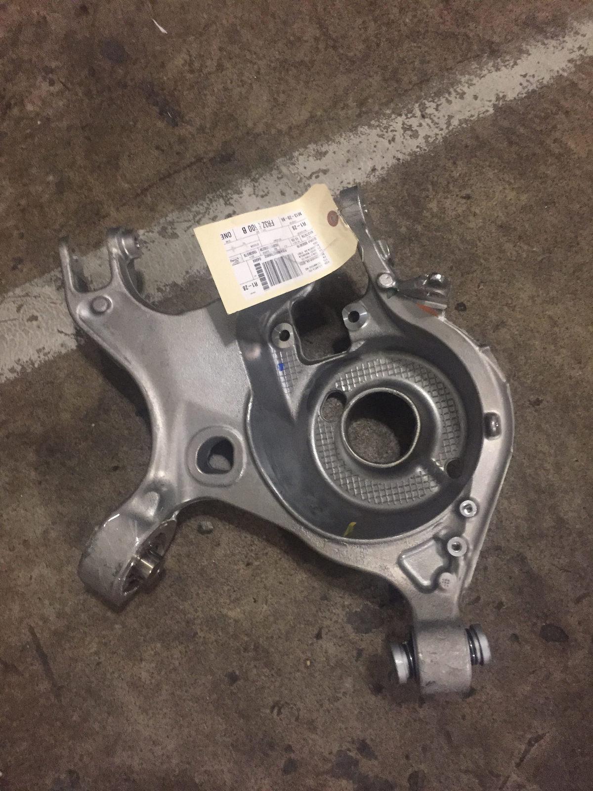

Good stuff. What are these Steeda LCAs? They look OE, no?
Edit - duh, you bought new OE arms and sent them to Steeda for bearing install.
I'm not surprised by the results as the OE LCA rubber bushings are soft in the fore/aft direction and stiff in the vertical direction. But I am concerned about feeling the bumps more abruptly. I'm interested in your feedback after a week or two of driving the car.

No Steeda got me the arms from their source (I assume like a local dealer or something) and installed the bearing. I had to ask that this get done by PM'ing [MENTION=25806]SteedaTech[/MENTION]. It's not like you can order LCAs from their website. But it was very quick and a really huge help! I'm very grateful.
