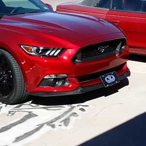

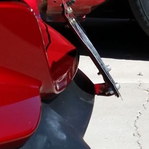

side view
REDHRSE
Feb 7, 2015

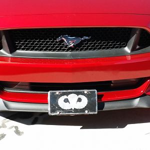

as you can see it is not touching the care. due to the strength of the steel it will not touch the body. its angled at a pleasing angle
REDHRSE
Feb 7, 2015

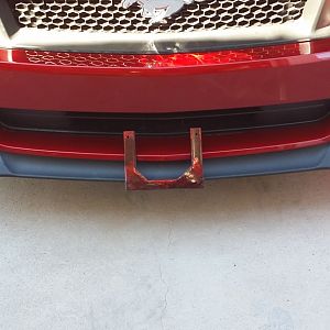

this is the bracket mounted
REDHRSE
Feb 7, 2015

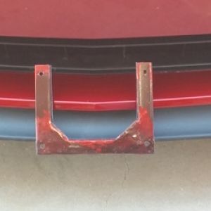

once you have grinded and smoothed all of the burs, paint the bracket. this must be done well so it does not rust. then place 3m body panel adhesive

once complete it should look like this

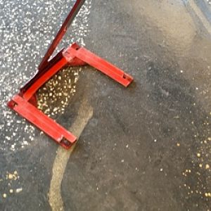

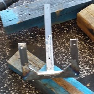

take you angled steel and evenly hammer it from 90 degrees to 45 degrees. it must be even. find the center of your angled steel and the center of your
REDHRSE
Feb 7, 2015

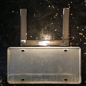

take your lic plate and vanity trim if that's your preference, place them over your bracket with a marker, mark your holes. remove the plate. with a h

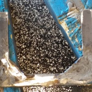

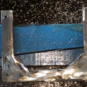

from your excess steel plate cut 2 triangular braces and weld them in. now grind both sides smooth.
REDHRSE
Feb 7, 2015

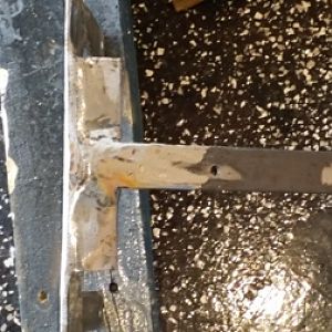

on a flat surface weld both sides of all plates then grind them smooth.

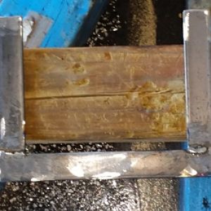

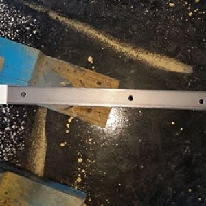

cut the bottom of the bracket at a measure of 8". then cut the sides at 5" each.
REDHRSE
Feb 7, 2015

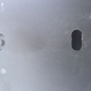

once you have the distances marked, transfer them to the flat steel bar. the bar should measure approx. 13". the distances of the holes when placed on

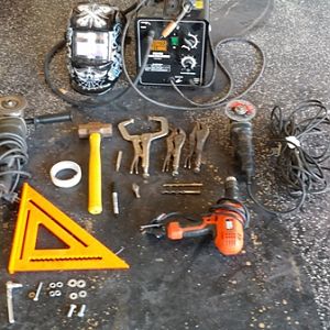

these are the tool you will need. you will also need the following materials: 36"x1"x3x16" steel flat bar 2 ea. 5/16" x1" #18 hex bolt 2 ea. 3/8" l
